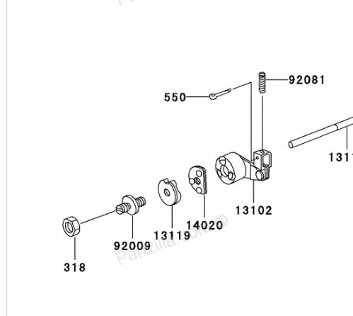

Common issue with the "easy pull" type actuators. Ball and ramp system. Open it up, put them in their places, put it back together and adjust the cable. That pop is the ball assembly going too far. No big deal. Some of clutch plates could be stuck together. If it sat for a long time, that is likely. Pull them out, oil them and put them back in. It will give you a chance to inspect them as well.

If it uses the ball and ramp you have to make sure the lever is in the correct position when you put the cover back on. If it isn't it will "pop" after using the lever a few times and you'll lose the clutch. It took me few hours to figure this out one sunny weekend and pushing my bike back to the house a block or 2 once or twice.
If you have fraying on the cable just replace it. Don't go through all that trouble then have to start over for the sake of a $20 part.

For my 750, idk if it's the same for J blocks, there's a support rib right behind the lever. It's possible to positon the lever a bit above, a bit below or a pretty much parallel to the rib. You want to put it at the parallel position.
Out of those 3 most likely positions, guess how many tries it took my to figure it out.
NOPE! 4, ok, maybe 5. I ended up in the weeds on that learning curve. :silly:

You gota go slow with me here......lever??? which end of the cable are we talking about?
I have a feeling this will all become clear tonight when I have time totake it apart.

This guy.
You'll see what I mean.
This may not have been in there correctly and someone managed to get it working by making all the screwy adjustments to the cable.
