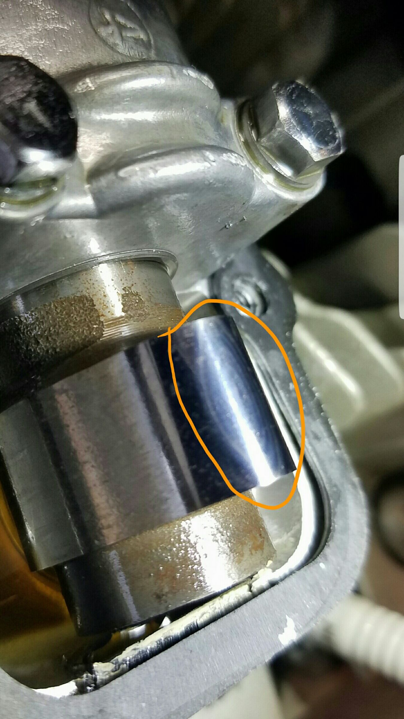

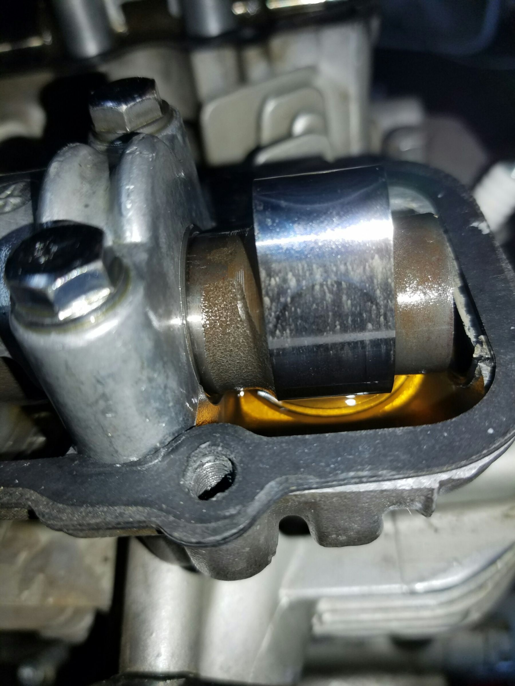

07 Sep 2016 08:39 - 07 Sep 2016 08:42Hey folks, a few hundred miles ago I started having some valve train noise, not terrible but noticable. Noise got worse at higer rpm.
After pulling the valve cover I found that the #3 and #4 exhaust cam lobe were discolored and wearing.
The intake lobes didn't look great either but not as bad as the exhaust.
The #1 and #2 cam lobes looked ok.
There was oil in all of the valve pockets, no oil pressure lights.
I pulled a line off after the oil cooler and had good flow there.
So should I start with the head stud on the right side and check flow there? Will I be ok just loosening that outside nut and looking for oil when cranking?
Any thoughts are welcome, thanks
I looked at the cams about 3500 miles ago and there was no visable wear and the noise just started about 300 miles ago.

There is a lot of reflection in your photo and I can't see the wear you are concerned about. I believe that as long as the valve pocket is filled with oil that's all that the cam needs.

Agreed, difficult to assess from the pics but doesn't look bad to me.
Did you check your valve clearances and camchain / tensioner?
Small end rattles -although unusual on these, can be difficult to distinguish from valve noise. Is it better or worse when hot ?

I assure you, there is wear and discoloration.
It's hard to capture.

I'd do a pressure test. It does look like it's wearing through the hard face on the cam. hat kind of cooler setup do you have? If restrictive it can starve the top end of oil. Big end gets oil first then the top end.
