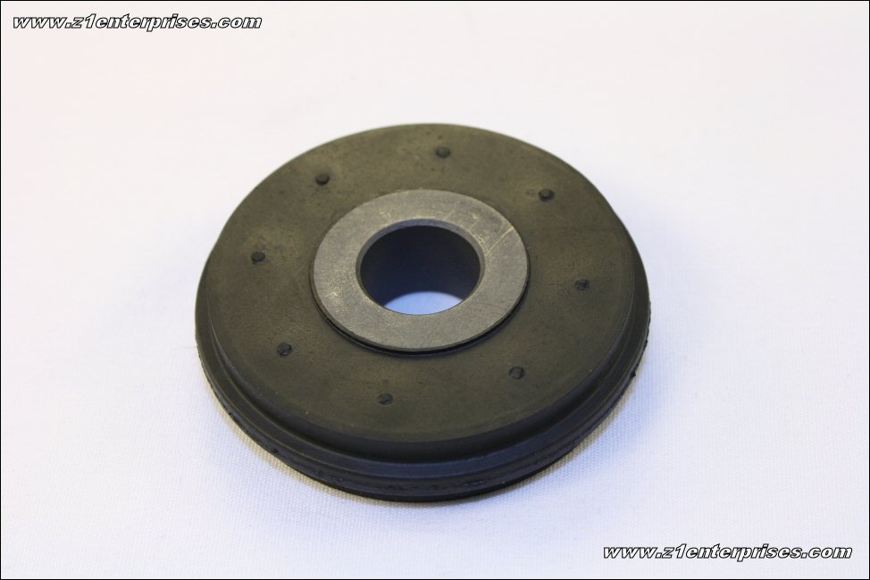

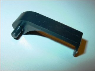

That's normal. Don't rotate the engine that way. You can buy Liska rollers for 1/2 the price of OEM at Z1E. The solid rubber roller and guide have to be OEM. They have them too. KZ Zone may have them too.

Had the same issue you are having with mine during an oil change. No permanent damage. Just installed the new front chain guide and some of the rubber bits / blocks. Rollers seemed okay on mine so I left them. Buttoned everything back up and and all was good. That was about 5,000 mile ago. Only thing to look out for is the torque specks on the cam cap bolts. The Haynes manual on some models is wrong and there have been quite a few people that have stripped one or two bolts until they realize there is a problem. I believe the factory service manual is what I went by. After taking all that caution with torque specs on the caps, I used torque values from my Haynes when installing the cam chain tensioner back on. The value was wrong and I stripped one of the bolts (actually the value was wrong in the body of the chapter, but correct in the table at the end of the chapter).

If the guide is broken, chances are the rollers are shot too. This is what I replaced mine with. I've been in there twice since 13. All I had to replace is the center rubber roller and front guide due to the aftermarket adjuster. It went into the crap bin.

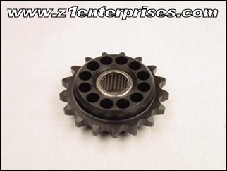

Luckily I have some spare idlers from another 1000 that are in good shape, I did order some new rollers and all of the rubber bits, along with rings and gaskets from Z1E this morning. Thanks for the help so far. I'm definitely going to see of I can scrape together a functional stock tensioner. Not about to risk having this happen again.
