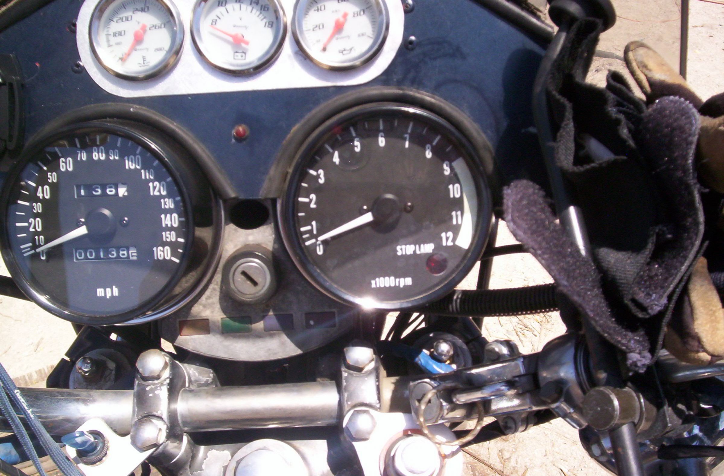

When RIDING the bike in hot weather, it doesn't seem to bother it even at 118+. Last summer I watched my head temp gauge and it got really hot when stopped but came down quickly once moving again. I bought a oil cooler from Ed and worked out how to adapt it to my bike. Last weekend I was on a dirt road moving through soft sand at a very slow speed. The cooler was very warm but not HOT. I rode two years this time around but figured a cooler would help keep it from overheating. 115-18 is coming so we'll see.

Anyone ever used one of these? Oil Temp Gauge that swaps into your fill plug. Might be the simplest mod to achieve a minimal amount of variable info..... would be interested in the temp of the heads... but this is a start.....
