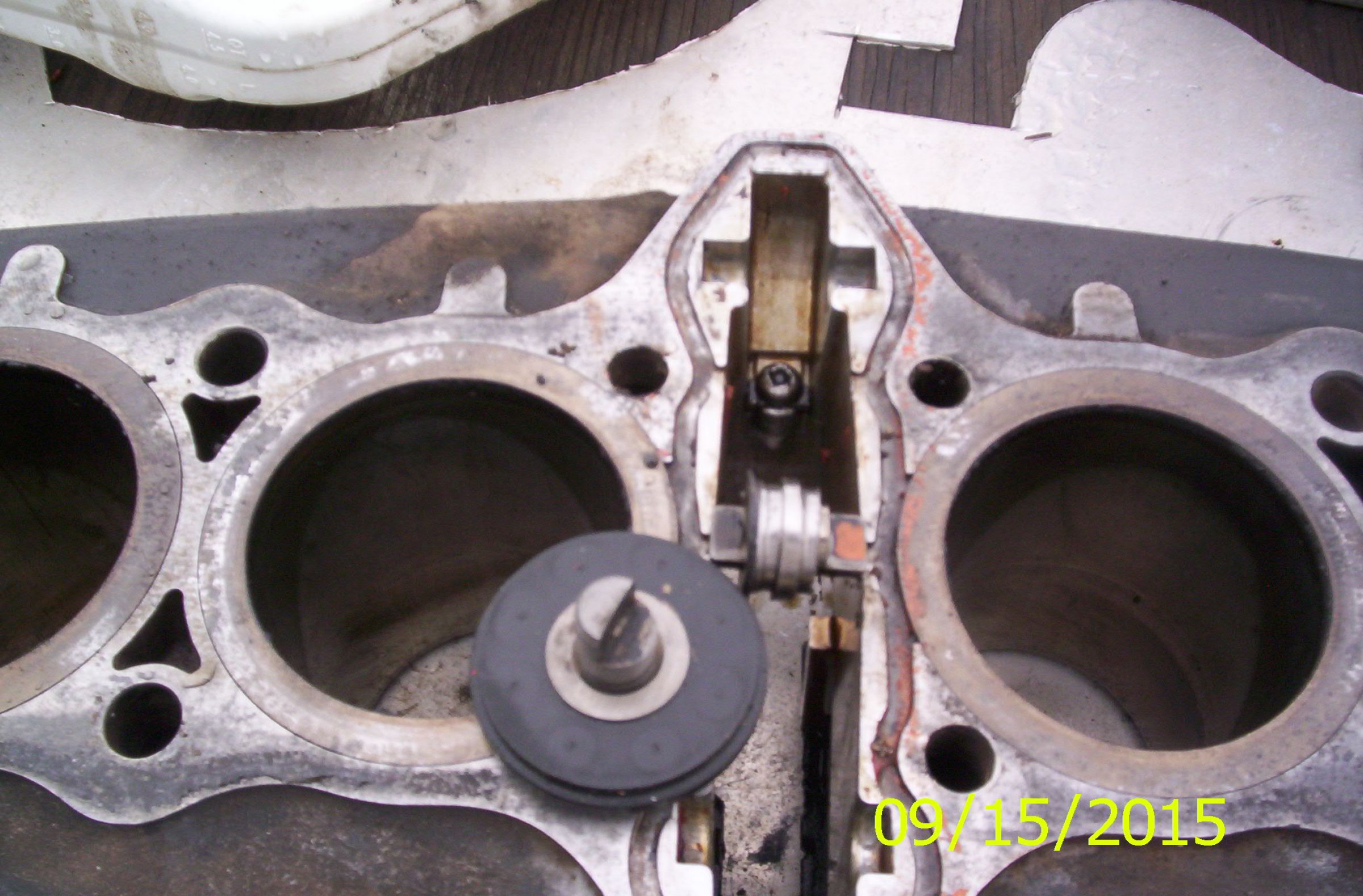

I'm just trying to figure out what I'm actually looking for in evaluating them. If they are loose on their axle? If they are very hard? Very soft? If the material is coming apart/ they feel brittle / look brittle?
Re: 80 kz650 head gasket
12 Apr 2016 10:55
The inside race has roller bearings then there is a rubber space around it. The sprocket is around that. That's what gets hard and comes apart. The rubber rollers like on the adjuster and the center idler get hard and come apart with heat and age. This was what was left of my center roller. A broken cam chain was imminent. :ohmy:

12 Apr 2016 17:32 - 12 Apr 2016 18:14Wow, that's shocking to look at. Anyway, the photo is really useful, I get it now.swest wrote: The inside race has roller bearings then there is a rubber space around it. The sprocket is around that. That's what gets hard and comes apart. The rubber rollers like on the adjuster and the center idler get hard and come apart with heat and age. This was what was left of my center roller. A broken cam chain was imminent. :ohmy:
