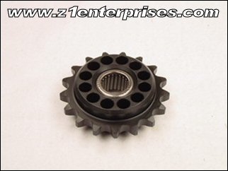

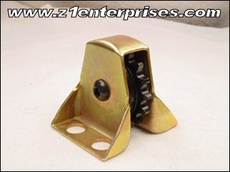

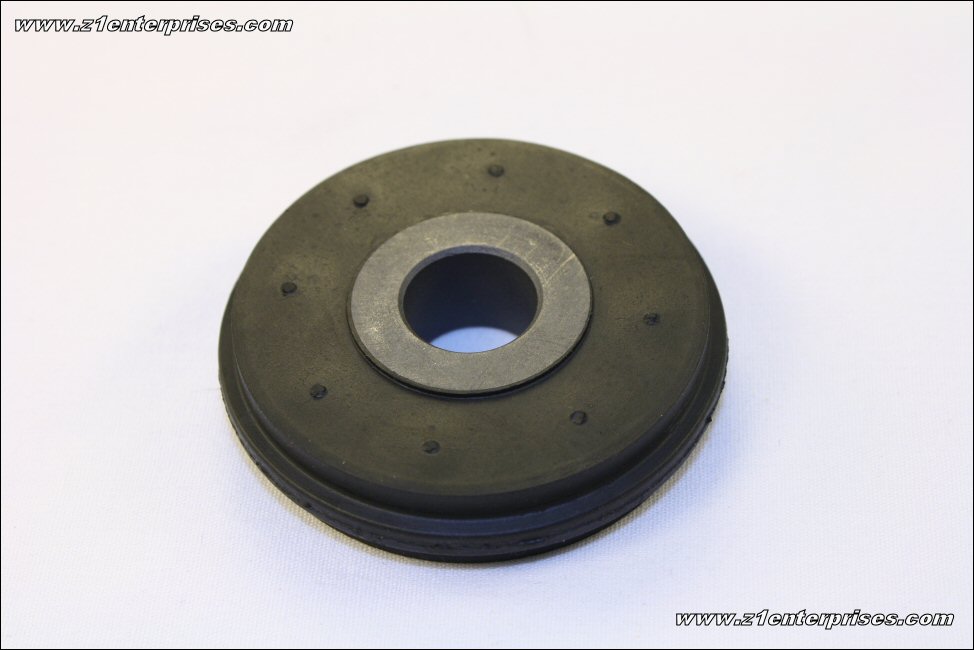

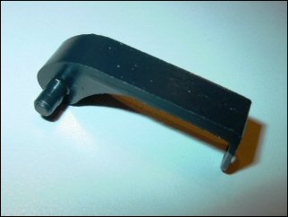

All of them. Check the idler between the cams. If the sprocket is sloppy, the rest are shot. The tensioner is rubber as well as the center one. They go first. I'd replace
#6
#17 X 2
# 19
# 20 can be done later to save money if needed. I switched sprockets in mine a long time ago from one that was still useable. The roller shaft is hollow so a #6 bolt acted in place of the rivet.
#6
#17 X 2
# 19

I wonder if Liska rollers will work on your bike. 1/2 the price of OEM and last a long time.
www.z1enterprises.com/product/LIZ1T650
I don't see any of the single rollers on that page. This is what I have.
I know it's a lot of money but I don't have to worry about it grenading between my legs.
