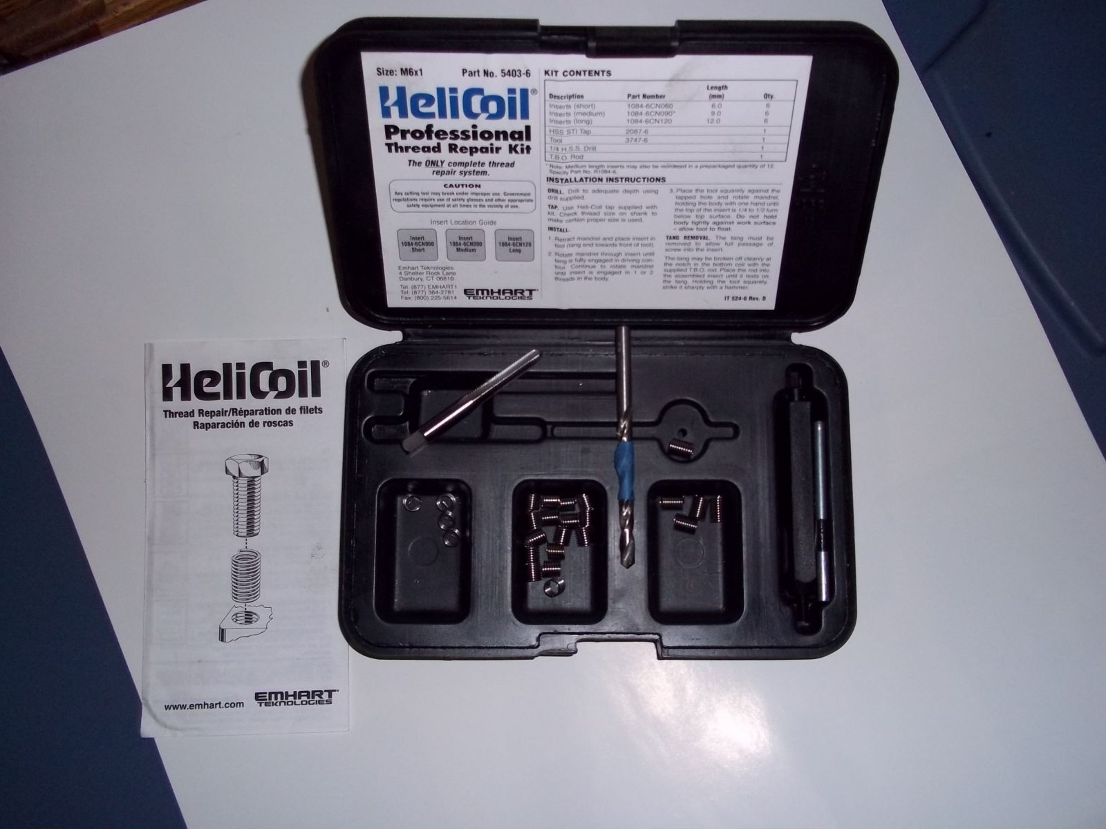

Like Steve say's. No inch lb. torque wrench! I have never owned or used one in the past 40 years! I'm 57.
And I have had heads and cams apart not 100's but 1000"s of times!
You need the REAL heli-coil kit! Not the chinese harbor freight one! You get what you pay for!
These are special decimal drill bits! And a special tap!
Plus if you do these holes over, heli-coil inserts come in different lengths. always use the longest ones, (makes sense) more to grip!

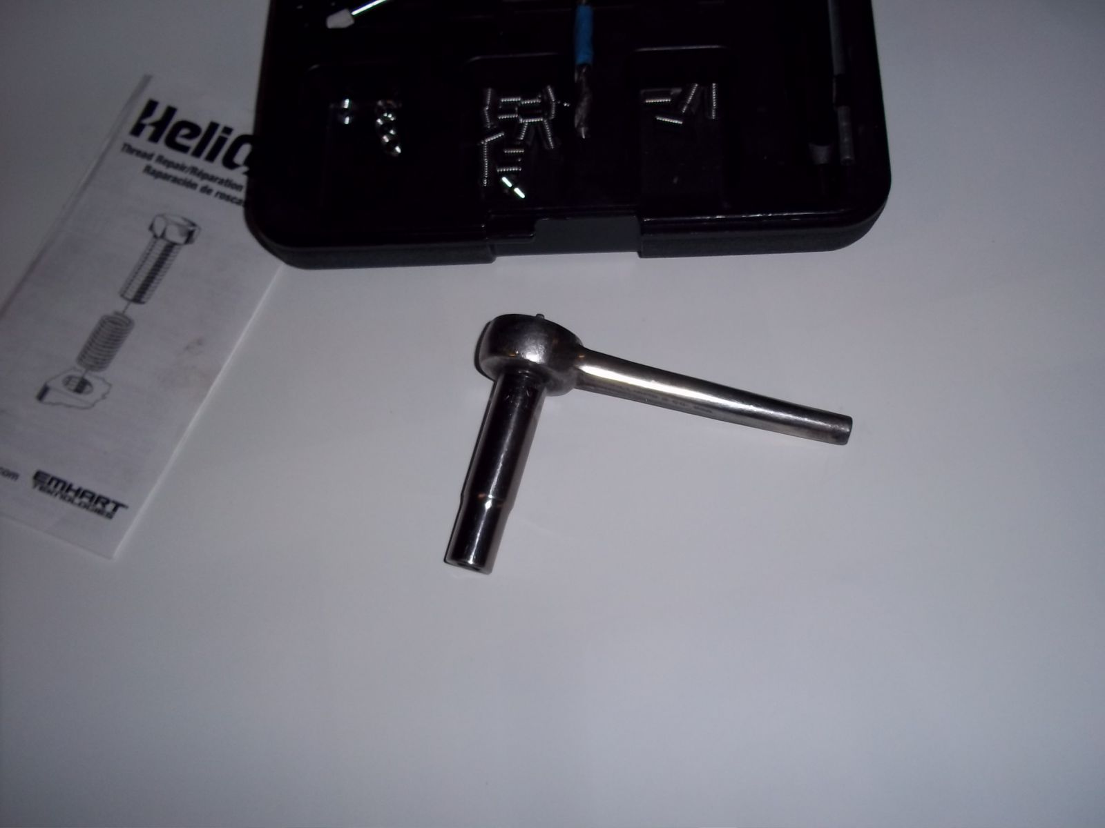

I made my hand sensitive torque wrench 40 years ago! I cut a J H Williams B-52 ratchet down to fit my palm.
As Steve says you go by feel! And experience! Here is my kit, with the blue tape on the drill for a depth gauge. Like I say use the longest inserts you can get!
Then use your hand held torque device.
Of course just my opinion from 40 years of experience!
Good Luck! Do it right the 1st time!
