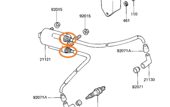

I did some diagnostic testing on the electrical system tonight. It appears I have a bad coil. Even though I have blue spark when I ground the plugs to the head and crank the engine, I was reading the FSM about how to check the coil, and it says I need infinite resistance between the lead (plug wire) and the frame (which I had), and 360-540 ohms between the leads (plug wires), which I did not have. I actually couldn't get a reading at all, I even removed the spark plug boots and stuck the tester directly in the wires and still got no reading. Anybody ever encounter anything like this before?
  • JR
  • JR's Avatar
  • Posts: 2979
  • Thanks: 495
Re: 1981 KZ440 won't start, timing problem?
22 Dec 2015 11:17 - 22 Dec 2015 11:18
#703993
Benny77 wrote: ............................................. I even removed the spark plug boots and stuck the tester directly in the wires and still got no reading. Anybody ever encounter anything like this before?
That does indeed sound like a bad coil. Just to be absolutely sure and to rule out the plug leads you could unscrew the collars (red circles in pic} which hold the leads at the coil and stick the tester probes directly into the coil prongs.
