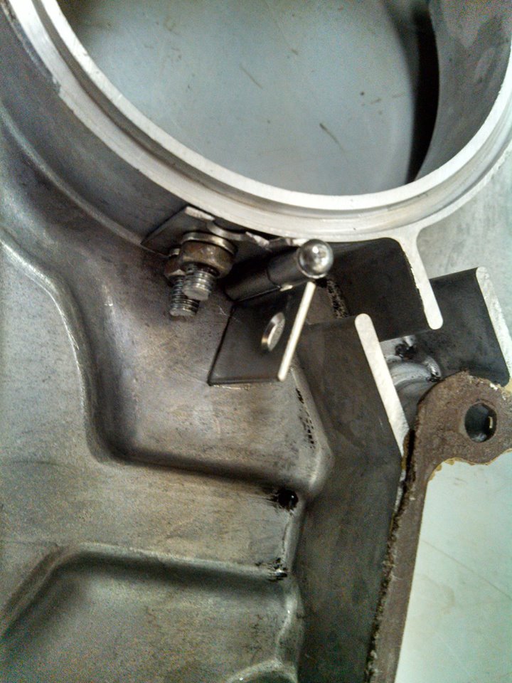

Not really spring loaded. Take a look at the link below for one. Ed

I have to drop the pan to clean out the junk so I will order it soon.

I do like the idea of that little flapper gate in the pan and for a cheap $20 part, fresh oil, filter and an oil pan gasket, I will probably make that a late fall early winter project.

Or you can make one out of a piece of a hinge. It ain't rocket science.

Re: Oil light
26 Sep 2015 10:13
It would work. I don't like the idea of drilling a hole in the bottom of the pan. I'll have to rethink this. :whistle:

Drill and attach it to the rib inside the pan, it doesn't have to fit tight, just push back slowing oil movement so that the pump pickup isn't starved. When riding local, I always keep my level to the bottom mark only (checked when on the center stand) as it seems to burn somewhat when above that. They have over 3 1/2 liters of oil in them so it should not be problematic.
