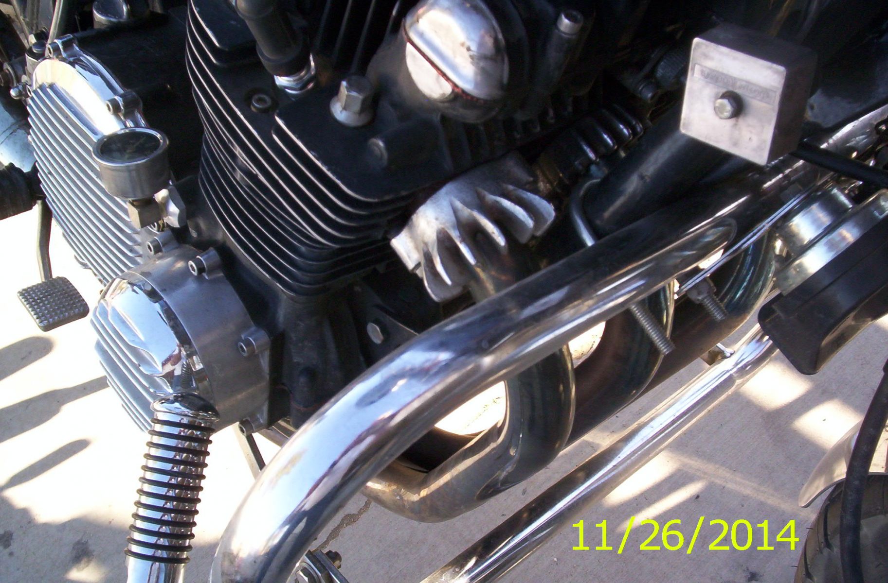

15 Sep 2015 18:29Grnole wrote: It also does not look like your flanges have not been altered either. attached are what mine look like... And when I install them... they need to be notched or else they do not fit.
I wonder why I am having issues with mine. Somewhere along the way I likely have different parts than I should.......
Those look like mine. I like them. Off a Susie. Deeper grooves.

Yes. The do look like yours. What is the "susie" model designate? Its unfortunate that they were grinded down and cut so much to fit on my bike. I don't really like when people mod good parts instead of getting the right parts. But they fit sort of. Using the 4 to 1 VH and those flanges, I really had to get some space out of my gaskets had to use the equivalent of almost 3 standard crush to get a good seal. (1 GS gasket and 1 copper crush)

I used a piece of aluminum wire to make shims to fill in some of the groove. I'll take pics this morning. I don't remember the model they came from. I'm only using the out side ones and stock in the middle. I think they look hot. :woohoo:
