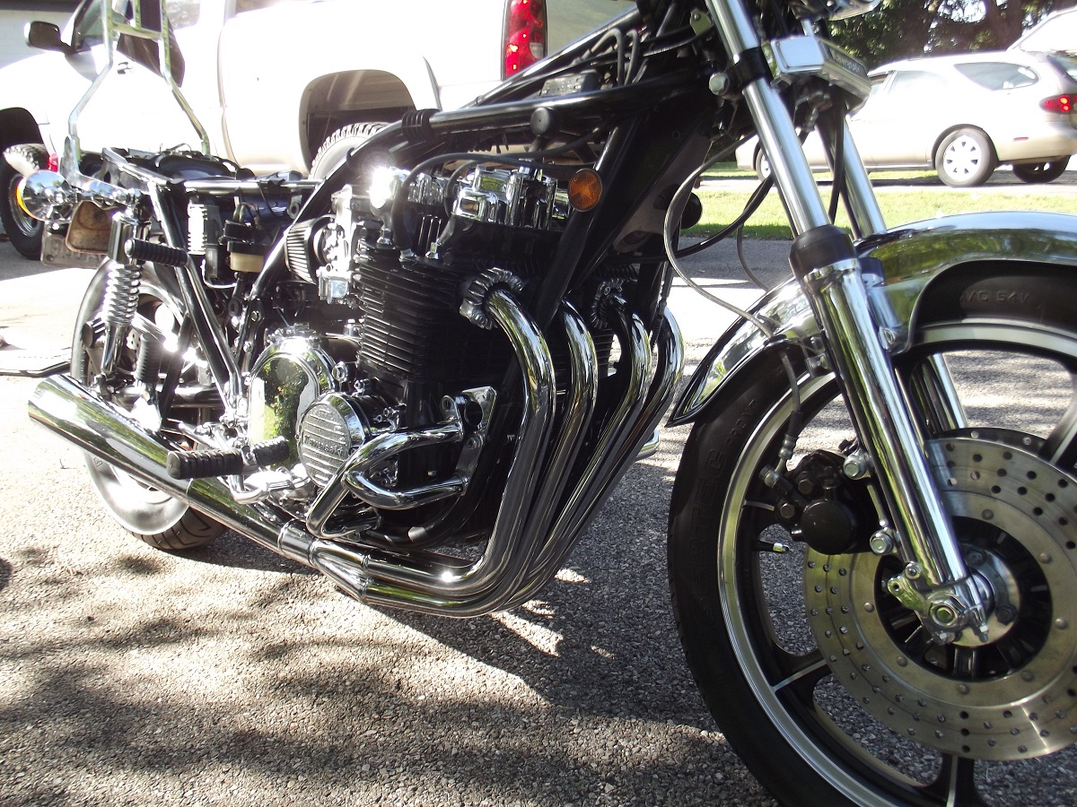

Also - my 4 to 1 looks like it has taken a beating. So I decided to wrap it. Pic below.

The fins on those exhaust flanges you showed a picture of are extremely long, & It's hard to tell from the pic's, but the base of the flanges looks to be thinner than the stock flanges, my guess would be they're from a different model bike
