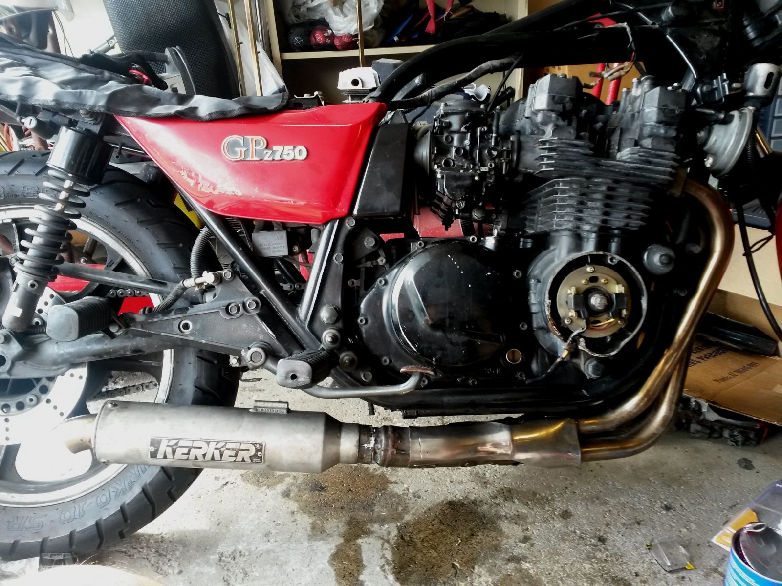

I got the set the other day. The header looks like it should fit just fine by just holding it up to the bike. The muffler looks like it wasn't actually ever fit to this collector or not very well.
It shouldn't be a huge chore to get everything mounted nicely. The only things I think I'll need something to act as a bushing between the muffler and pipe and adapt a hanger.

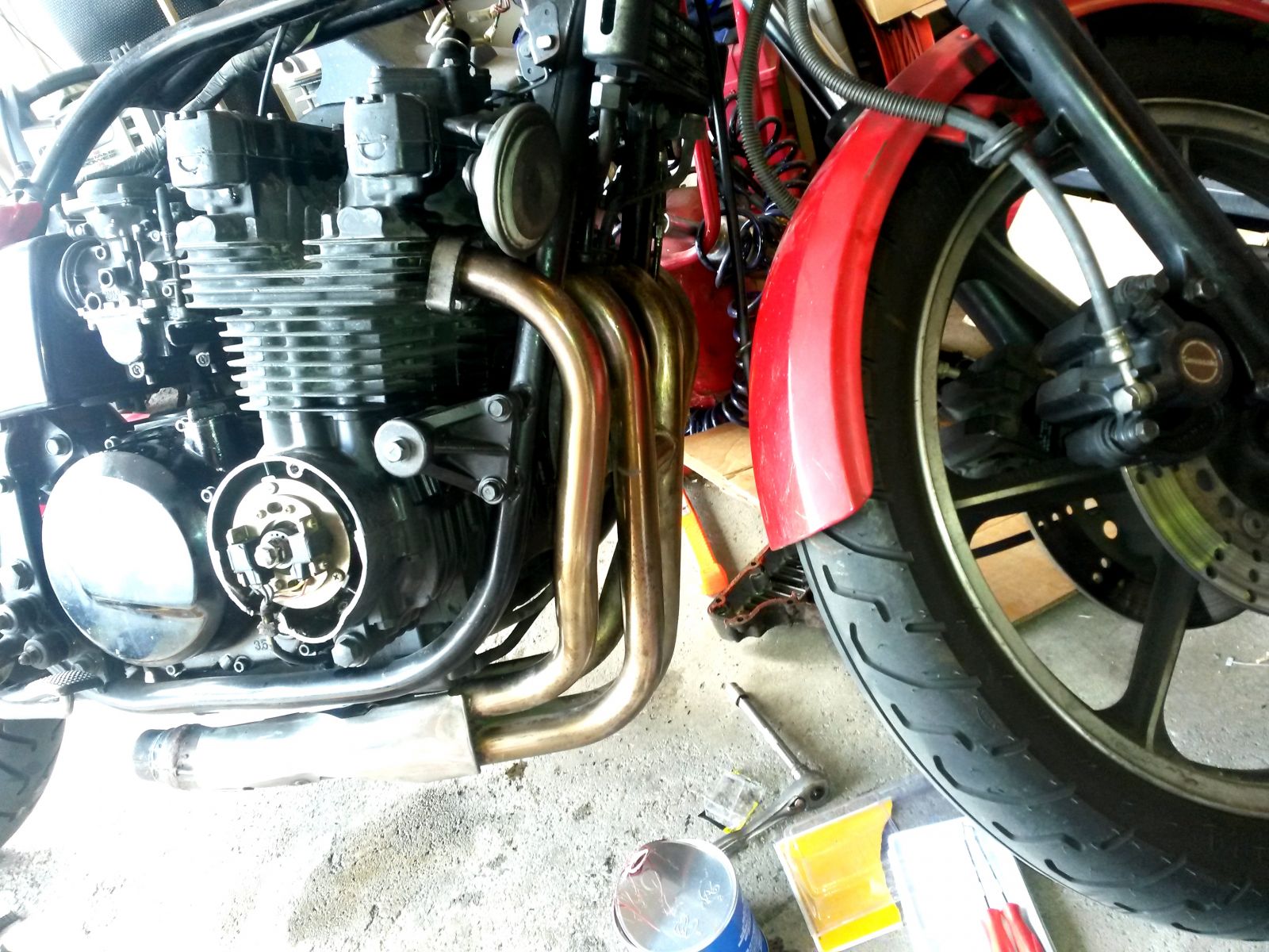

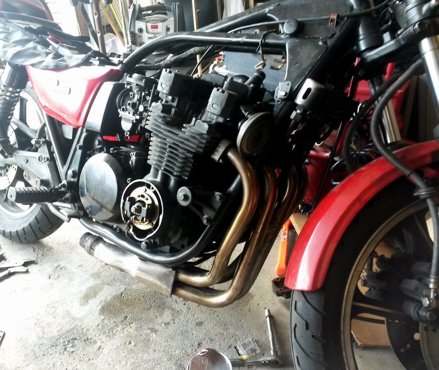

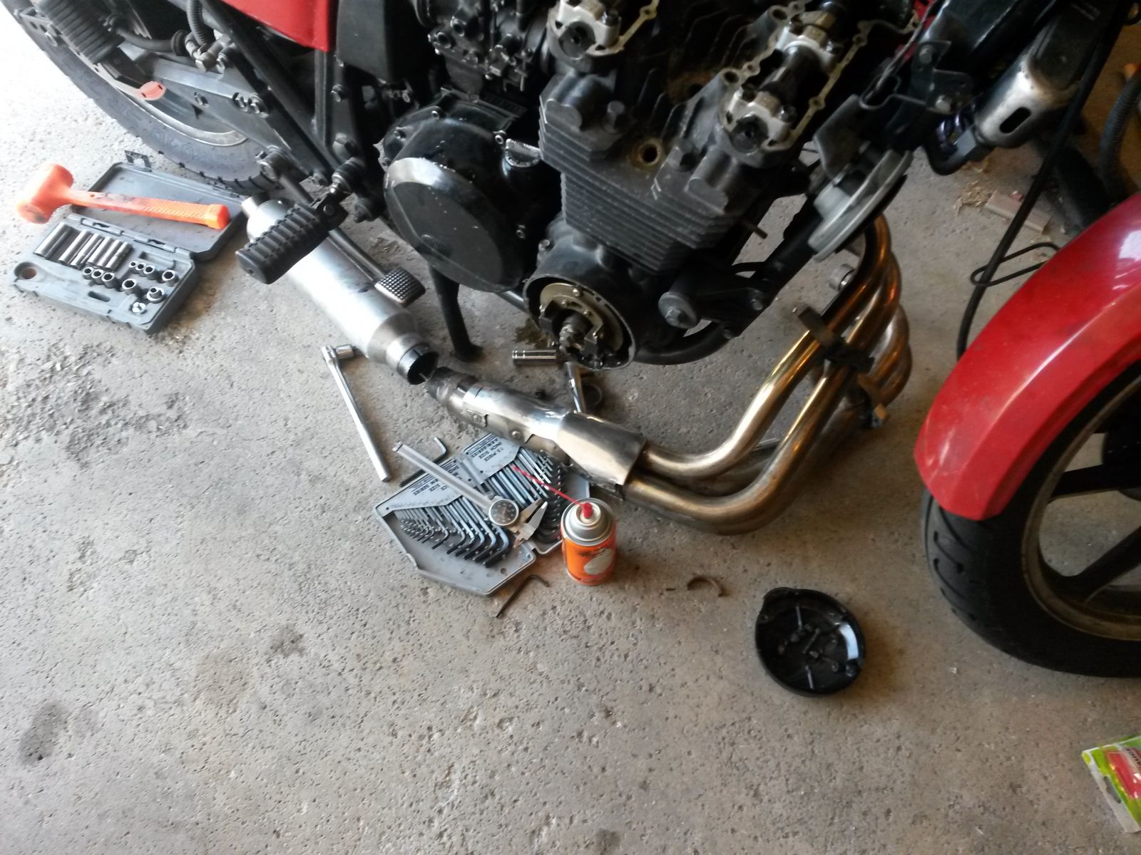

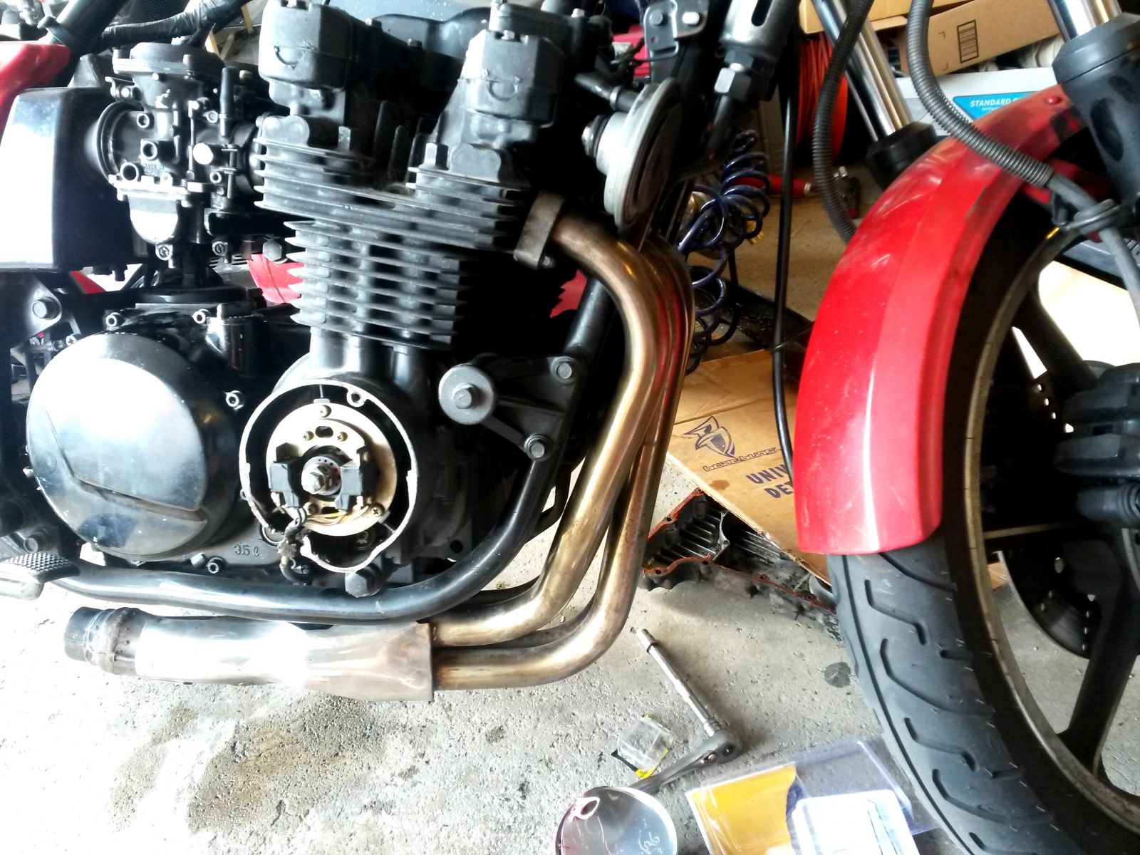

I removed the original pipes and offered up the ZR's and we have a fit. I might have to push the oil cooler tubing back a hair. The T bar clamp is seized up so i have to find a alternative, something to seal up at the connection and rig up a hanger that doesn't look too ghetto.

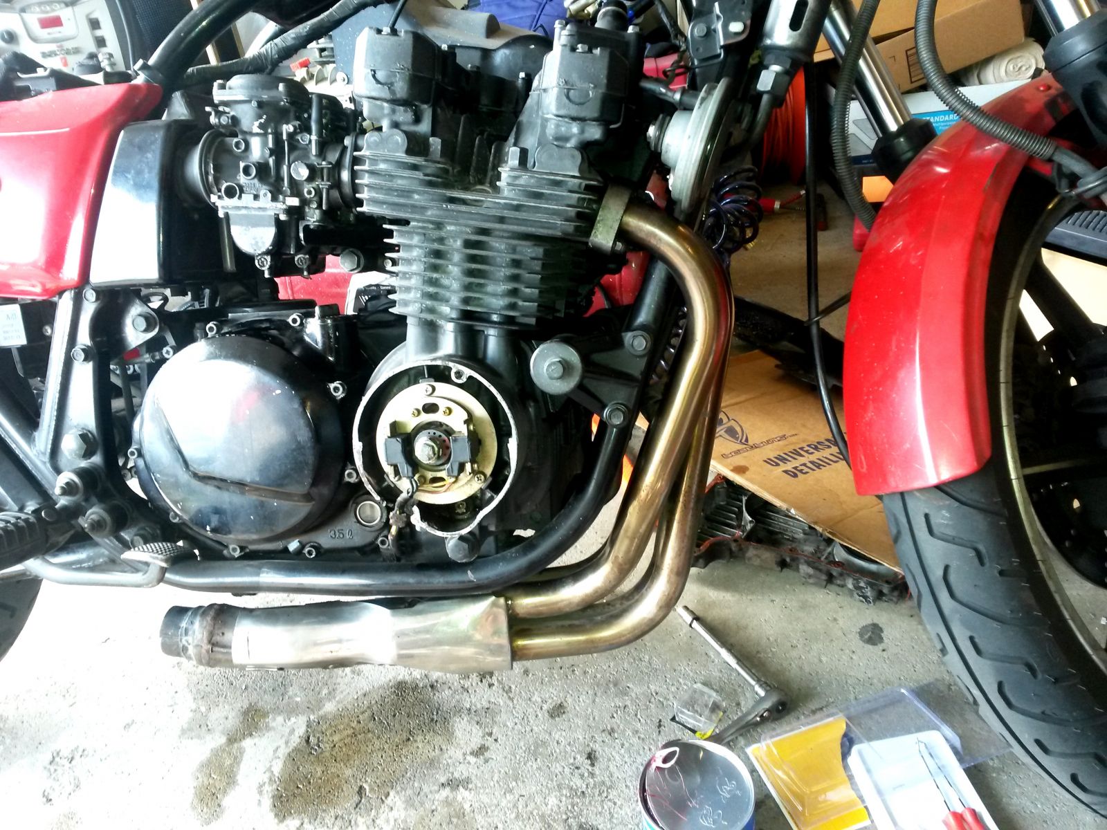

Ok I got the header on.

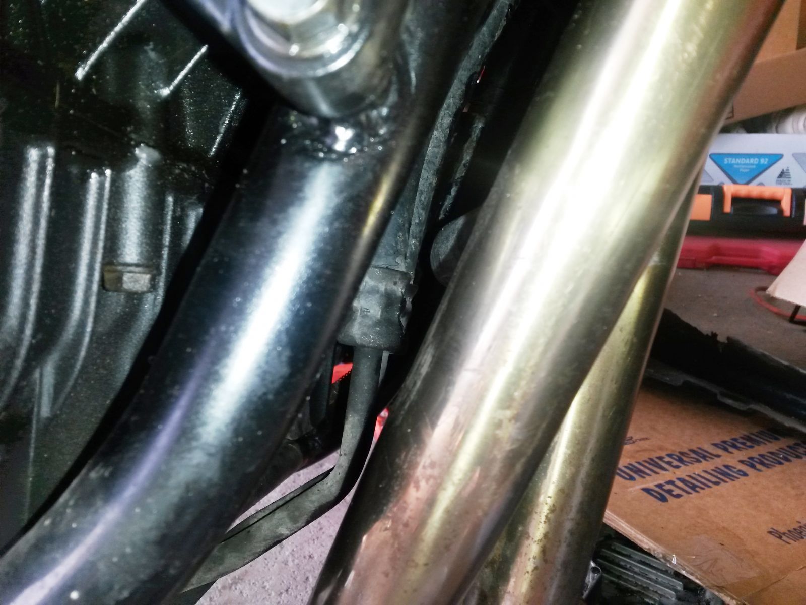

I had to push the oil cooler lines back just a bit as they were pushing right up on the crossover.
I had to take off the center stand which is something I was hoping wouldn't be the case. I guess I'll have to get a paddock stand.
I haven't found a suitable clamp yet. I was close but it wasn't quite small enough. I am using aluminum muffler repair tape as a gasket which actually seems to work well. I'll have to rig up some hangers too.

I think I've figured out hangers. The stock right hanger was cracked pretty bad. It looks like it had been repaired once but had cracked again parallel to the repair.
I swapped the left hanger to the right and it's positioned perfectly so I can run a 1/8x3/4" piece of aluminum strap with a half twist up to the Kerker mounting point.
I should be able to run another piece of strapping from the motor mount bolt just ahead of the foot peg down to the exhaust clamp.
