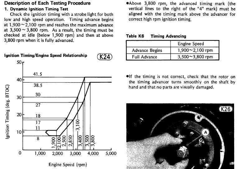

24 Jul 2015 18:36 - 24 Jul 2015 18:54anybody knows the advance on the 1013 (the original to the kz750Es)
From the manual it looks like the 750 advance goes from 10 to 40 degrees. See pic of graph and table.
I'm no expert - just a rank amtatuer - but it does seem like you have the wrong advancer, one meant for a Z1 like the guys above found
Sorry to say but any search I did for the 1013 part said no longer available so ebay might be your best bet.
Also sorry to say that I know absolutely nothing about Dyna systems and hope someone else can provide you with an answer as tio whether you need the original advancer.

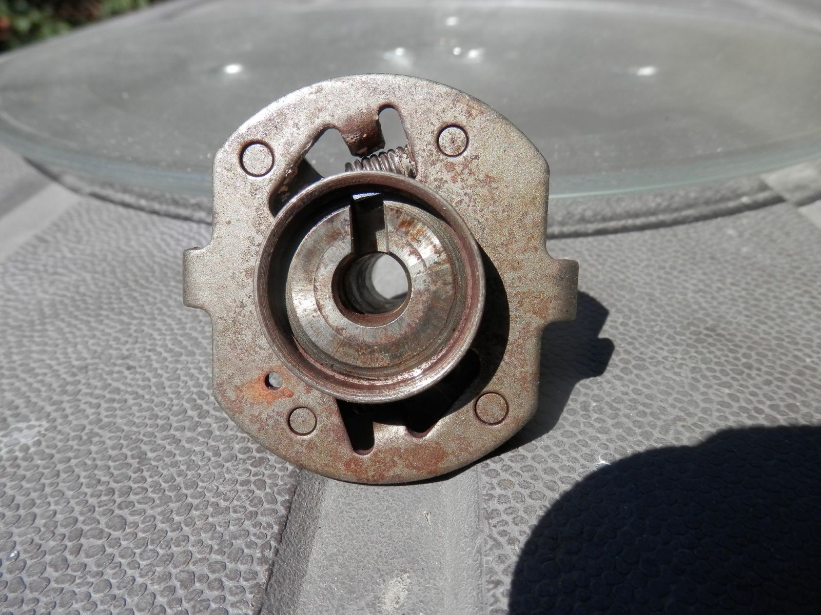

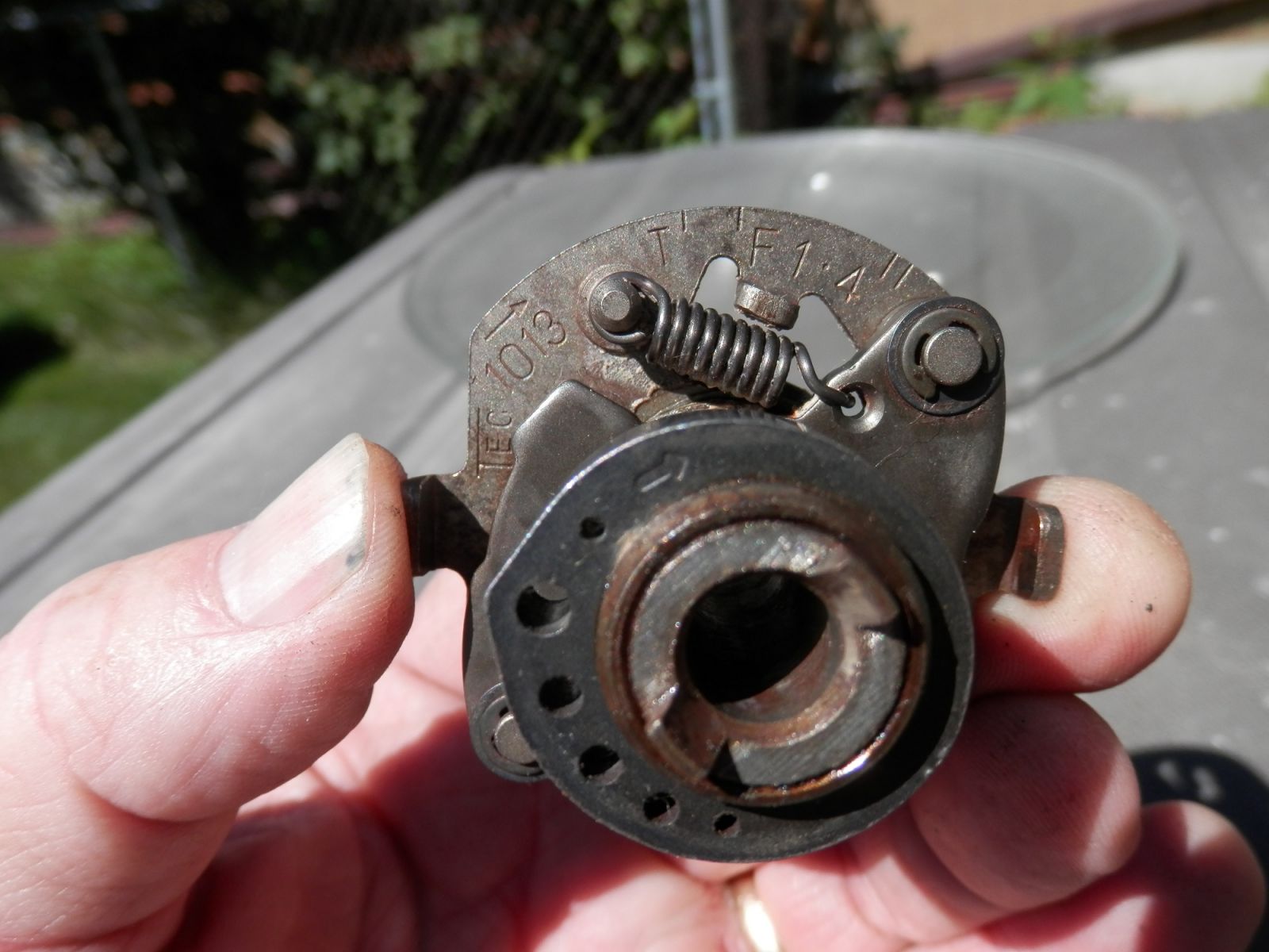

Matigipler
This will is a bit redundant as you have an advancer on order from ebay but I said I'd take photos so here ya go
The short answer is yes
when the point on the cam is at 9 o clock
then the slot on the back which fits the pin on the engine is at 12 o clock - same as yours.
Goodluck with your replacement. Hope it solves the problem
......... could anybody tell me if the tab in the back of the advancer (the one that hooks to the pin on the engine) is positioned the same as in a 1013 advanver? if thats the case my engine is deffinetly out of timing.
