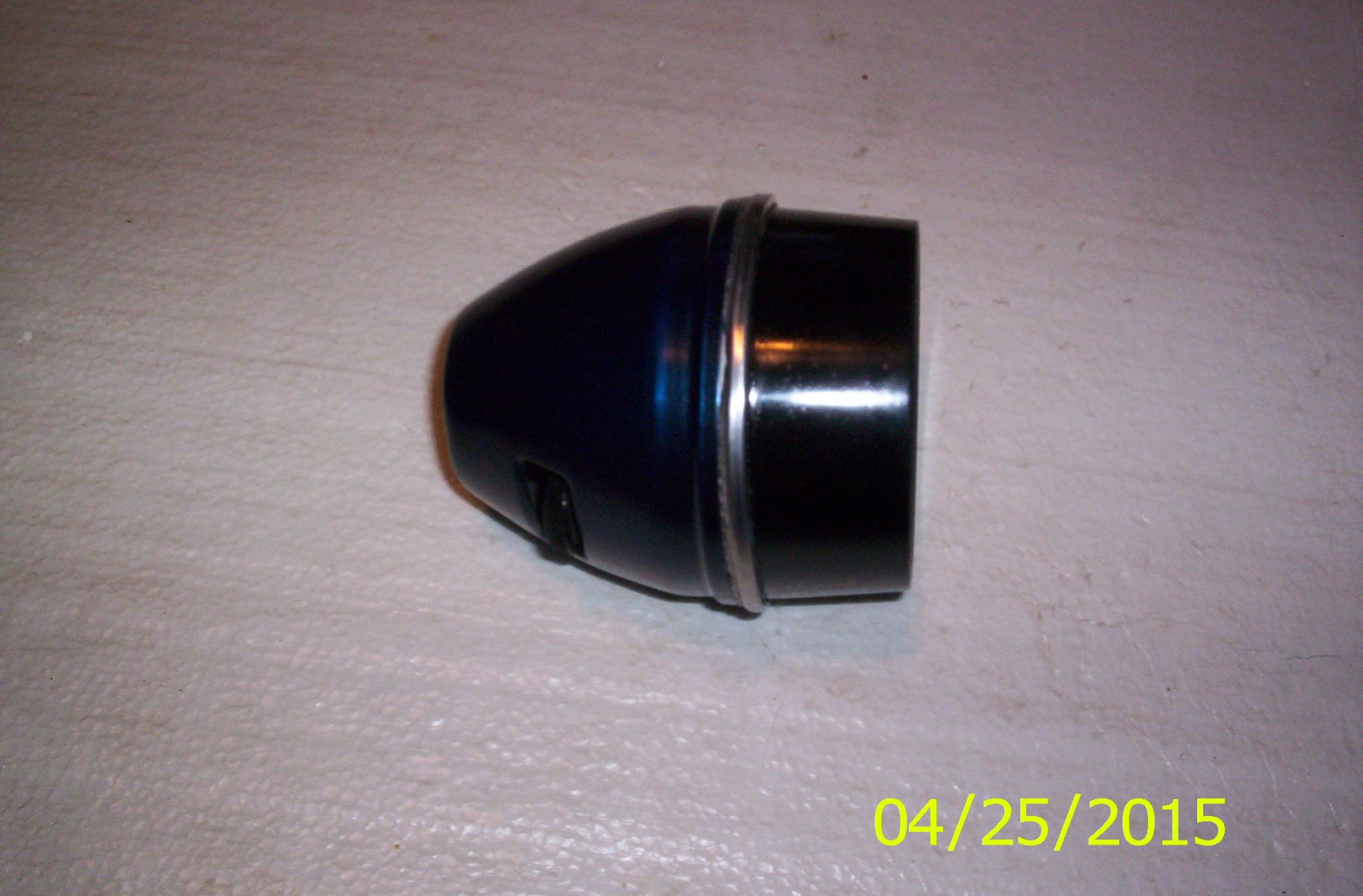

The bezel cover is already painted, the back cover is in the process. It is the same color as my bike.

Ready to go into the bike. I only crimped four places in case I have to open it again. I'll test it in the morning.

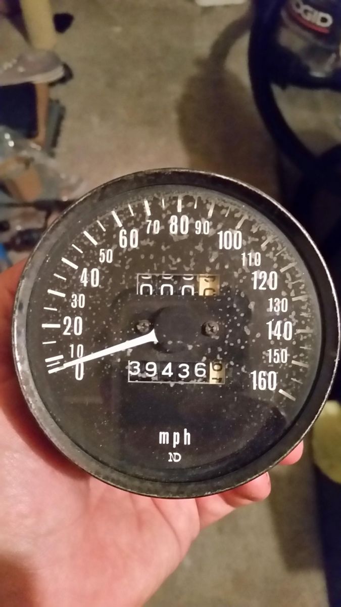

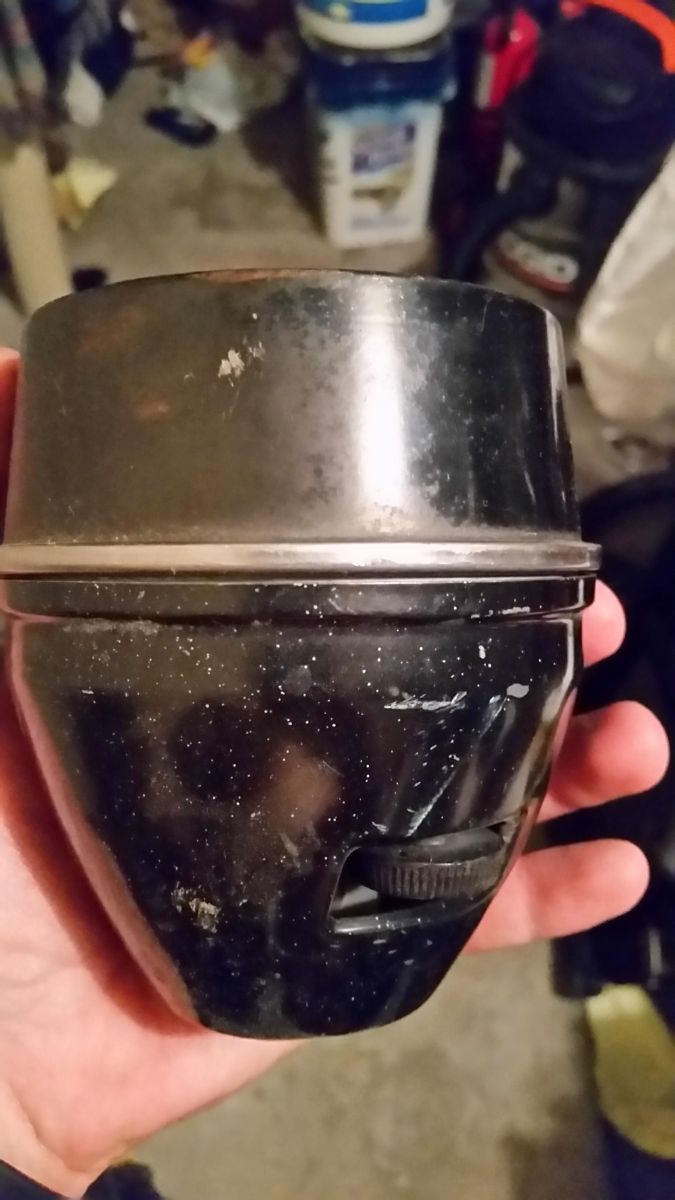

This is what I started with. Not too bad, Thanks again Jon.
