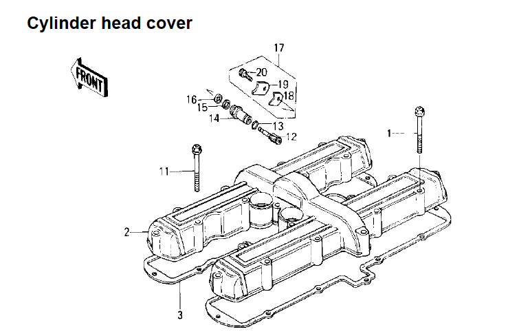

Oh ok.. I gotcha. Head cover vs cylinder head. Yeah I have no idea what the rubbery gunk is. It's clear and like silicone. I noticed it on two others as little nasty bits coming out with the bolt, but when I took the third out it came out as a sleeve. Now I'm wondering if I need to take the whole head cover off because there could be lots of crap floating around in there? Ed, you're correct those bolt heads are flanged, but I'm replacing the old nasty corroded ones with new SS allen head fasteners. So they WILL need washers?

No matter which bolt you use, you will need the copper washers. The soft copper forms the seal that prevents oil seepage under the bolt head. Are the heads of the new bolts about the same diameter as the flange on the old ones?

The SS kits are meant to be used without washers. They do suggest though, if they're too long grinding or adding washers need to be done. Some aren't exact fit. Generic sizes. I suggest laying them out along the old ones and size them up before installing. Can't strip threads that way.
