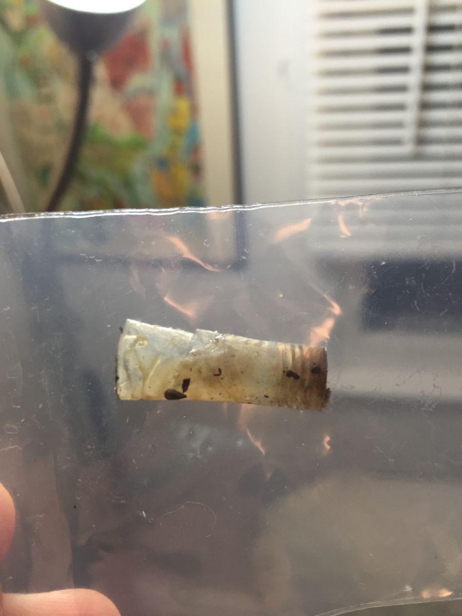

Hey guys.. what the heck is this? I got the new stainless steel bolt package from Z1 to replace all the old gnarly looking screws with nice new allen heads. I replaced a couple of the cylinder head bolts and one came out with a clear rubbery looking sleeve. I wanted to check what you guys thought this was and if I needed to add some kind of coating to these bolts. You can see in the picture that it starts at the threads and runs up the shaft about an inch in total. I've seen recommendations for using loctite blue and/or permatext high temp thread sealant. Is this correct?

Looks like they put high temp silicone under the cap nuts. I just replaced the ones on my Z1 and they have copper washers under them not silicone.

It looks like a previous owner never should have been allowed to own a wrench! It should not be there. Ed

Lol! Thanks Ed. So the correct treatment is blue loctite or is it the high temp thread sealant from Permatex which specifically states it's for head bolts?

No. You should not use anything at all on the head bolts. Take a look at the torque table in your Kawasaki Service Manual. You will notice t does not call for any sealant or thread lock. Do you have the correct washers? Ed

I think they are usually copper.

Are these the 14mm hex cap nuts we're talking about? If so, no Lock Tight, copper washers. Don't use sealent on any threads anywhere. Good way to strip or bust a case by hydro-static pressure.

Oh ok, just regular copper crush washers

OK. If you are talking about the fasteners shown as #1 and #11 in the diagram those are not head bolts. Those are cylinder head cover (valve cover) bolts. They do not use washers since they are flanged, and they do not use any sealant, thread lock, or anything else. Ed
