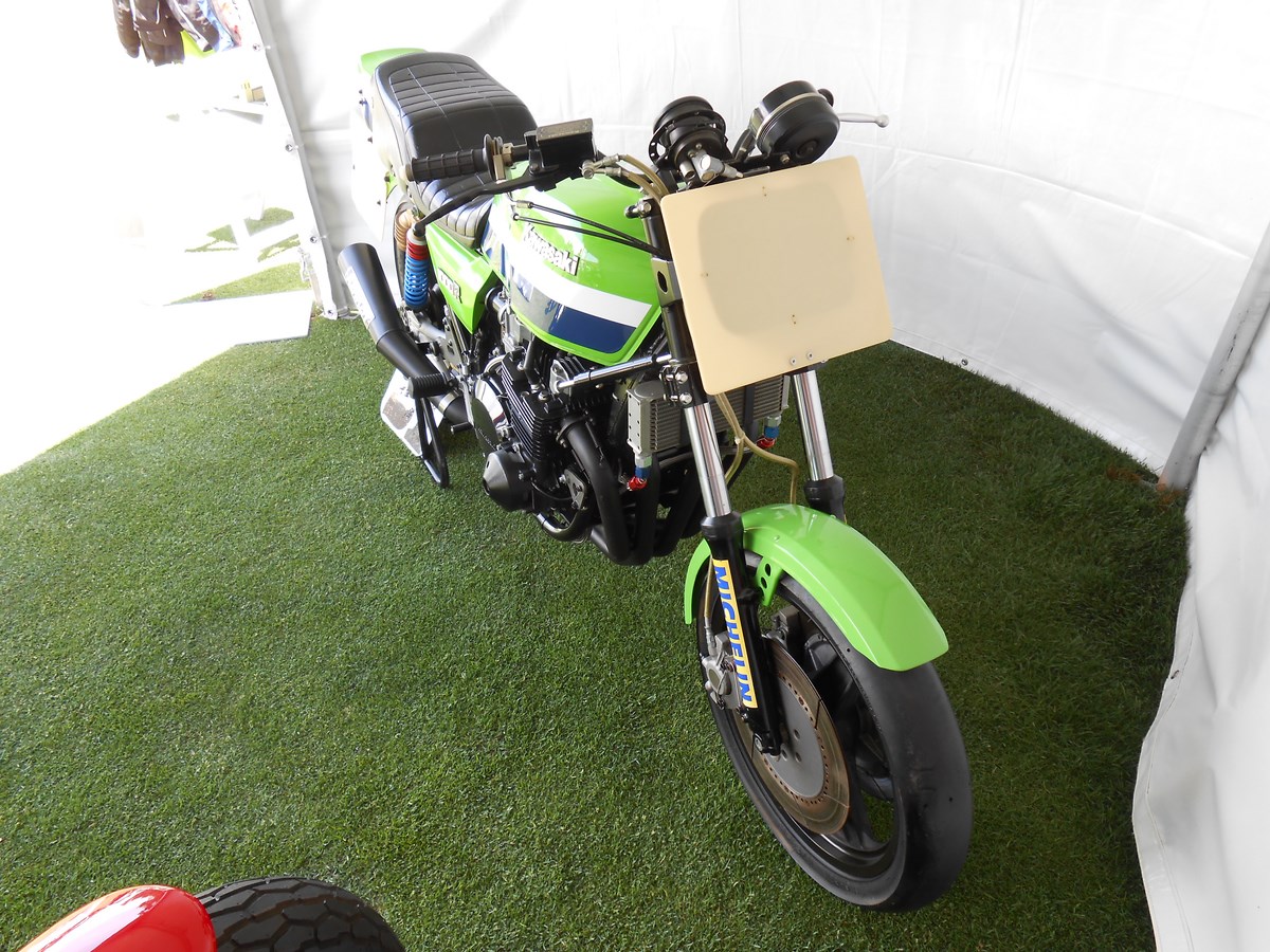

here is the bike as it rolled to stop after I bought 400 bucks in special ride tickets...Eddie led one ride on his R1 streetbike...140+ miles loop with laps of seca....And my bike fails on the way to the sign in for day ones ride....day two doug polen led a cycle world ride whcih I also had a ticket for....arghhhh..got to go to the show though
