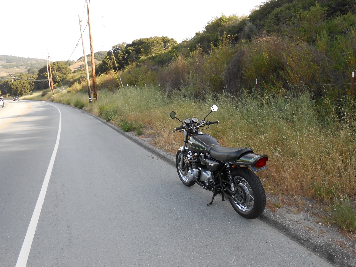

here is the bike as it rolled to stop after I bought 400 bucks in special ride tickets...Eddie led one ride on his R1 streetbike...140+ miles loop with laps of seca....And my bike fails on the way to the sign in for day ones ride....day two doug polen led a cycle world ride whcih I also had a ticket for....arghhhh..got to go to the show though

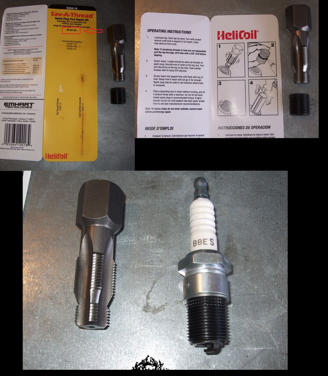

Tri.. the kit comes with 3 different length inserts, did you use the longest one...?
If not, that would mean you'd be able to re-tap with the longer one (which you should have used anyways... :whistle: )
The Heli-Coil is a time sert design so not sure this would help or not.... Same time, Larry mentioned the NAPA brand that has repaired previous bad sparky inserts.... Possibly thicker/deeper outer sert threads to bite into the head....
Worst case, pop the head off and take it to a machinist...
I used the Heli-coil on mine, no issue to date, basically same design....

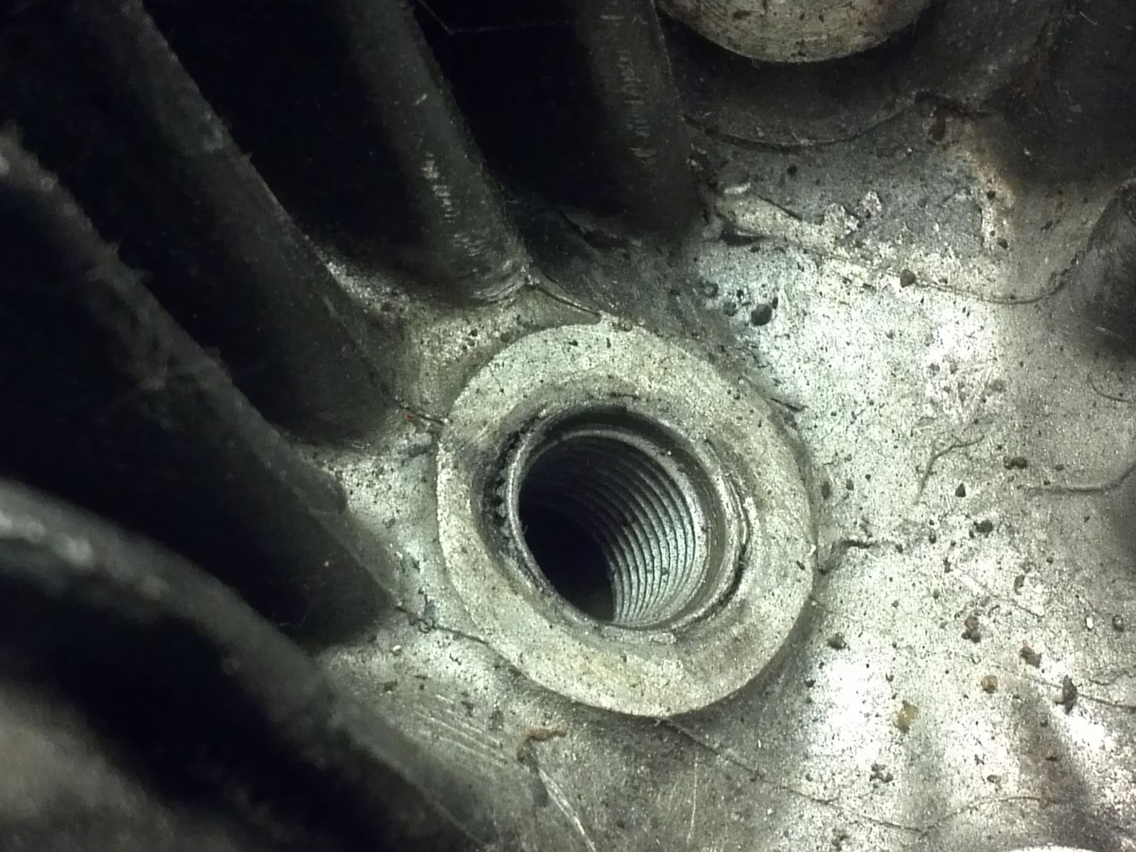

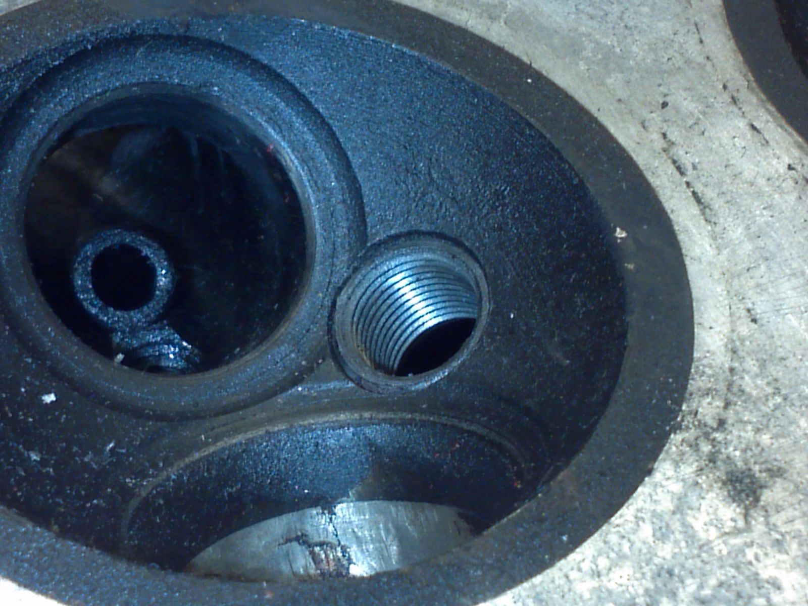

Stopped by the cycle shop and they still had the head.
I don't remember what I used. But the head mechanic/owner
said the concerts they use are what's available at the auto parts store.
Time certs tend to get a little pricey when dealing with hamfisted ATV owners.
Here are some pics of said head.
