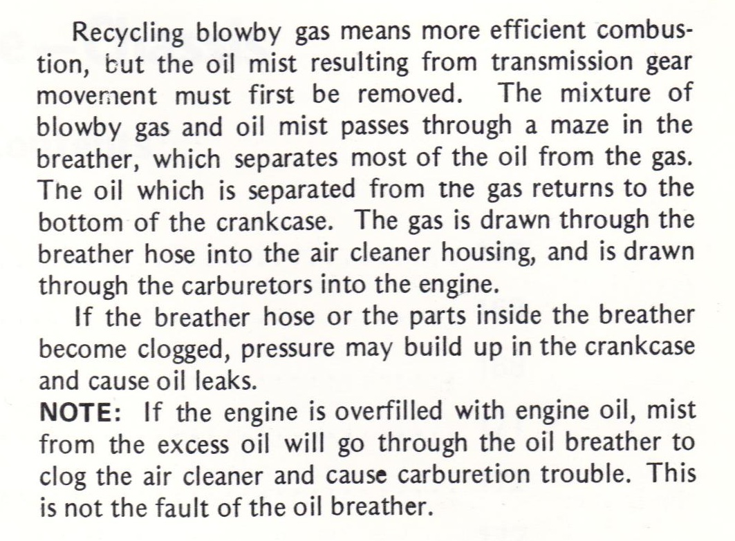

I just noticed from your photo that you have the low profile crank case vent off of a J model or GPZ .....that may be part of the oil blowing up the vent line problem as the one that you are using has no baffling at all........ like the double baffles of the earlier models kz1000/Z1........ a larger old style will fit
