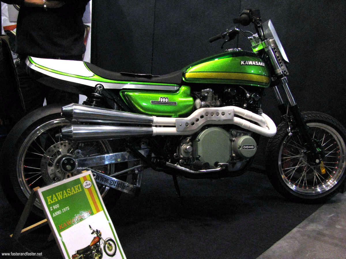

I seen these Megaphones on ebay.
I also found a seat pan.

I don't know what your fab skills are, but if you're looking for an exhaust for a tracker, you could do a lot worse than Jemco I have used their pipes on all my flattrackers as do many others. I have seen a Jemco set of high pipes on a 650 Yamaha, beautiful stuff.
Good luck with your build!

Damn, those are nice pipes!
Fab work is not a problem. I was a Millwright for 20 years and have a Curve-A-Mark and Wrap-A-Round just collecting dust.
My eyes are shot from years of welding, so I'll just mock it up and take it to be welded.

Leon,
I've seen pics of that bike before. The duck bill looks like it came from a KZ650?
I really like the bike and the exhaust is way cool, but the front wheel looks too small to me for a old school tracker.
