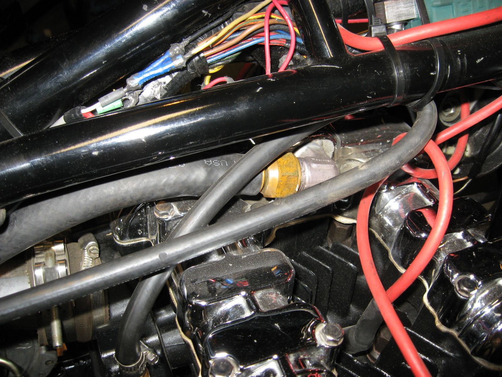

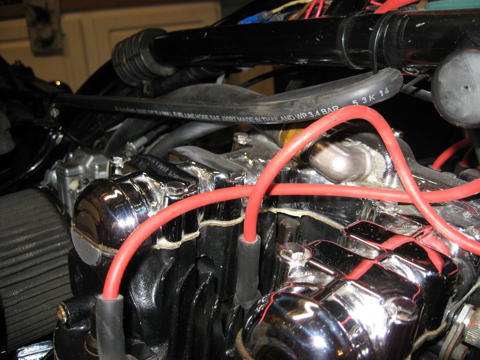

Not the best picture , but hope this helps. Welded large ID 90degree elbow to cam cover and run half inch ID hose to drive chain BEHIND the front of the rear tire. This has worked fine for 30 years. I deleted catch can when I stopped racing at the strip.

09 Nov 2013 16:20 - 09 Nov 2013 16:21I like the location of that 90. Does much oil drain out?
If I end up venting my valve cover, I was going to "T" my drain hose to the crank case vent tube and let any run over go back into the motor.
