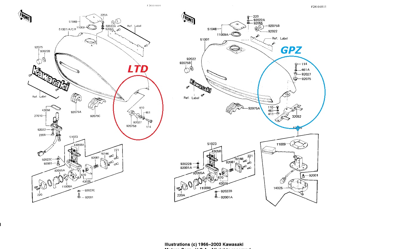

Something else you can check is the frame where the rear of the fuel tank mounts. From the diagrams the Ltd has a large plate w a bolt hole for the tank (the plate is welded to the frame). The GPz doesn't have the plate - instead there's a fuel tank bracket that can be unbolted.

Go to kawasaki.com and compare the parts diagrams for the two different 1982 750cc models.
Look at fuel tanks and frames and frame fittings.
Note the removable mount on GPZ where rear tank tab attaches with a screw heading downward.
Note the non-removable mount on LTD where rear tank tab attaches with a screw heading forward.

Someone may have bought a GPz, then had title troubles. So he got a titled Ltd frame & slapped on the GPz stuff.
