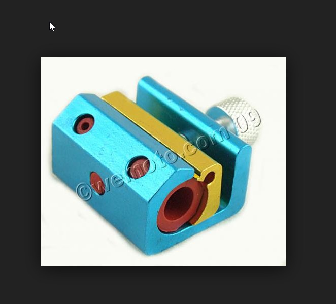

- Motor Head
- Posts: 5137
- Thanks: 393
Re: Clutch cable snapped from handle
11 Oct 2013 23:20
