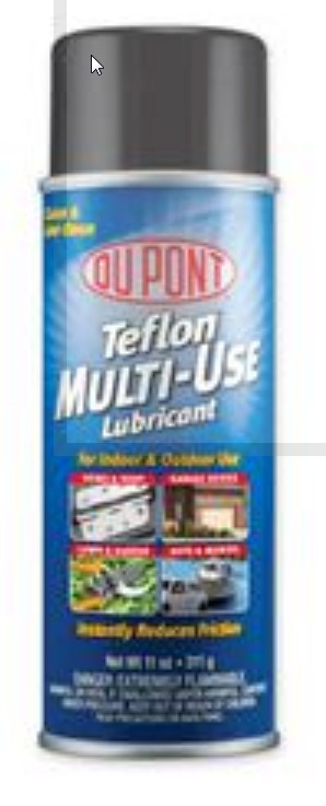

15 Sep 2013 20:08 - 15 Sep 2013 20:14I used to use a rag soaked in mineral spirits. can't harm rubber or plastic.
I am a big NON FAN of WD40. IMHO, it's useless for just about anything except driving water out of things which is actually what "WD" stands for: water displacer. It congeals to a slimy varnish over time so I don't use it.
A really good product for chains is the DuPont multi purpose spray lube with Teflon you can get at Lowes for about $6 huge can. Du Pont also makes a "dedicated" spray lube for chains, but according to the website, they are the same product just repackaged for a higher price market.
