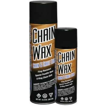

If you lube the chain about every 300 miles it will last a very long time. I like Maxima Chain Wax (see pic), but I’m sure there are other folks who each have their own favorite. PJ1 chain lube sucks. Put the bike on the center stand and spray the lube on a section of the chain. Wipe off the excess with paper towels. Rotate the tire and do the next section; etc. As you wipe off the excess lube the chain will become clean. As long as you do this on a regular basis (say 300 miles or so) there is no need to go through any other work to try to clean the chain as this method will keep the chain clean.
When installing or checking / adjusting the chain be SURE to leave the correct amount of slack in it. Consult the manual for the spec. On my KZ650 it’s about 1” of up and down movement with the bike on the center stand. A chain that is too tight will die a very early death. This is because due to the relationship between the center of the front sprocket and the swing arm pivot bolt the chain gets tighter as the rear axle moves upward. So if the chain is adjusted with insufficient slack when the bike is at rest, the chain will be stretched every time the bike is ridden, especially as the bike goes over even small bumps in the road. Ed

23 Dec 2013 17:04This is the stuff I bought already, so I'm going to go ahead and use this.650ed wrote: If you lube the chain about every 300 miles it will last a very long time. I like Maxima Chain Wax (see pic), but I’m sure there are other folks who each have their own favorite. PJ1 chain lube sucks. Put the bike on the center stand and spray the lube on a section of the chain. Wipe off the excess with paper towels. Rotate the tire and do the next section; etc. As you wipe off the excess lube the chain will become clean. As long as you do this on a regular basis (say 300 miles or so) there is no need to go through any other work to try to clean the chain as this method will keep the chain clean.
I was under the impression that the chain would get filthy dirty like it is on mine now, but from what I'm reading from you all it will keep a nice shine to it if I take care of it every 300 miles or so.
I'm going to do what martin mentioned and get a feel for the chain I have now. After a while I'll go buy a new set and get to work.
