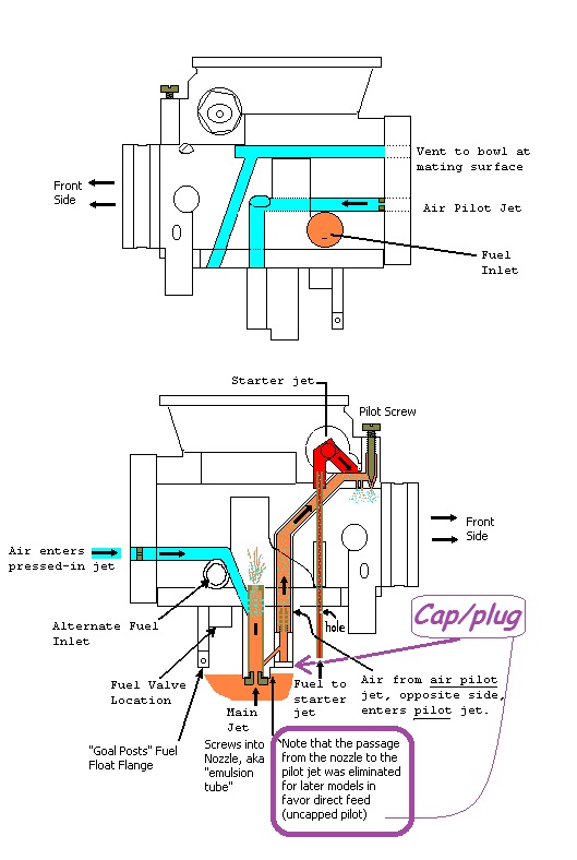

Patton - Thanks for the diagram. I've noticed you posted that on many carb related threads and I actually cleaned mine per those instructions. No dice though.

03 Dec 2012 03:34Just confirming that the pilot jet "plugs" are fitted.roman_dog wrote: ...did completely disassemble and clean the carbs, several times, but all the stock bits and pieces are there....
