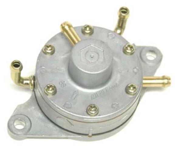

Have you got a Mikuni fuel pump laying around from a sled? Like this,
www.motorcycle-superstore.com/4/22/423/2...1&zmac=45&zmap=22375
You could positive feed your carbs and try it. Although the needle and seat would be smaller for a set of carbs with a fuel pump, it would be worth a quick try and see what happens. This is if you really think starvation is your problem, it should make sure the bowls stay at the level you have set.

14 Jul 2011 22:45 - 14 Jul 2011 22:46Have you got a Mikuni fuel pump laying around from a sled? Like this, www.motorcycle-superstore.com/4/22/423/2...ac=45&zmap=22375
That would be overkill...would induce pressure to the carb fuel intake overflow them ? (after all float needle is easy to push!)
Some people complain about the lack of power from this pump...
I went the fuel pump route. BTW the DF44-211 lacks the capacity to keep up with hard acceleration, at least on my open airbox, DJ kit, Staintune piped DR650. The DF52-73 works fine - just blocked off one of the outlet tubes.
How could connect the pump ? From the oil breather ? Would that prevent escaping the fumes or water vapor from the crankcase?

The fuel goes in and out, same as any pump. No where near the crankcase breather. Just like the petcock vacuum hose, this signal will hook to the diaphram side of the pump. If hooked to just one carb, same as the petcock, you get a pulse of vacuum. this will pump the pump. No it should not over pressure your float needles and seats, but if it was set up as a long term soulution, mikuni would recommend smaller diameter sizes for the needle vale. That is the fuel feed hole in the needle and seat assy.
Then you could also use a electric fuel pump for carb's like this Facet, www.google.com/products/catalog?q=facet+...HAw&ved=0CFcQ8wIwAA#
they are preset for 6psi.
