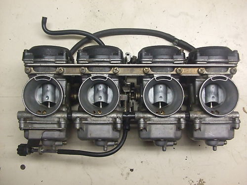

I will go in a more drastically manner... buying new rack of carbs!!!
A lot of parts locally but.... will ZX750 83-85 carbs will fit ?
Could i use a gpz 1100 EFI ... what will fit ? Also which other brand use Mikuni BS34 ? suzuki ? yamaha, honda ?
GPZ 900, lots of parts for this too!
This could give me more choice in my searches!

kzrider.com/forum/3-carburetor/232899-82...50-replacement-carbs
Can someone confirm that KZ1000-1100 have bs34 ?
Also i've read in the forum that 83-85 ZX750 have push-pull BS34 carbs ?
I just want to be sure before buying... i have only one cable (pull)
have a nice day,
laurent
They were stock carbs on most of the KZ1000 and KZ1100 bikes from 1981 on, as well as several other models.
have a nice day,
laurent

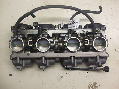

23 Jul 2011 14:46GPZ 1100 1995 .. looks like Mikuni BS36... don't know the carb spacing would be great if it could fit!
regards,
laurent
