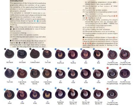

Plug "Ground Strap" seems excessively running HOT where should be 50/50 on the strap for correct temperature range of operation... I'm possibly just not seeing this correctly due to camera flash or something...
Just in case, Maybe this will help...
Reading Sparkies...
Reading Sparkies...
Attachment SparkPlugBase.JPG not found

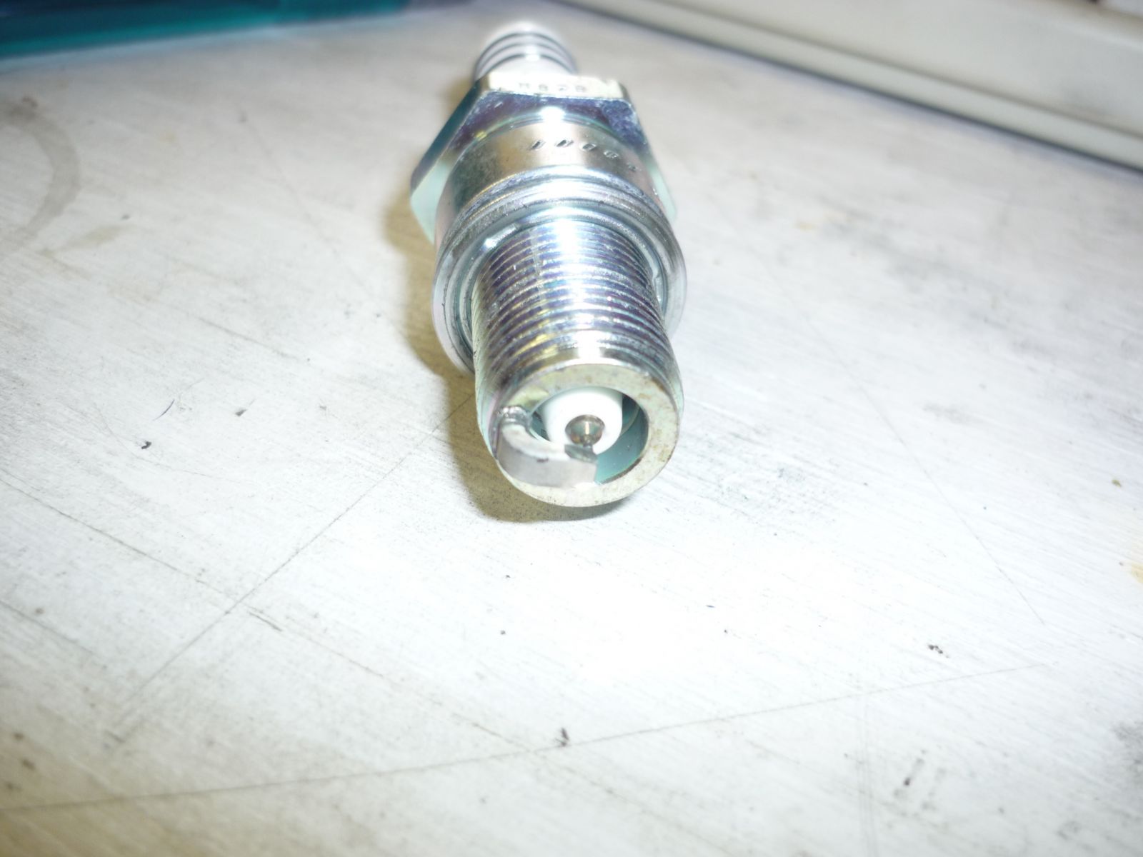

OMG !!! check this out
After 10 miles run (with new colder spark plug)... look at the spark plug looks like never had been used ! No black base ring ...still shiny wtf and white insulator!!!!!
Why would be my old spark plug ok and now waaaaaayyyy tooo lean ?

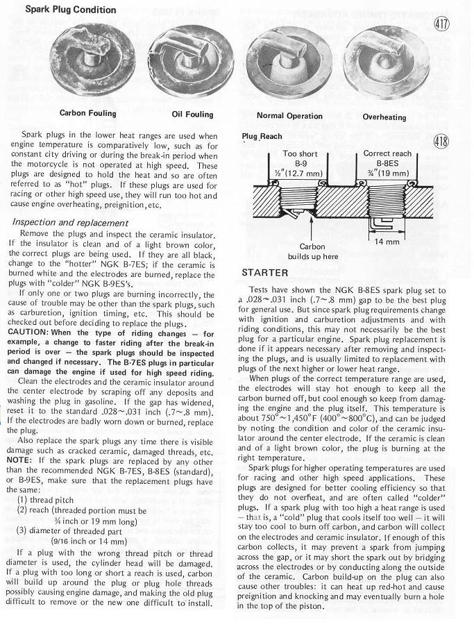

Out of KAWI Manual, says it all....
NOTE: This is for the KZ900, different then yours but concept is the same.
Confirm in your manual for specifications/recommendations...
