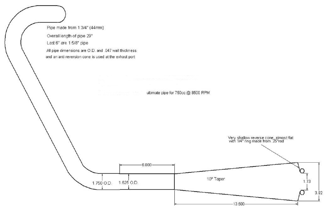

this is a pipe designed for 750cc XS650. I would assume this would be a bit large for a street bike, as it was designed for his modified race bike, but a good start.
