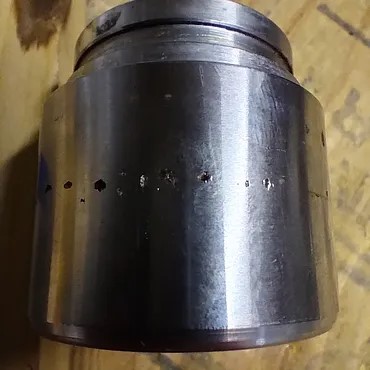

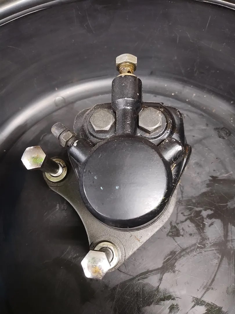

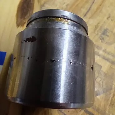

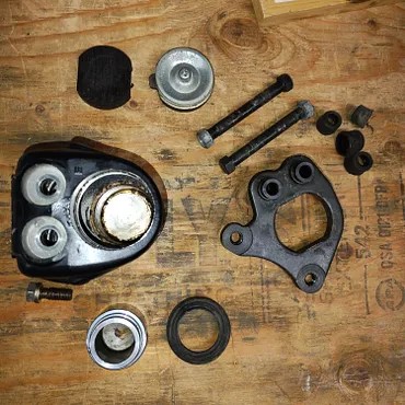

Took the front brake caliper off and apart for cleaning and new seals and dust covers.
The piston looks like it likely needs replacing.

I'd say that the piston is well and truly roached.
If that is a KZ1000B, Brakecrafters have you covered.
brakecrafters.com/collections/1978-Kawasaki-1000-LTD-KZ1000B

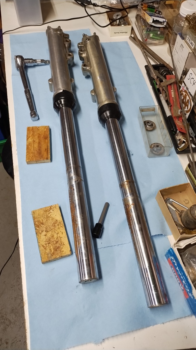

Had a go taking the front forks apart.
Managed to get the top caps and bottom Allen bolts loose, but now the bottom is just spinning.
I read, many times, about a special tool or home made version, to hold the damper inside from spinning.
What size is this "special tool"?
1978 KZ1000 A2.
I don't see a piston listed for that model at BrakeCrafters.
I recommend a broom stick. Jam it down the tube and press against the top of the damping rod to add some friction.

Crafters part # is BC4340CPSS. What they have assumed is the KZ900 1976-77 piston was the same, so it's listed as such. I ordered a couple, still have them, for a KZ900. But they are unsuitable for a KZ900 if you want to retain the 3 pieces that slip into the "cup" of piston. Sent them samples years ago thinking that they would resolve the machining but hasn't happened yet that i know of. We talk occasionally on the phone to resolve this. Steve is a cool cat and we talk about waay more then just this. Can't really tell from your photos but you should have a 43MM diameter piston. You have the "soft line" going into the caliper from the splitter which is correct for this year. But.. because ya never know what "might" have been changed, they have a 38MM piston style caliper too. They look identical from the outside but were used on the LTD 1000 with twin discs. Anyway, that first part number from Brakecrafters is pretty much equivalent to the original 43048-009 Kawasaki part.
