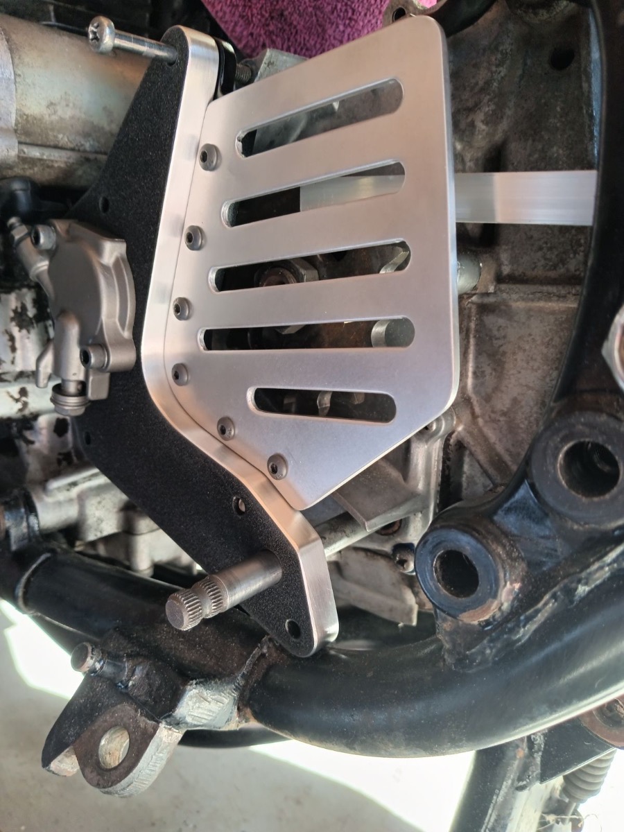

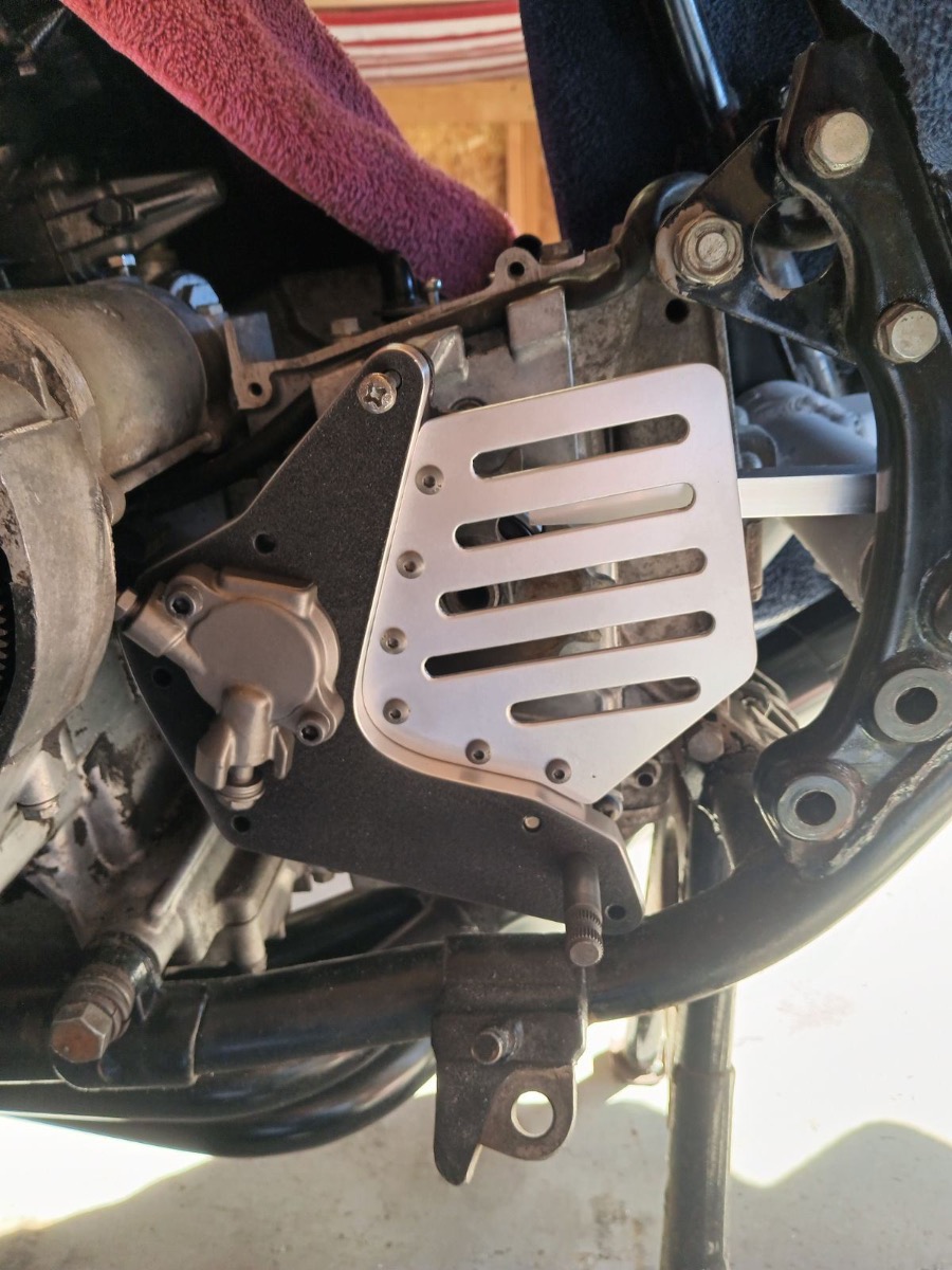

I'll post pics of my slave cylinder plate when the paint dries and I can handle it.

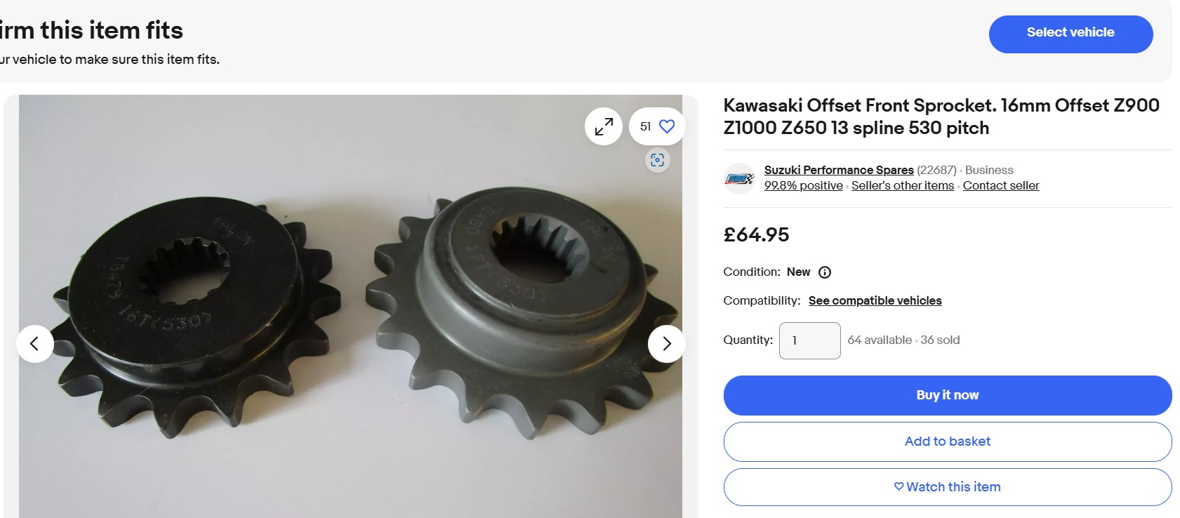

They are available (this is a UK supplier) so I guess there must be a vendor stateside that can supply

Offset sprockets of 1/4", 1/2", 5/8" and 7/8" etc are common and should be easily available online or from race shops such as Orient Express, MRE etc.

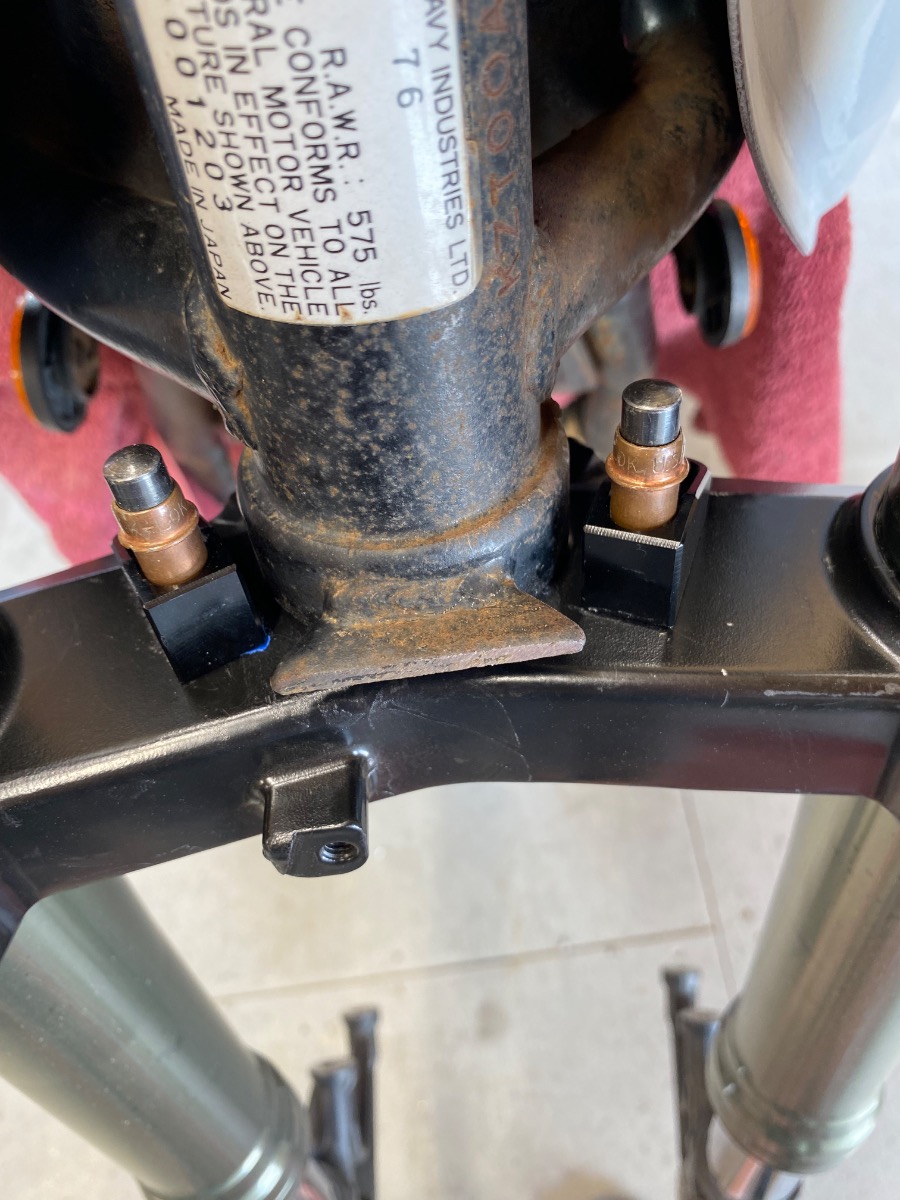

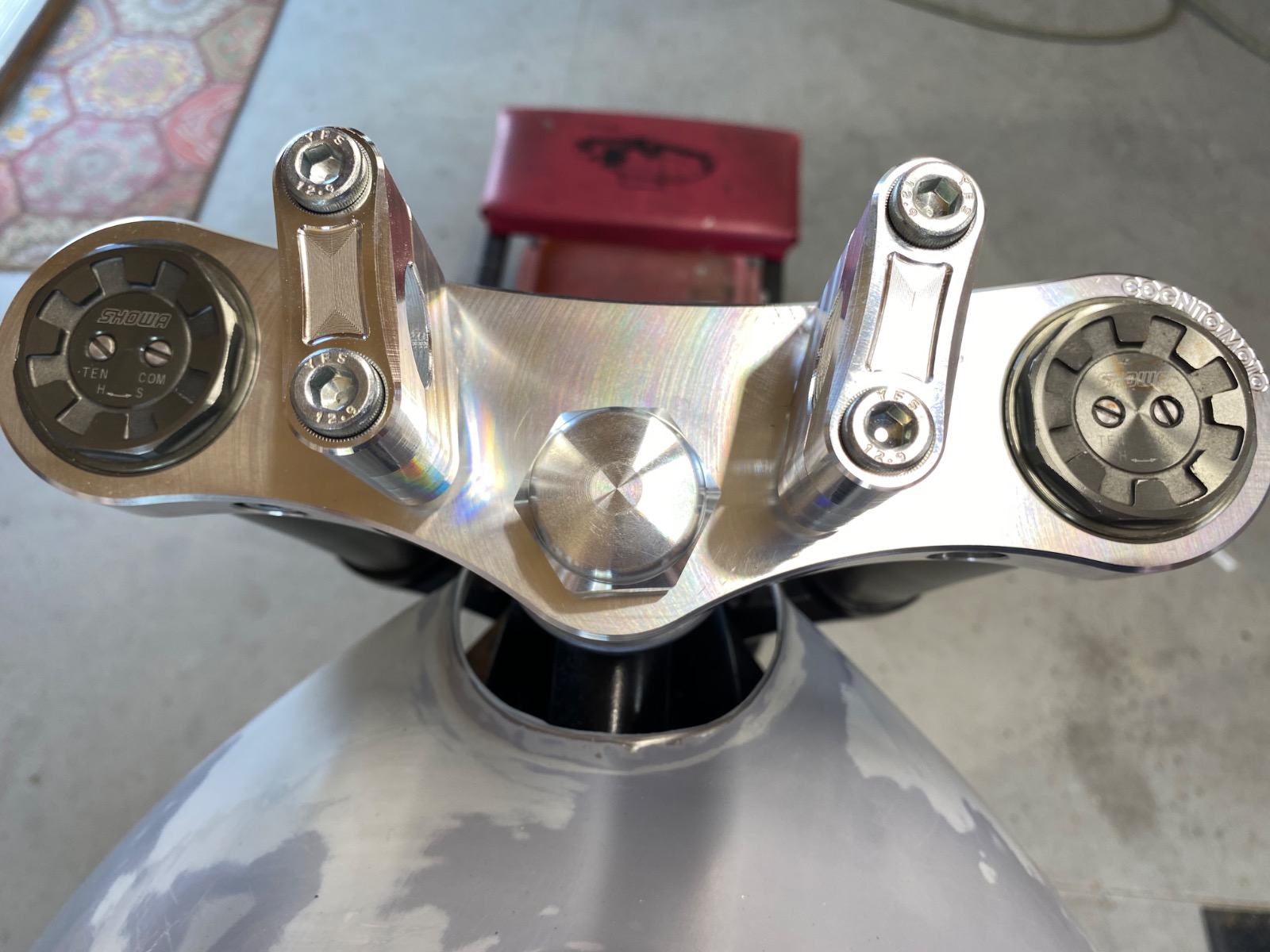

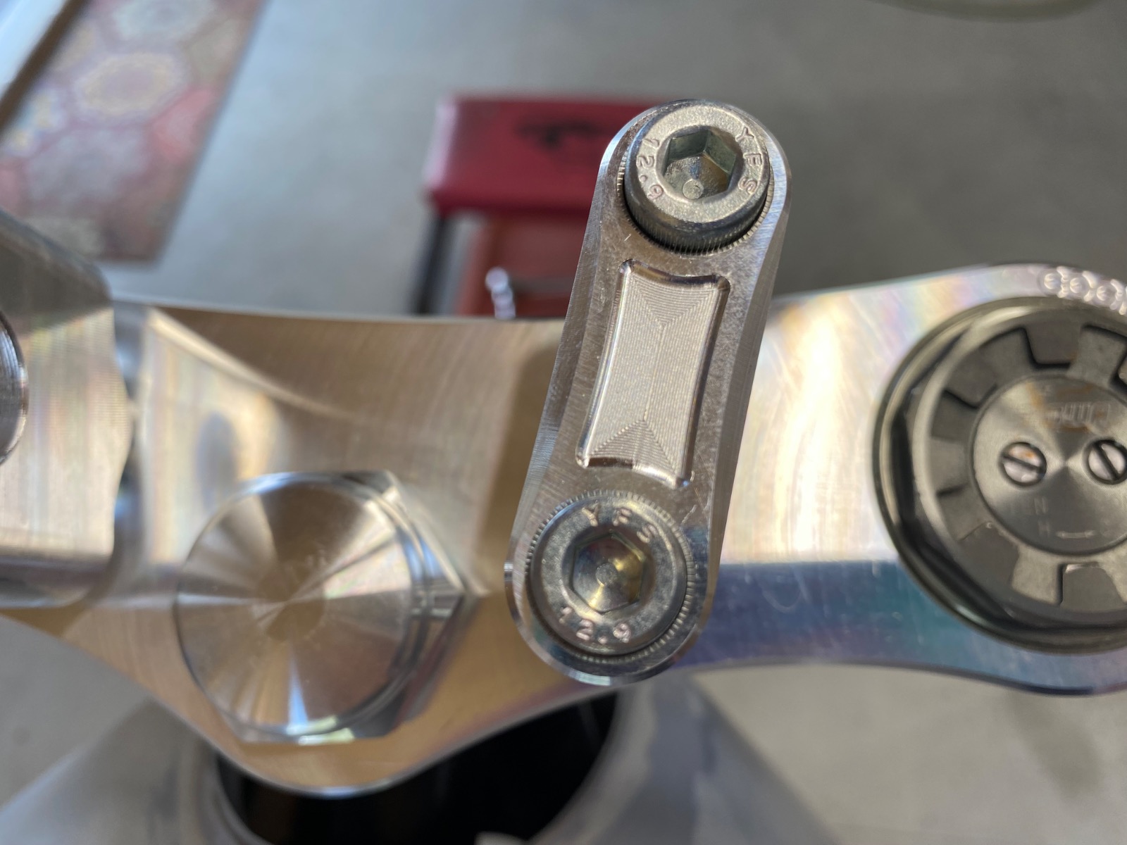

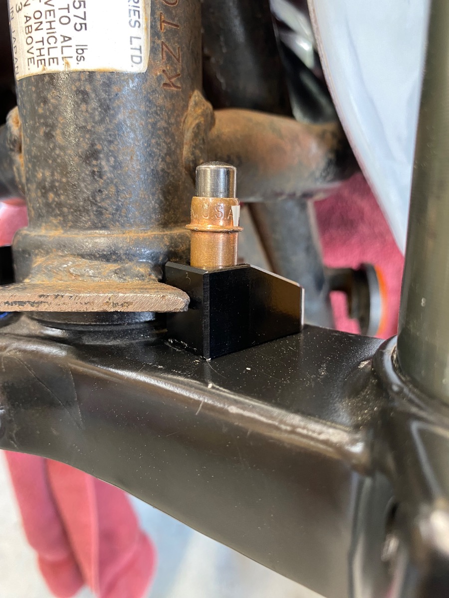

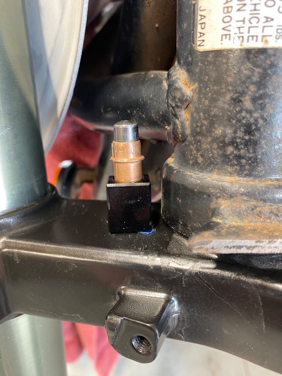

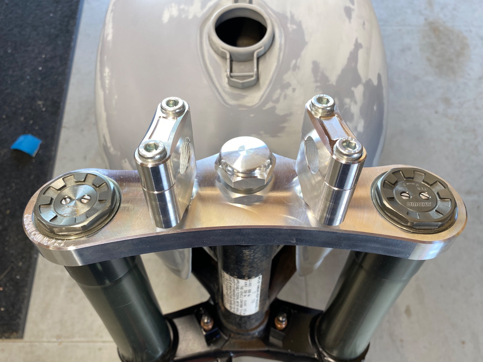

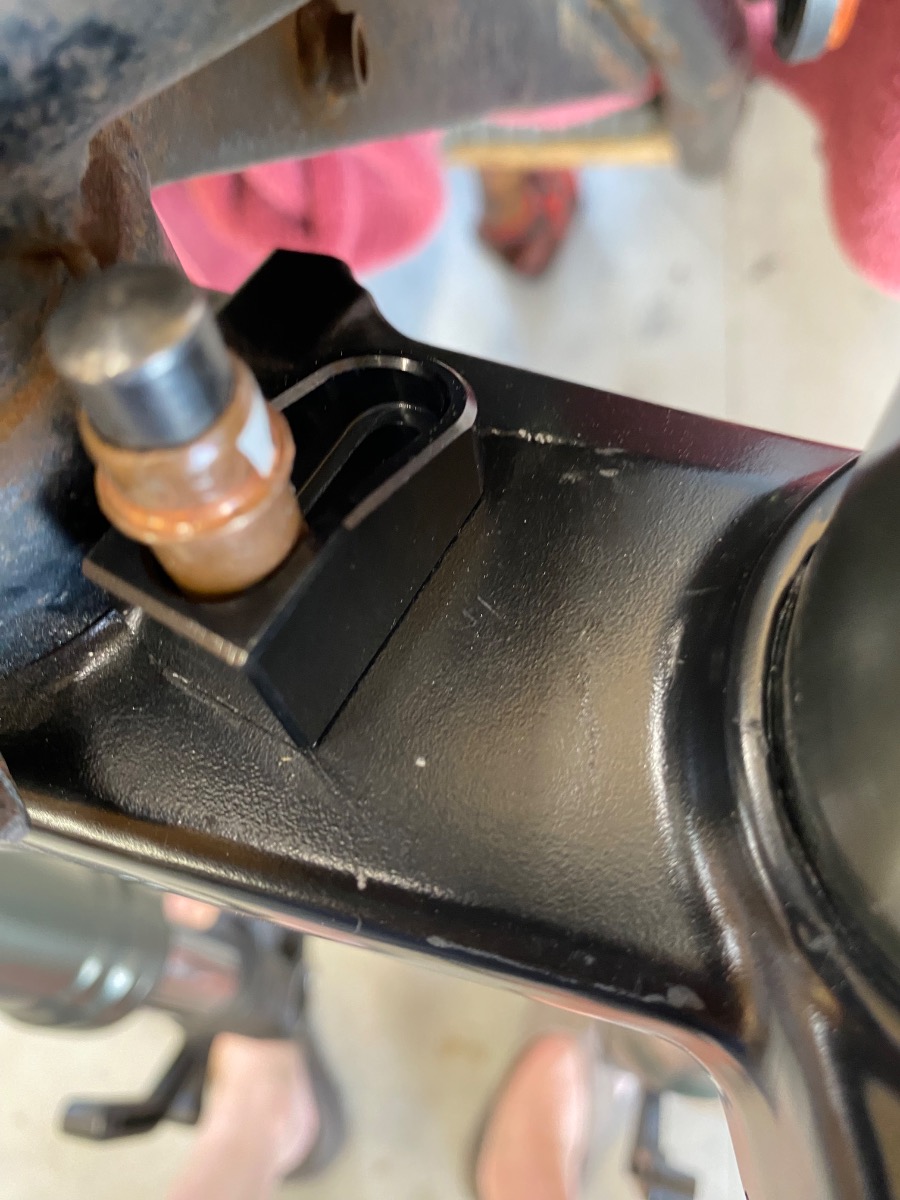

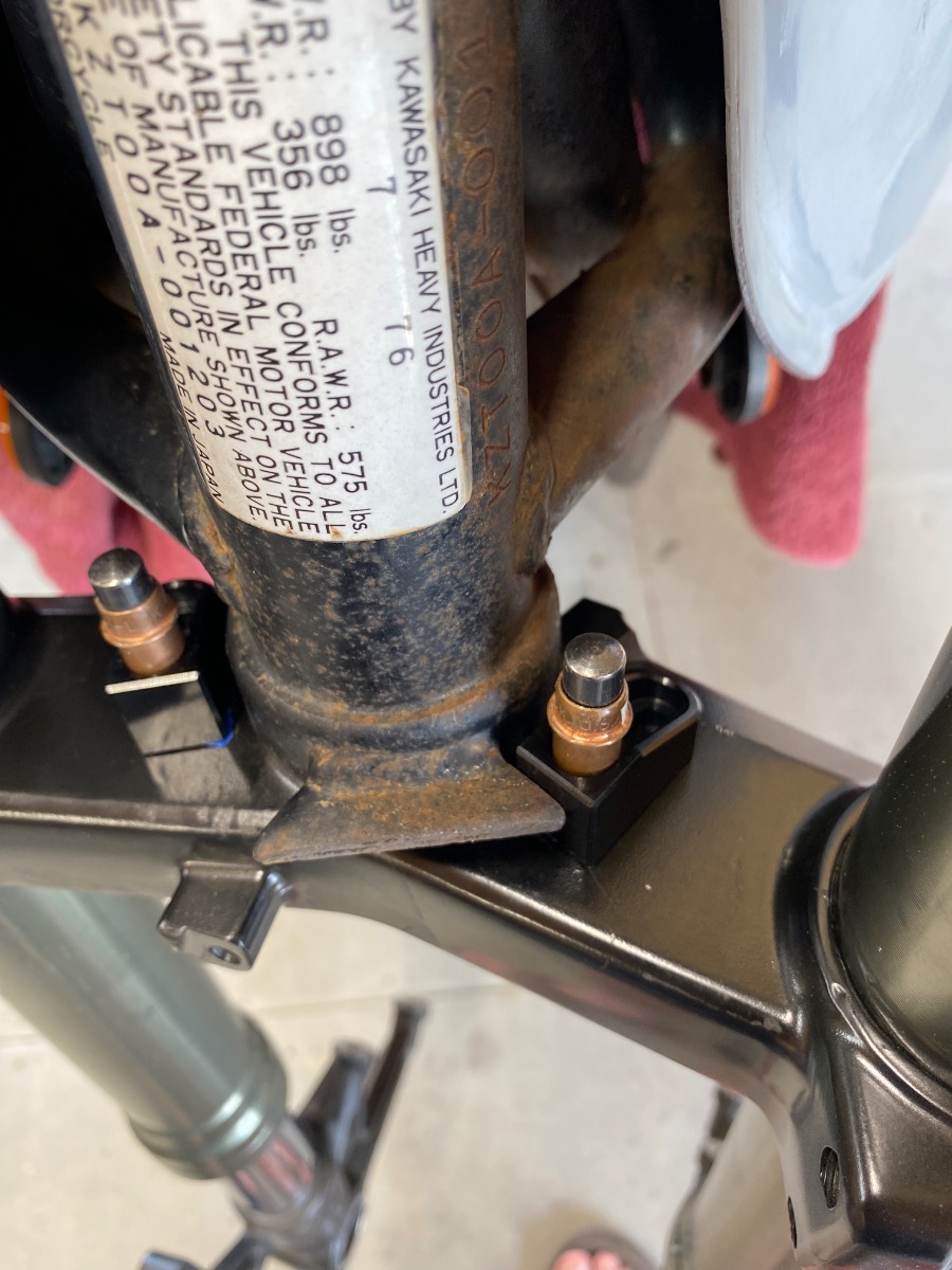

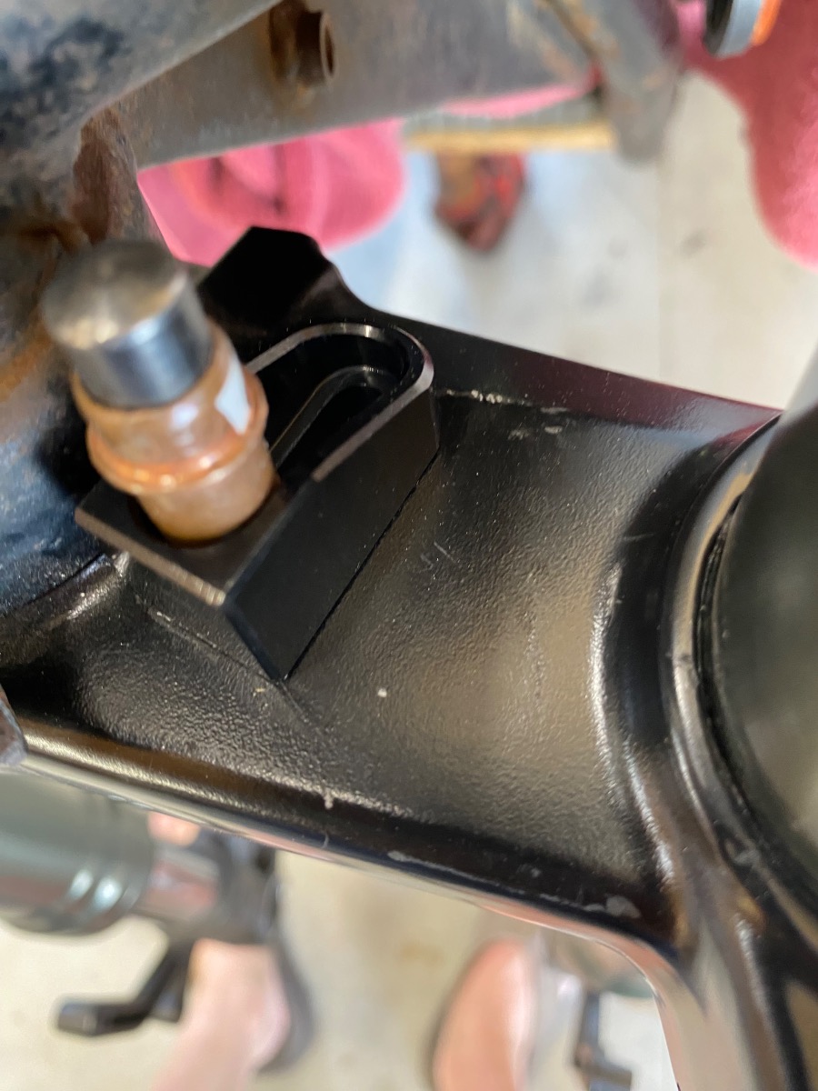

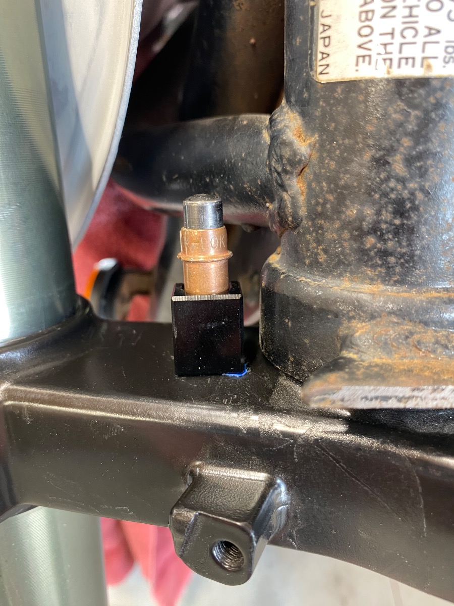

=19.5pxHey all. Been away from the shed for a while but I did get new triple clamps and steering stops from Cognito moto. Fit and look great. Have to final drill and tap the holes for the stops. Next I’m going to get an offset c/s sprocket and get the rear carrier machined for chain alignment. We’ll see how that goes.

The steering stops should be adjustable (grub screws or excenter adjutable bolts) in case the fork legs tent to collide with the fuel tank.

Hey all. Just a quick shout out of thanks to Wookie58 and Zed1015 for the
sprocket info. Ordered up an 18 tooth, 5/8" offset c/s sprocket. Thanks for the info. Wookie: I looked at that link you had in another post for Gearing Commander. What a cool site. Loads of info. Great help and very interesting. Zed: My brother-in-law knows a guy who can turn my sprocket carrier, so I can get that done for cheap (I like cheap). I'll figure the total I need to take off when I get the sprocket. Thanks again.
