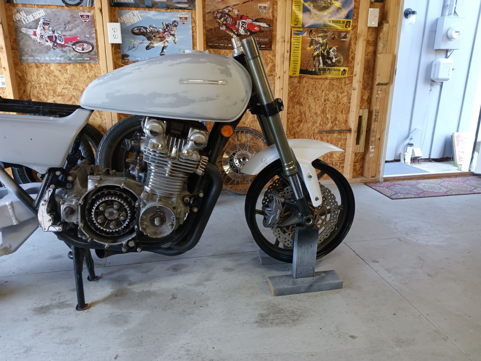

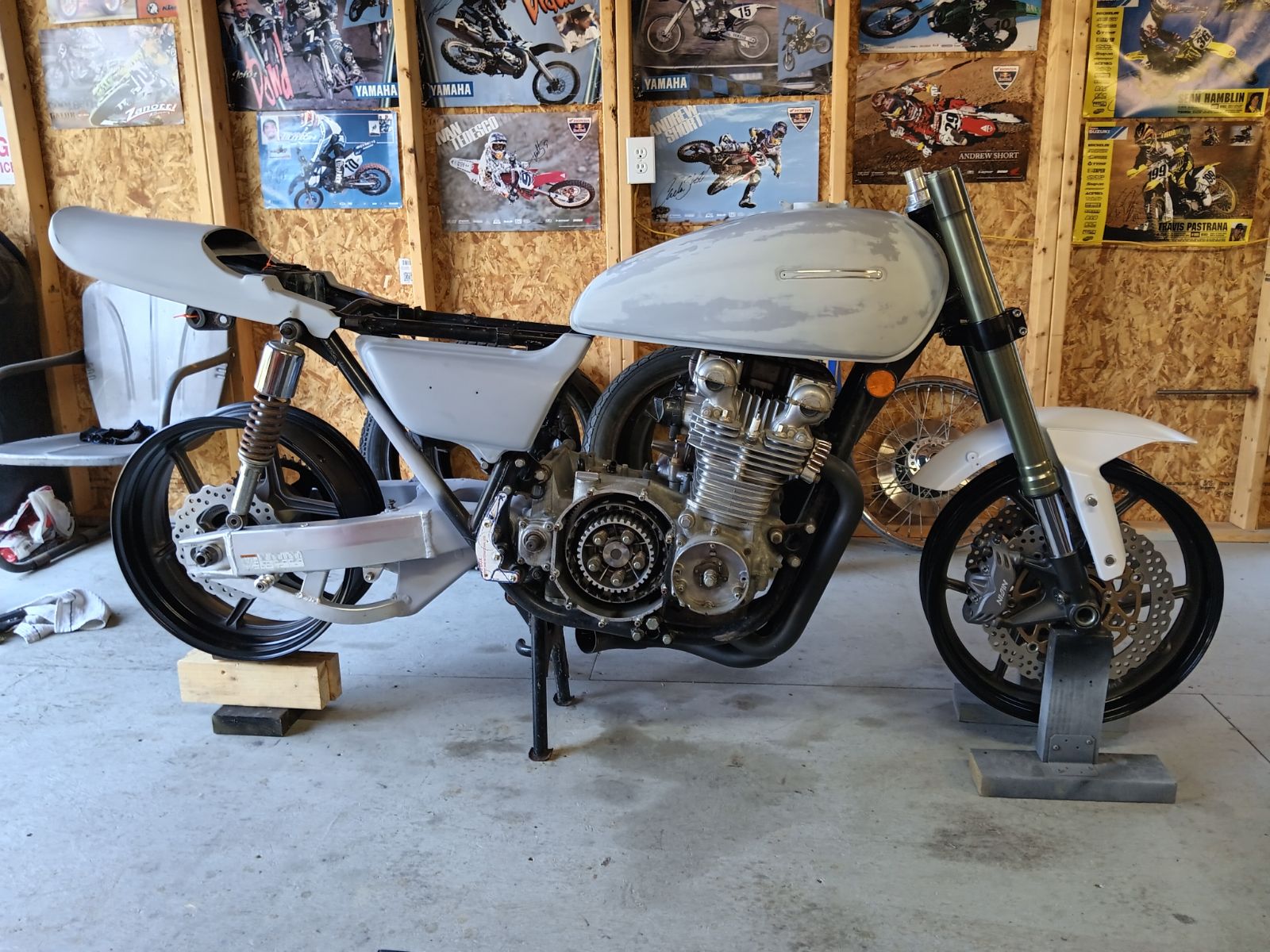

What front end are you using ? Often modern front ends are too short and can make the bike unstable (my RWU ZX9R forks are extended 75mm to get back to just under stock "J" with a 17" wheel) Zed1015 has a neat method of gaining 32mm on the USD units.
- WoodheadB2
- Posts: 51
- Thanks: 20
Re: Woodhead's '77 KZ1000A resto mod attempt.
26 Jun 2024 15:02
Front end is from a '12 ZX6. I'm kinda worrying about it being too short. I found some extenders that tread into the tops but I really can't drop them in the lower clamp any more than what I have em. The diameter gets smaller and they won't clamp tight. Not good! That's why I need to get it on the floor and see how it's going to work. I'm a short guy so I was thinking that if it comes lower than stock it might be if it my smaller stature. We'll see. Then it's back to the drawing board. Seems like a lot of that!

I'm not a big guy either, if it's too short the geometry gets a bit too radical and you risk some interesting behaviour if she gets unsettled at speed. Zed's mod is internal and simply extends the travel of the forks so you don't run into the issue with the OD and the tree's
