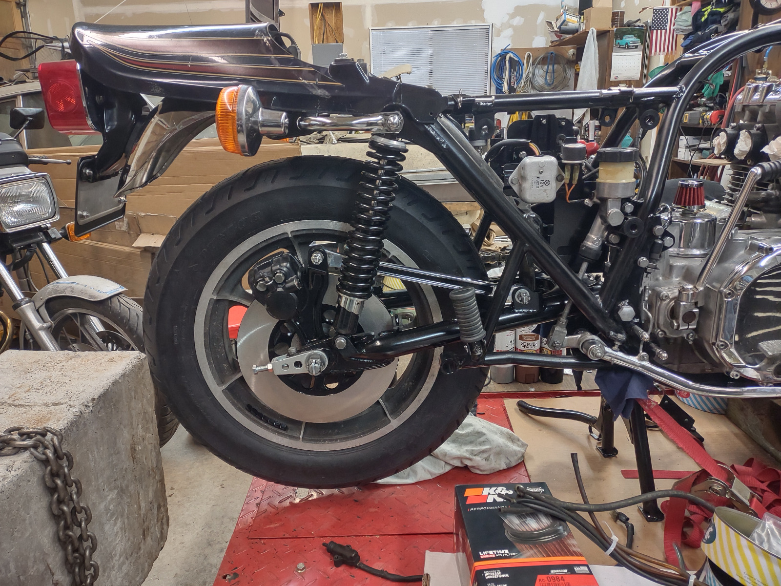

Another question I should have asked. The Rear M/C seems to be in pretty nice shape.
All the rubbers and seals etc. are soft and pliable. I'm thinking of giving a thorough cleaning and go with that, Thoughts?
The Cap on the reservoir has a bunch of cracks. Is it the same size as some of the other models? The Rear M/C with the hose or the front M/C with the round plastic reservoir.
Thanks in advance.
Thanks in advance.

The front MC is 14 mm, which is 5/8. On the rear, if everything works then don't fiddle with success. By the way, I'm a canuck too.

Actually, 5/8" is about 16mm, and the larger piston is typically used on the dual front disc bikes. A 14mm master is used on a single disc front end.

It looks like all of the KZ1000 models in 1978 used the same cap on the rear, as did quite a few other models. You can scroll down the Fitment chart to see exactly which ones.

I replaced my rear brake master cylinder cap with one from a brand new $20 aftermarket master cylinder that looked so cheap we were afraid to use it. The cap is a nice machined aluminum black one.

I checked it out. That cap is rare as hens teeth. I even looked up the upgraded prt # , so that includes Ninja's from the early 90s. none avail.
I'll have to do some more hunting. Oh! there is one on flea bay for $90 plus $24 shipping from the UK.

Where abouts did you find that one!? I did see one for about $30. I think it was reservoir, hose and cap. Just have to remember where!!
