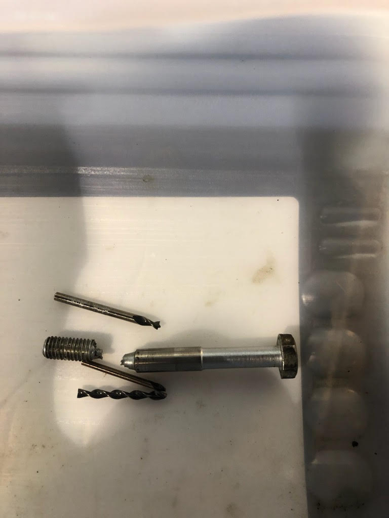

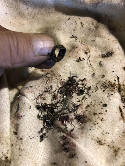

I'll try again. If they work, the first two are from the broken Ignition bolt. Second two are pics of my old Vetter set up.

Re: new to me 1978 KZ 1000
10 Apr 2023 20:36

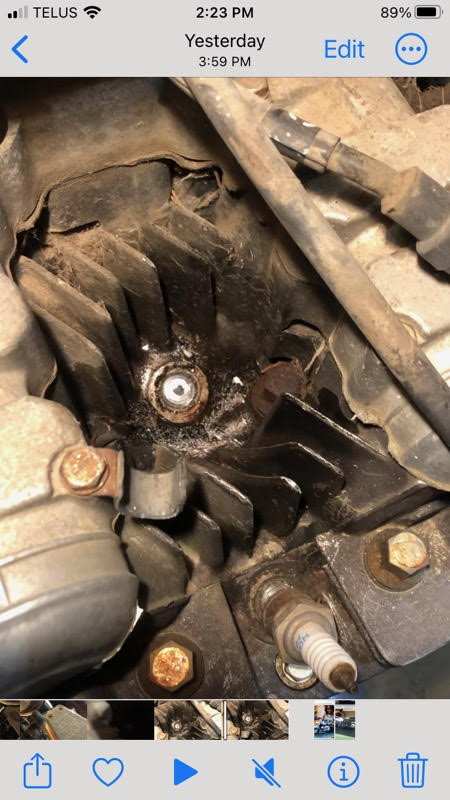

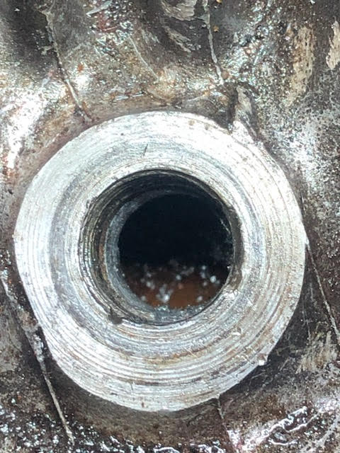

Well now that I have that fixed.
When I snapped the spark plug off. I thought well the worst that can happen is I'll have to install a helicoil.
But I thought I'd like to save the threads if I could.
After breaking the porcelain loose and sucking it out with the vacuum.
I started drilling out the plug at 1/64th increments, until was just about into the threads.
I was able to get the remainder to peal out, one thread at a time.
I was a pretty happy camper, when I got all of the plug out. I sucked up the filings in the cylinder with my improvised vacuum. I dipped the drill bit in grease to catch the fillings, but it didn't catch the all.

Well done! How do you plan to remove the bits on top of the piston?
- Treetall
- Posts: 94
- Thanks: 18
11 Apr 2023 10:02

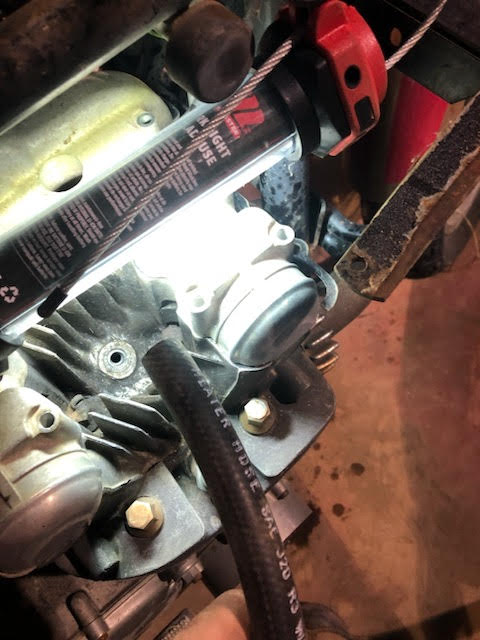

I took a small flexible magnet and fished it around until nothing was sticking to it.
I then took a smaller hose and inserted it into the small black hose in the pic. And swished it around the cylinder for a couple of minutes.

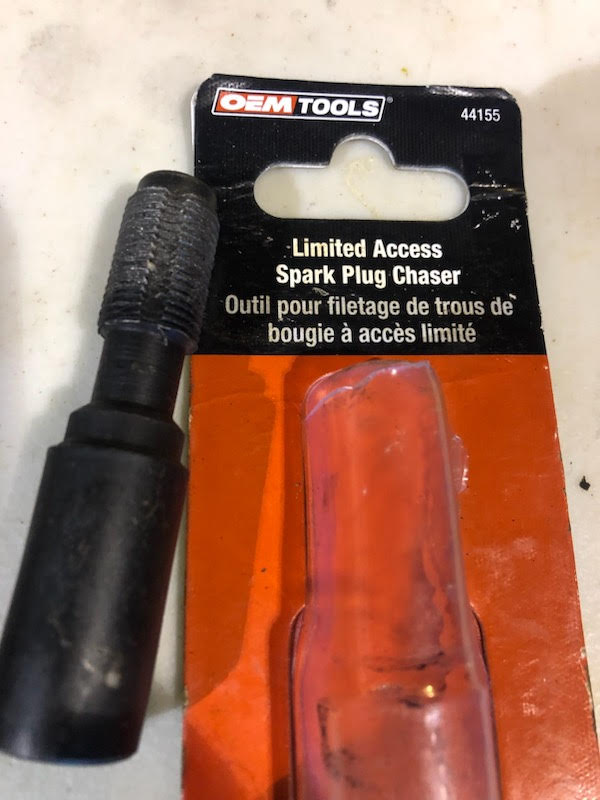

I bought a thread chaser to clean up the threads.

Are you in Canada?
That OEM tools product is a Canadian Tire item. I have used there spark plug thread inserts.

Hi Injected
Yes I am north of the 49th.
It worked pretty slick cleaning the threads.
Good to keep in mind. Are they as good as Heli coils?
I've never worked with Heli coils either, but I've had friends use them with pretty good results.

26 Apr 2023 18:43Hey, from those pictures you look like your out in the Prairie's. I hail from South Western Ontario.Hi Injected
The inserts I mentioned are more like a Time Sert and not a Helicoil.
I would not use a Helicoil for a spark plug repair, but OK for a something like a M6-M8 thread.
Anything bigger and I would try to make my own insert out of a bolt if I could not get a solid threaded insert (Time Sert)
So far you look like your doing great on your project. Keep up the good work!

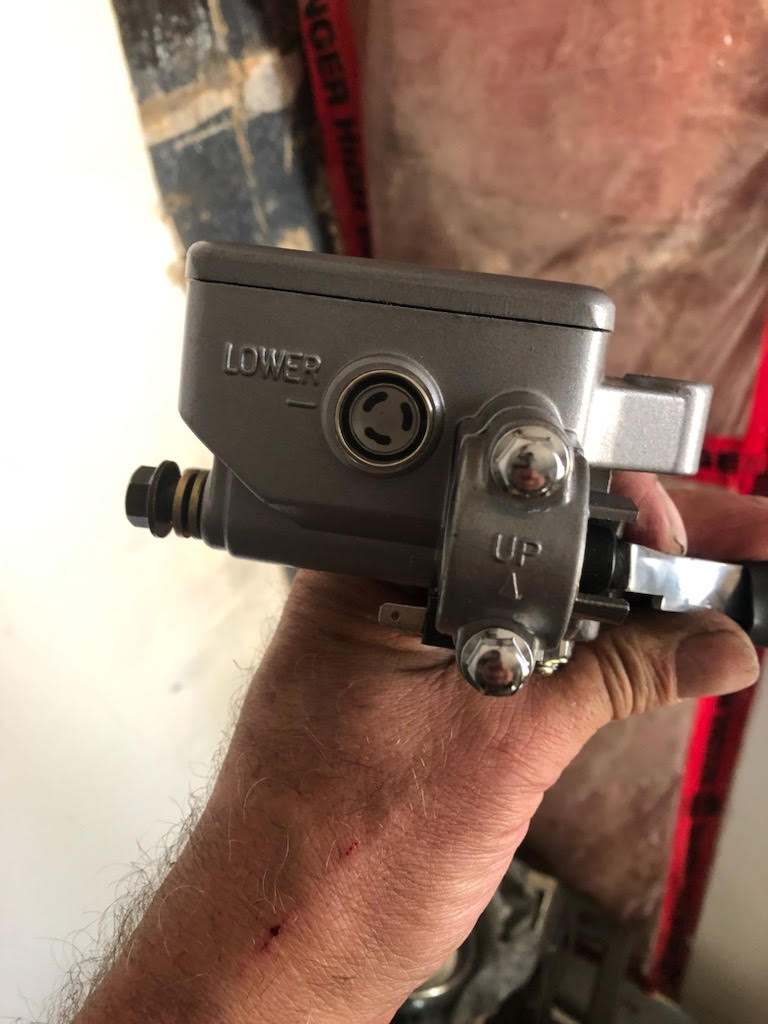

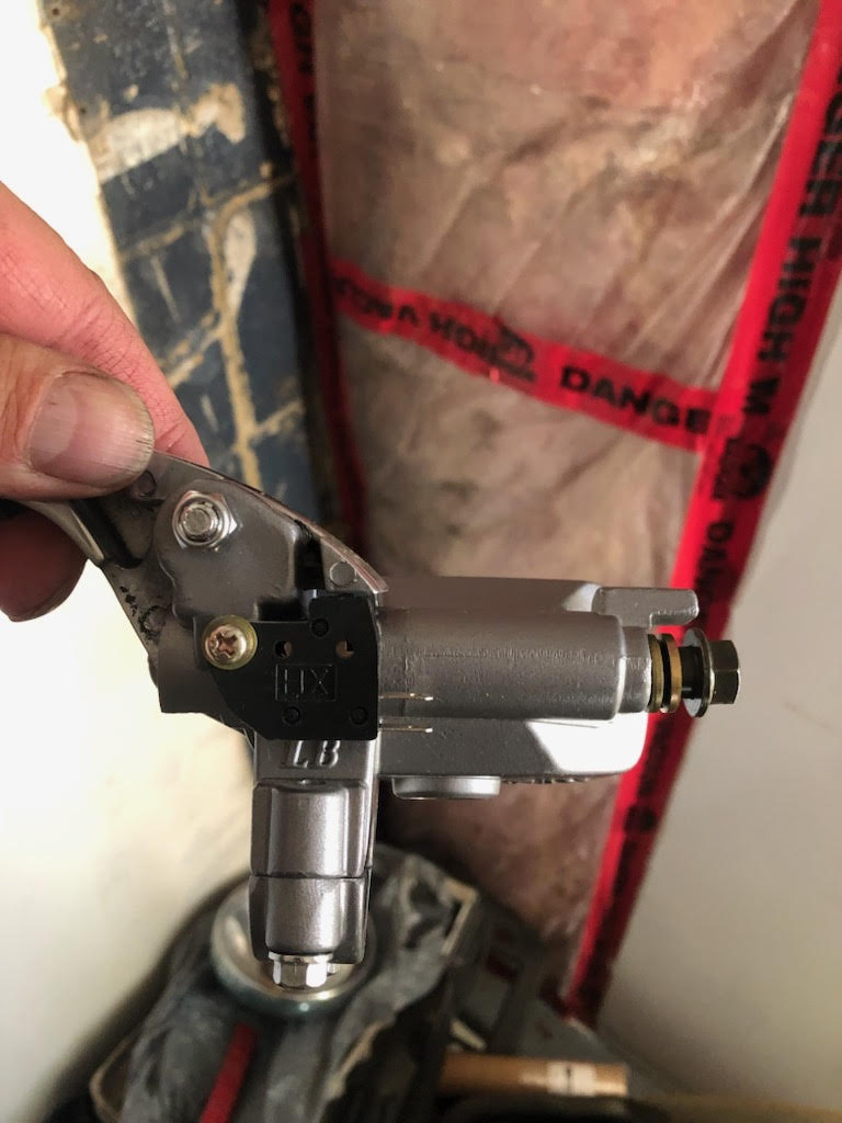

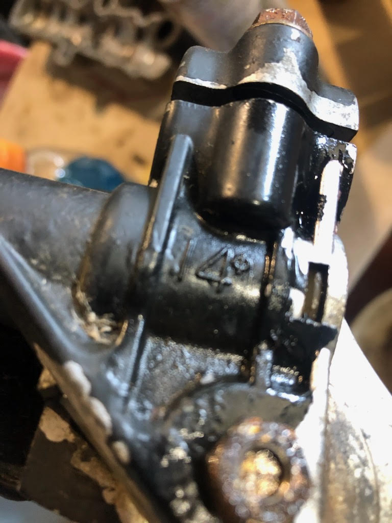

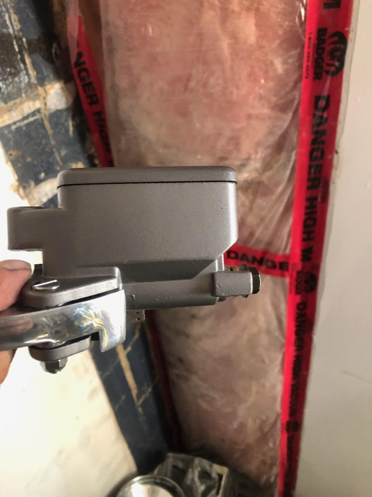

I've got the trapezoid style front M/C, and it's cooked. I was given a new M/C when I picked up the bike. But it's a different style.
The person that gave it to P.O. said it will work. I've attached pics of it and the old M/C. The old M/C has 14 stamped on it. I'm assuming it's a 14 mm M/C.
I can't find a size on the new one. It has two prongs for the brake switch. So I know it's not OEM for this model for sure, as the brake switch is down between the forks.
Just wondering if this may be a 14mm or 5/8", or how to tell or measure?! Or should I just give it a shot and try it at low speeds. If it's to grabby or too vague of a feel, I'll have to get the proper one. I'm on the Venture riders forum and there's a number of guys that have up graded to R1 brake calipers. Some say they need to switch from the OEM 5/8 M/C to the 14mm M/C because of the vague feel.
