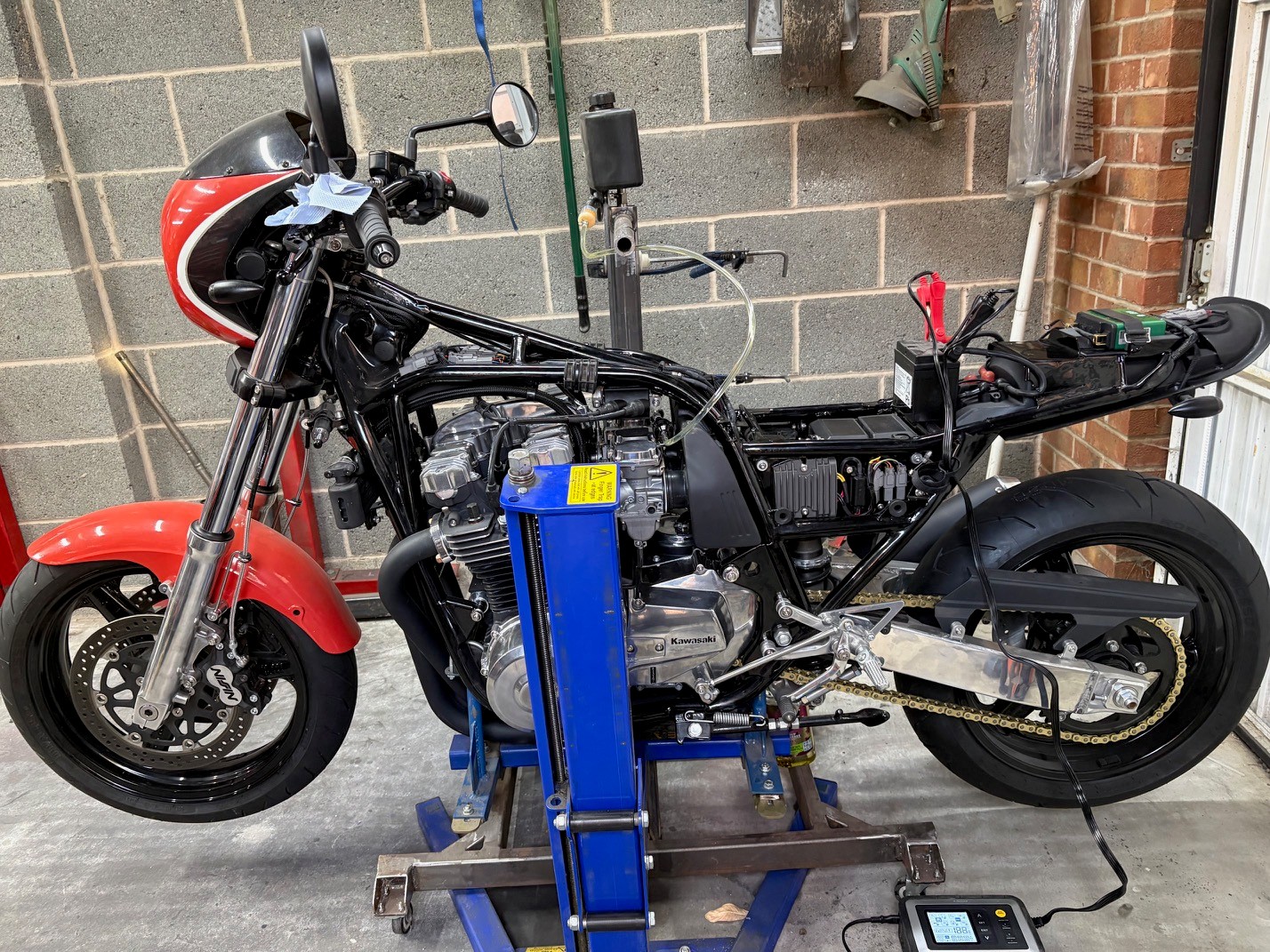

As yesterday was a holiday in the UK I got back to it (Sunday my grandsons took me to a "tuner" car show for my birthday, some fantastic builds there in amongst the stuff that I'm too old to appreciate !!) completing the last few little jobs like finishing the battery leads etc and clearing all the crap in my garage so I could spin the lift around and point the noisy end at the door.
So first thing was that there are some interesting things happening electrically (this is the first time it's been powered up since building the wiring system) which I am hoping is down to configuring the electronics that I have installed. She cranked nicely, built oil pressure with no leaks from the cooler lines etc so let's go for a "start". I turned the fuel on and waited a few seconds for the carbs to fill, then noticed a familiar smell !! there was a puddle of gas forming under the bike !!!!!!!!!!!!!!!! #3 drain screw isn't sealing which is disappointing given that all four drain screws are new OEM items (when I did the float heights a couple of them were reluctant to close complete but after working the screws in and out a couple of times they seemed to be ok) So that's it for now - sort the electrical gremlins and fuel leak and she will be almost there (just need to sort the fuel sender and decals) then final spanner check and dial in the suspension sag etc. I guess it was a little optimistic to think that on a build like this I could "throw a battery on and fire it up"

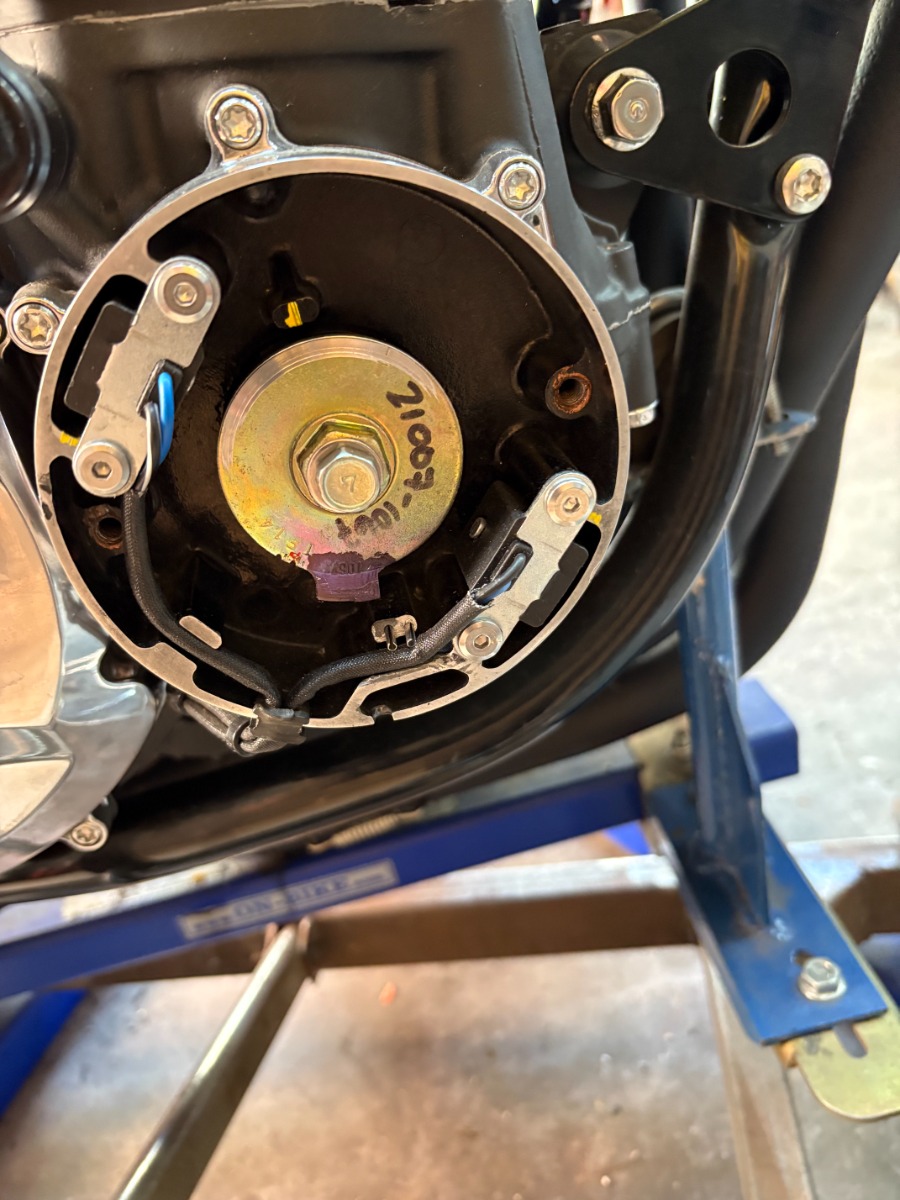

When trying to start I got a lot of bangs from the exhaust and farts in the airbox but nothing more, to me this is classic signs of ignition timing or crossed leads but that isn't the case, the correct pick ups are triggering the correct coils and the timing is fixed (I am using the digital ignition from a late GPZ1100A2) I need to work through the ignition as the only non OEM components are the pick-up coils, the resistance is lower than GPZ spec and the air-gap is bigger than GPZ spec (I don't know how much effect that will have although the air gap etc is critical with this kind of sensor)

So it's update time again, man this bitch wants to fight me to the end !!!! I started digging into the non-start issues, all the symptoms suggested ignition but everything tested ok, there was a pulse a the coils and sparks at the plugs. The only thing I had done to the ZX1100 ignition system was remove some material from the rotor to align the timing with "true TDC" so I built it back up with weld and ground it back to original spec (thanks Stusco for the dimensions) Therefore I decided the cold #2 & #3 was a "red herring" and it must be carb related. I pulled the rack off and rechecked to pilot and idle circuit, one thing I did find was that the Viton gaskets I made for the bowls were too tight around the choke tubes and probably restricting the fuel pull to the plungers. I had to make a simple punch to open the holes to 5mm and give some clearance. Built it back up and still the same, popping banging and farting but not starting. I ran a compression test and whilst I didn't expect miracles on a fresh un-run bore I did expect more than 80psi across all four !!!!!. So back off with the carbs again, and the coils etc t remove the cam cover. I found that the cam timing had slipped on the slotted sprockets (I guess after I tightened one bolt and rotated the motor to tighten the second one on each sprocket) I also found that since I built the head on the bench, once fitted with chain tension on it and much cranking the valve lash has closed up on 6 out of 8 so I adjusted those and put it all back together again. I finished that process yesterday morning so with a freshly charged battery and much optimism I hit the button again, and more farting popping and banging !!!!!!!!!!!!!!!!! I was starting to lose it at this point so made a coffee, sat back with a cigarette and started to think about why ?? The pick up coils I am using are aftermarket GPZ900 items as the only OE 1100 ones I could find were in the USA and by the time I paid shipping, tax, duties etc would have been $150 for 40 year old parts with no idea if they were any good and no viable option to return them. These have a much lower resistance than stock 1100 so I fitted 300ohm resistors in line with each one to control the current through the igniter, however the wire colours don't match anything so I had to guess !! now my thinking was that if I got it wrong here would be no pulse and then I would swop them round. I had a pulse so assumed it was correct ???? So now I decided to dig deeper, after some research it turns out that magnetic sensors are polarity sensitive but just to mess with you they will pulse both way (information found on Holley and MSD websites suggest that if the polarity is wrong they will still pulse but could throw the timing up to 30 degrees out !!!!!!!!!!!!!!!!!!!!!! After a bit of detective work with the test procedure for the igniter I managed to work out which was live and which was ground and sure enough the pick-up for #2 & #3 was wired backwards. Once corrected she started on the button almost immediately, happy days

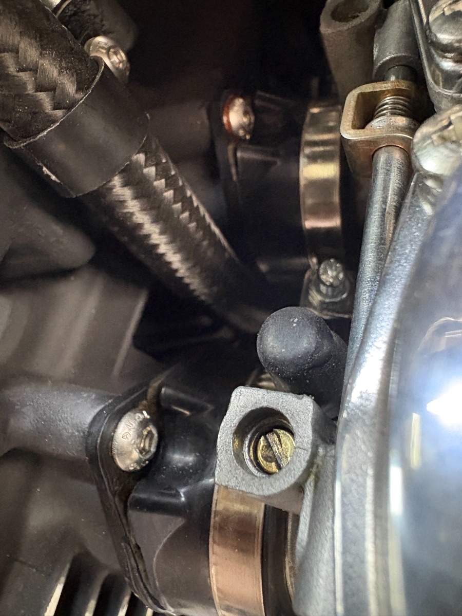

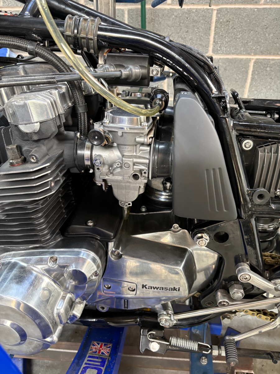

It was getting late so after running it up to temp the only issue was a slight hanging idle which given I haven't synced them yet or set the idle mixture I was OK with that. And so to today, whilst cold I re-torqued the head and thought I would check the carb clamps and boots where tight before starting again the set the carbs up, this was when everything turned to shit !!! the carb mounting rubbers are new (not OEM) I won't name the supplier but the rubbers are from Cruzinimage. All four are split wide open where they have de-laminated. At this point I pulled the carbs again then shut the garage door and said "f+~k it" In fairness to the supplier he has already responded (on Sunday evening) and will resolve the issue tomorrow.
