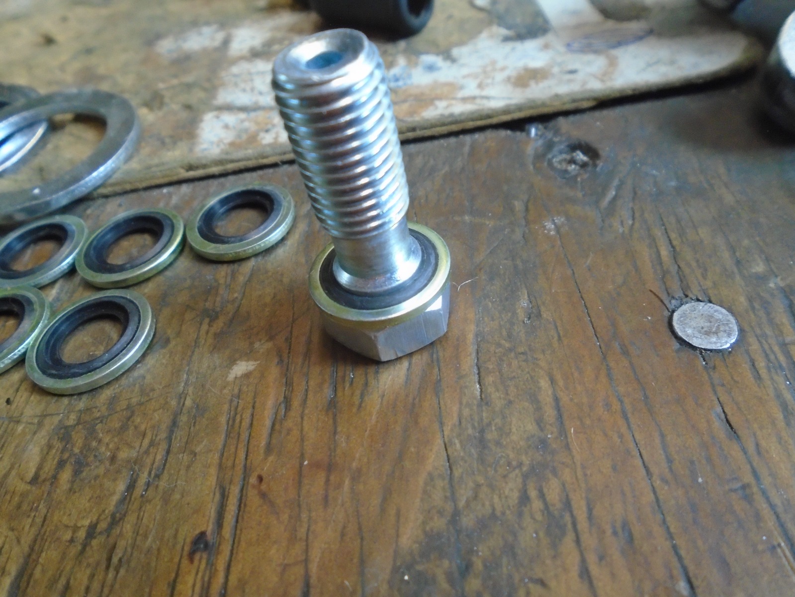

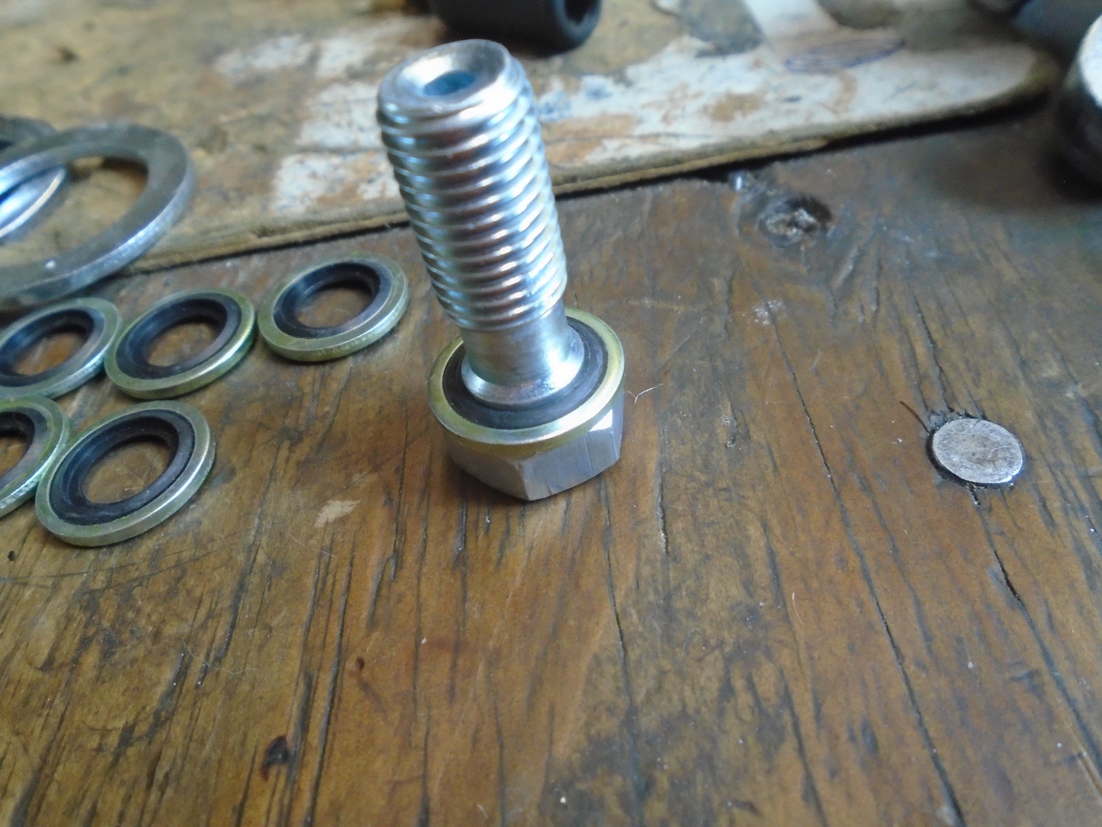

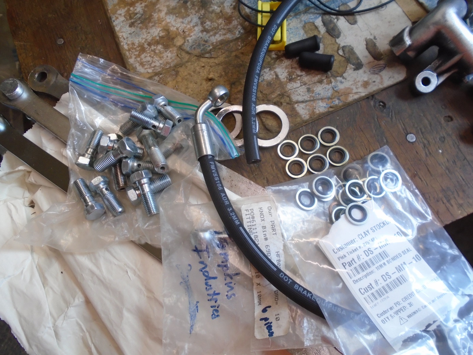

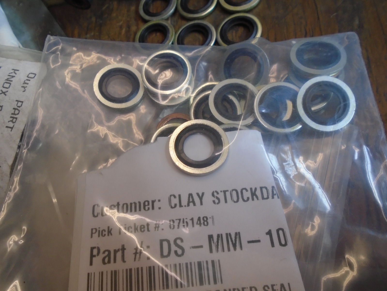

Sorry to see the evidence of a failed attempt Wookie. A lot of the stuff i'm looking at seems unfamiliar for OEM but have a mindful look at this. I've not used OEM "crush washers" for over a decade. Kawasaki is wider and Yamaha thinner CS of material but i don't worry about the details of such. Just replace with a Stat-O-Seal type banjo washer and all those woes go immediately away. I'd assume you're using 10mm banjo bolts? Doesn't interfere with fluid getting to where it needs to go and even used on a restoration, one would be hard pressed to tell the difference. I do a lot of brakes, this resolve has Never failed me and You don't have to Ham-Fist them down to seal. I also do my share of triples and same technique applies. Kinda bizarre, timing was impeccable for your episode. Getting ready to ship a set of these to a Friend in North Carolina, ha.

Thanks Clay, the OEM "O" rings I mentioned are the rubber ones that sit between the calliper halves (6 pots) I think to be honest I was being optimistic about the pitting in the seal grooves not being an issue. Still I guess if they are going to fail better on the bench than the road !!! this was why I did the air in a container of water test rather than fill the system with fluid again. I have put a bid on a set from a ZX12 which will hopefully be in better shape (will pressure test them before I get too involved)
