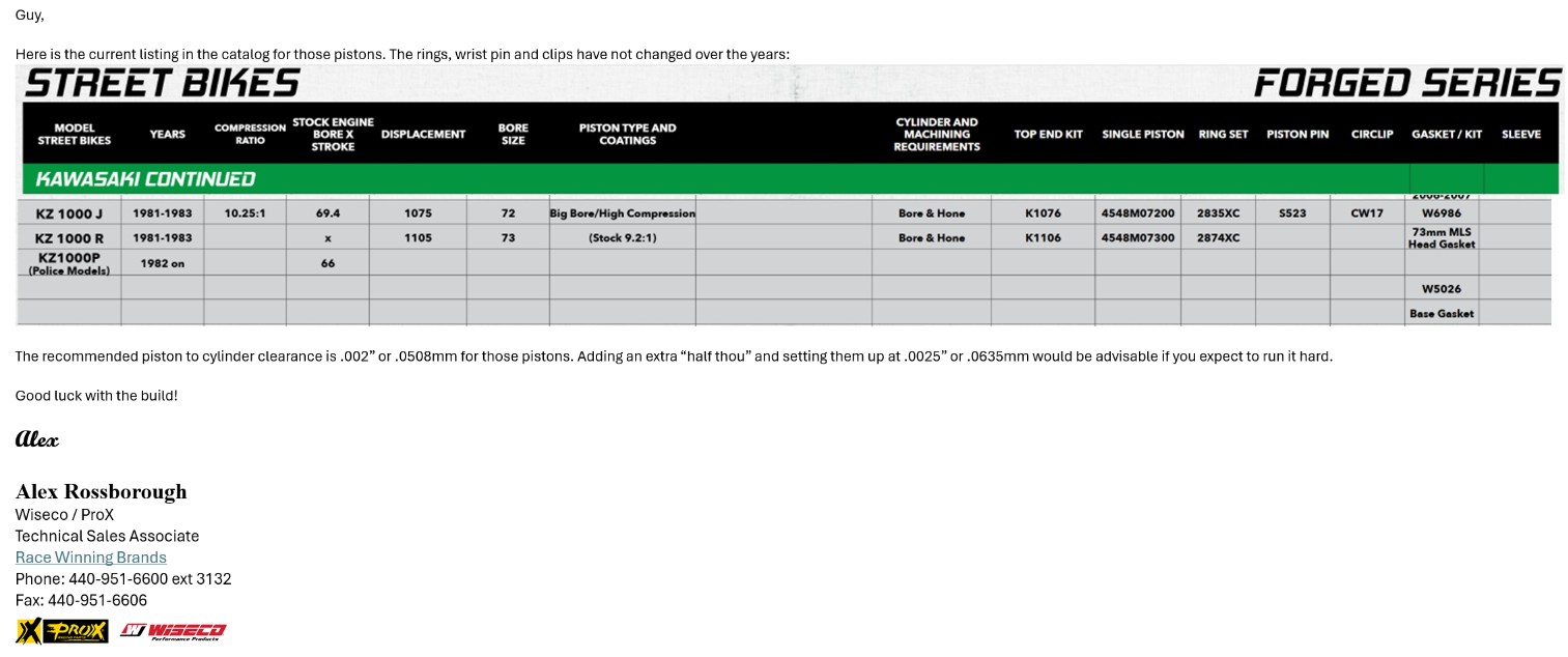

09 Jun 2026 03:05Thanks for the "heads up" Daveo (glad I read this today and not last nightI will measure tomorrow and let you know (mine are 72mm though - 1075)Reference screenshot of your May 7 post attachment below:
I'm curious what the measured distance of your valve pockets are compared with the reworked Wiseco pistons in my 84 J motor shown below:
After looking closer at that piston screenshot, it appears your piston crown closely resembles a Wiseco 4502M07200 piston supplied with K10751 kits for 76-80 KZ900 and KZ1000 motors.
...vs. the 4548M07200 piston for the 81-83 KZ1000-J motors, and provided in the Wiseco K1076 kit shown below:
Hope I'm mistaken about this, but thought it best to share a potential concern...

The newer 4302M07500 K1172 kit pistons were 62mm too...initially.

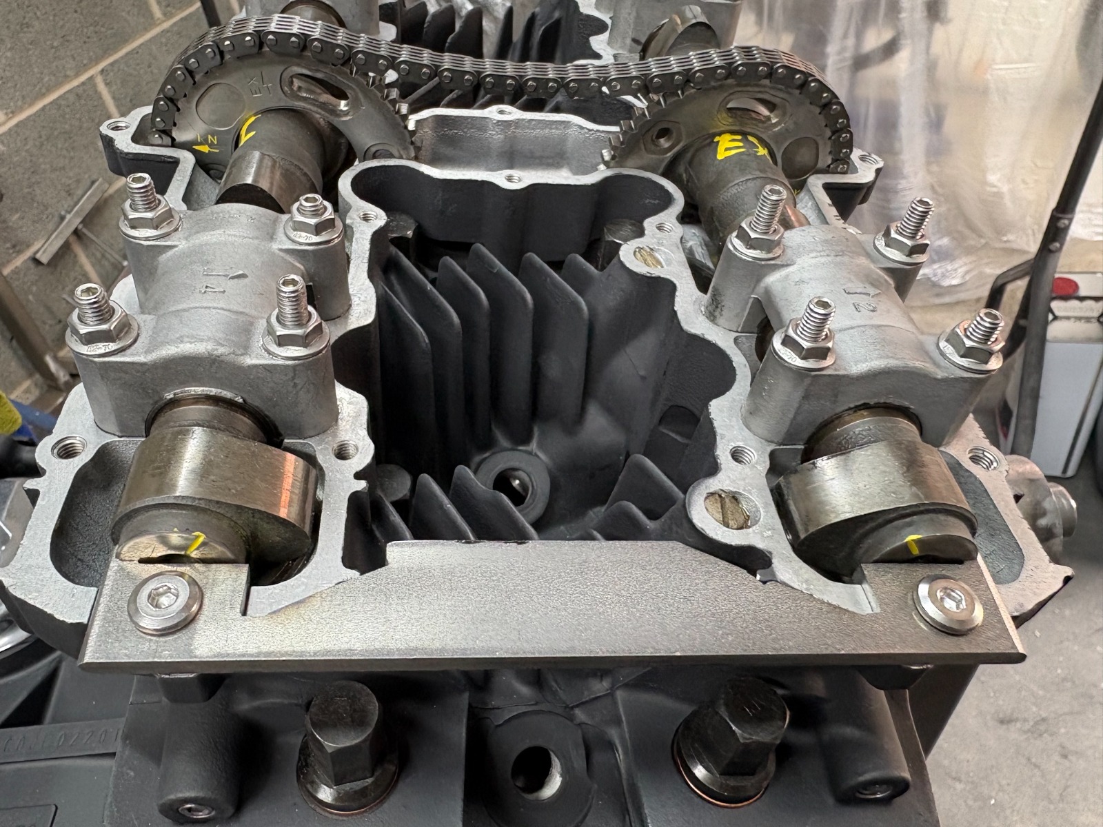

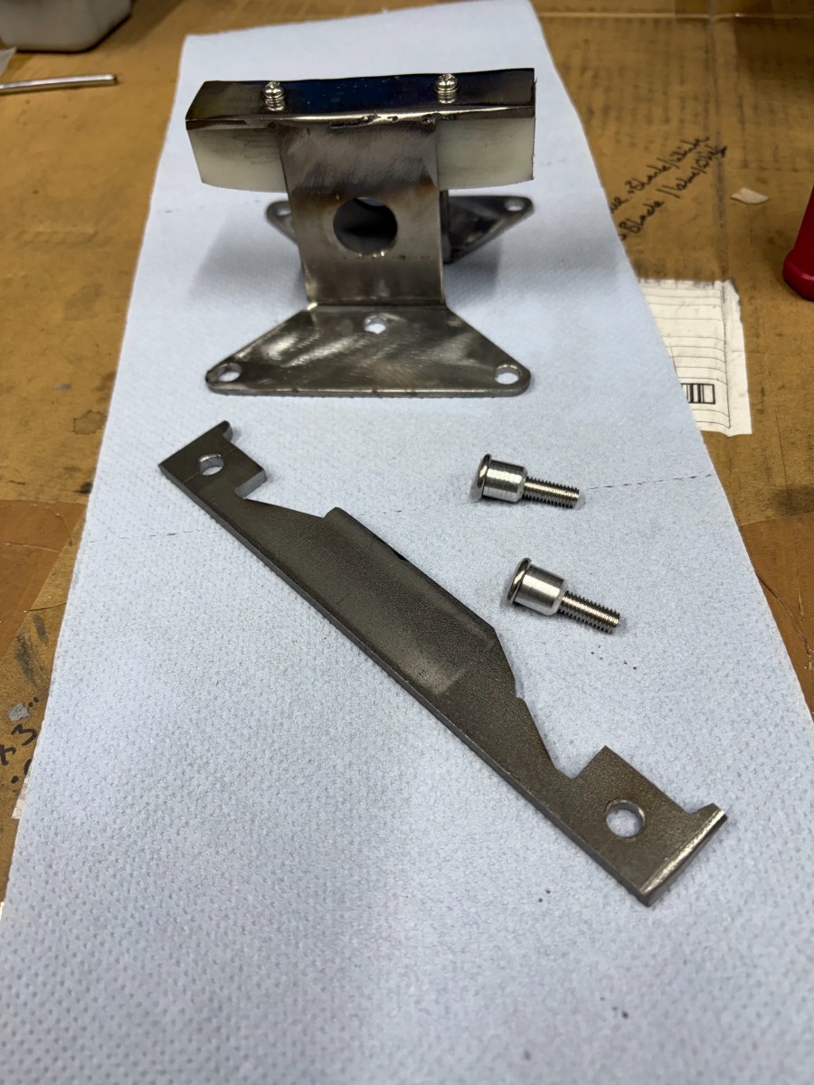

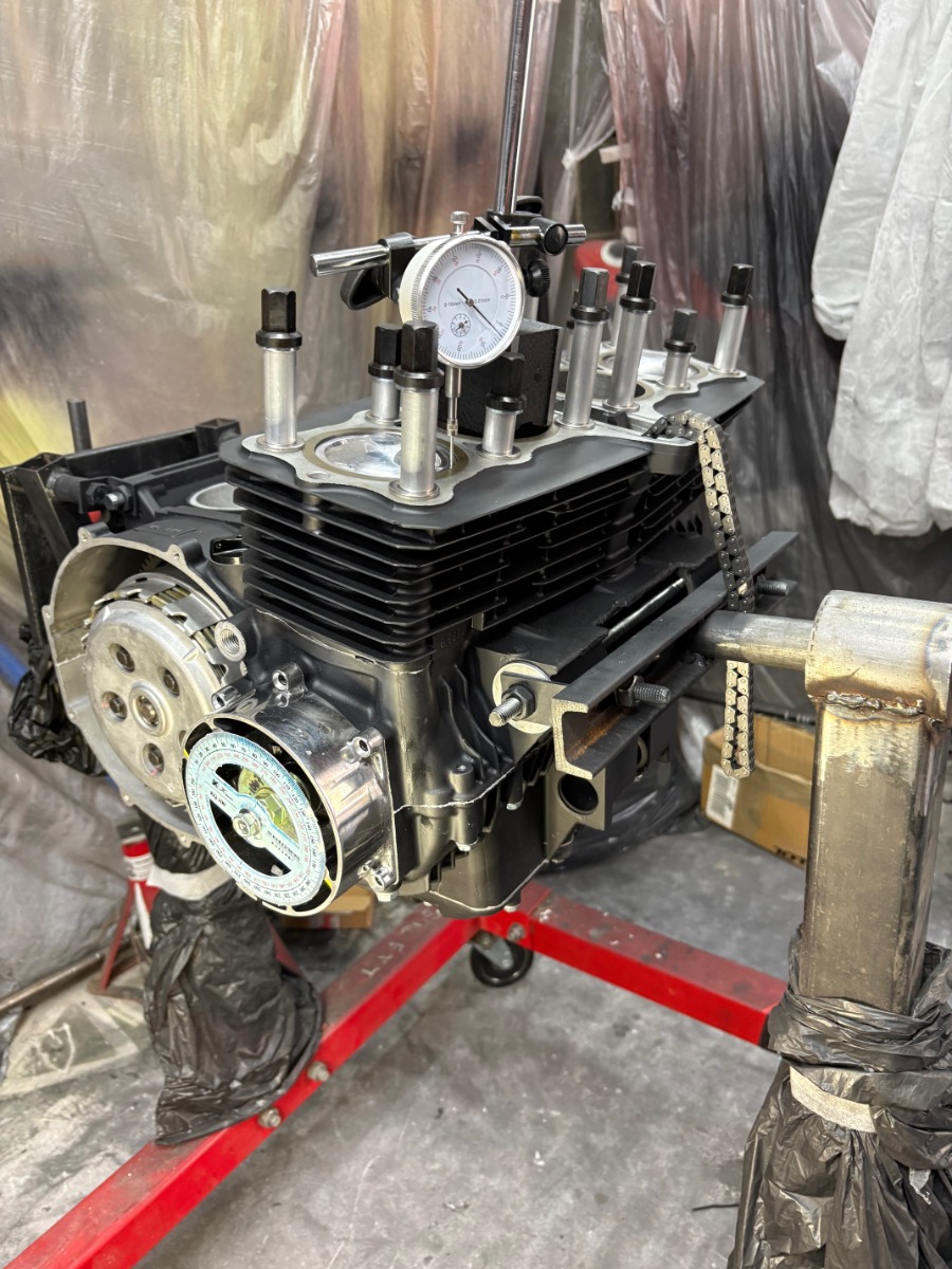

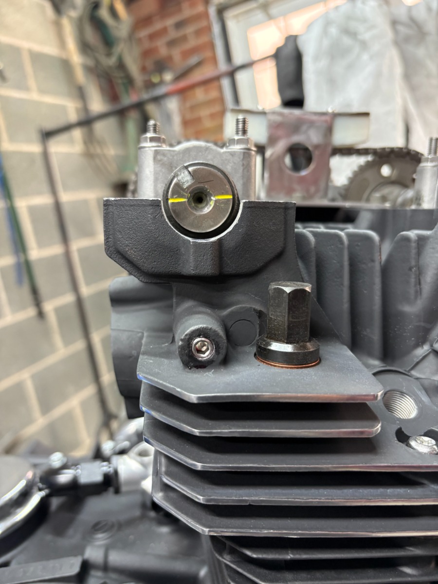

I spent yesterday making a couple of tools to assist in setting the cams up, a locking bar to hold the cams when at TDC to get the initial timing (I'm using slotted sprockets) and a substitute for the guide in the cam cover so that I can rotate the motor with the cam cover off and the tensioner set (I needed to be able to do this to dial in the lobe centres) Both worked like a charm with the cams only needing slight adjustment for the lobe centres. Just need to swop the stator into the polished cover and tidy up the engine wiring ready for Quofan coming over on Friday to assist in fitting the motor without scratching anything

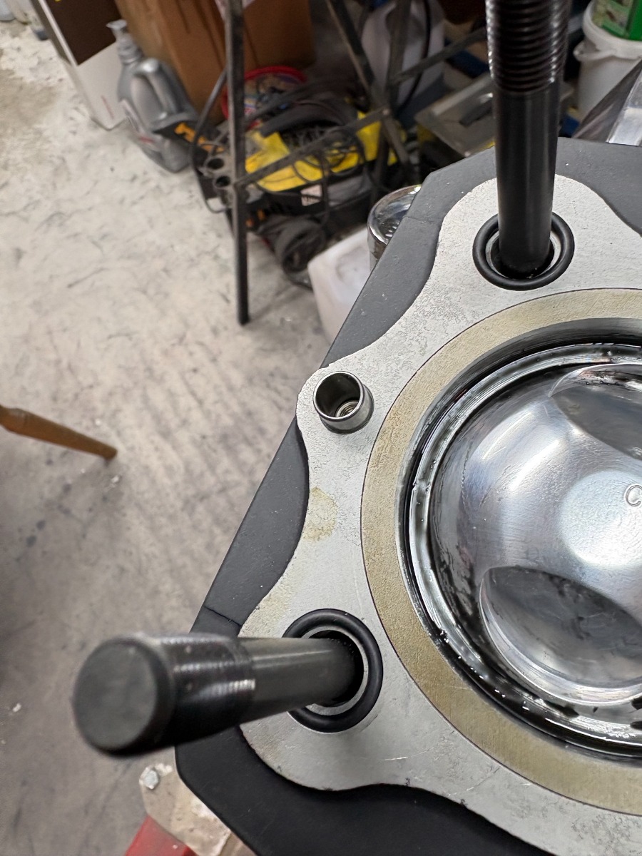

One little conundrum was with the head gasket, the holes in the four corners are way too small for the factory "O" rings ?? I didn't want to mod the gasket as the sealing area between the oil way and the fire ring is pretty narrow but the OE "O" rings are two thick to fit under the gasket !!!! after much head scratching I decided to use some generic nitrile "O" rings that would fill the rebate in he block but where only sightly proud so would compress under and support the gasket (time will tell) !!
You may have noticed that in the one pic the cam sprockets are loose on the cams, this is because I like to set the pistons down the bore a little until the head is on and the cams are in the correct position then bring the pistons up to TDC (this eliminates any risk of causing damage during installation)

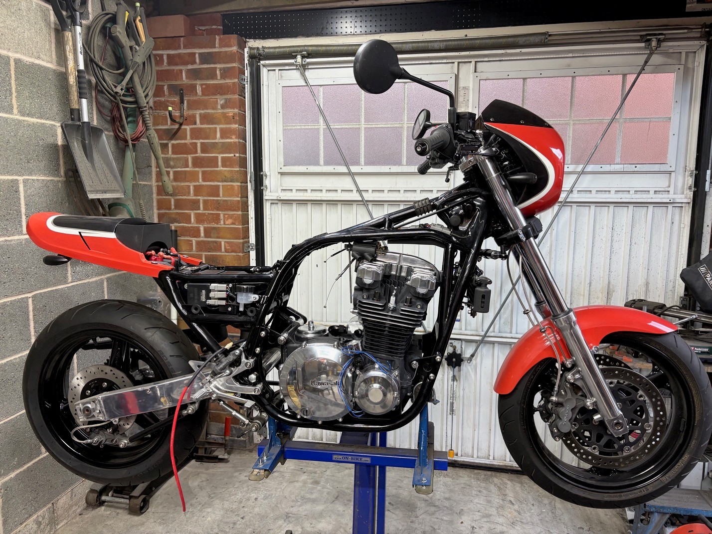

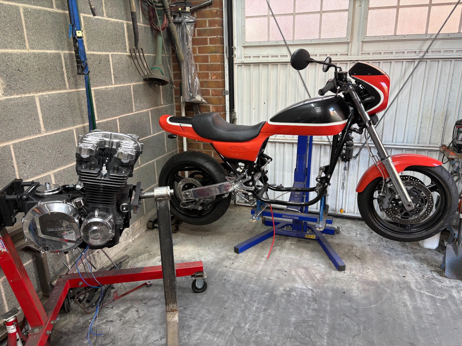

Friday was another "milestone" moment for my build, Quofan came over and assisted in installing the motor

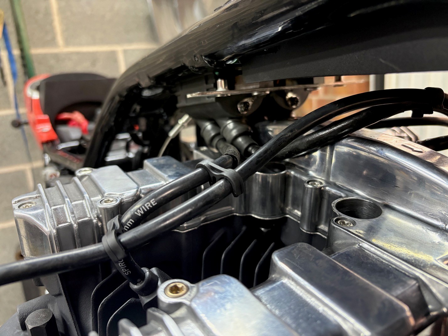

My engine lift did the hard work but it was invaluable having another pair of hands and eyes to jiggle it into place without damaging anything (huge thanks buddy) I think the motor has "swelled" in the hot weather as everything seems tighter than I remember when I took it out. The coils are much closer to the motor than I would like (the leads are sleeved with fibreglass heat shield) but after spending many hours on Saturday experimenting with different bracket configurations I have come to the conclusion that unless I want to get into a major rework (not keen at this stage) I am going to have to "suck it and see" how the coils react to being where they are. Yesterday was "fathers day" in the UK so the family were over for a trip out with the dogs and then a BBQ so I will be back in the garage tonight after work to press forward.

Looks very good so far, Guy! ( But i can imagine, that the coils are too cloose to the engine and the heat from it ???)
Anyway, you will find it out, i am pretty sure about...!
