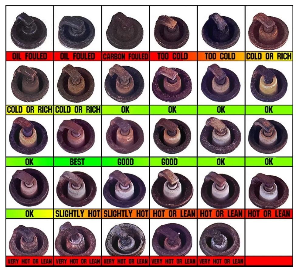

17 Jun 2022 03:30New plugs after driving around a little bit, this is after playing with the air-screw, so I dont know if it says anything

Plug looks a little better...I'm gonna say try moving up one slot on the needles. Maybe it's just getting the full amount of fuel too quickly. If not that I would try 102.5 mains, but I'm hesitant to make any suggestions that cost money.
You may be able to test my richness hypothesis by taking the air filter off and seeing how it likes that at higher throttle positions - it probably won't be happy at idle.

Then go for a run using higher revs. After a few minutes running 6k or above then immediately kill the engine and coast to a stop. Take a picture of the plugs colours and post them here. The plug colour will tell you wants happening at high revs.
