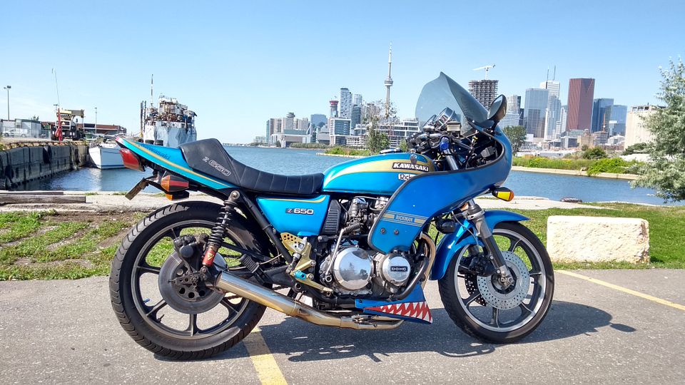

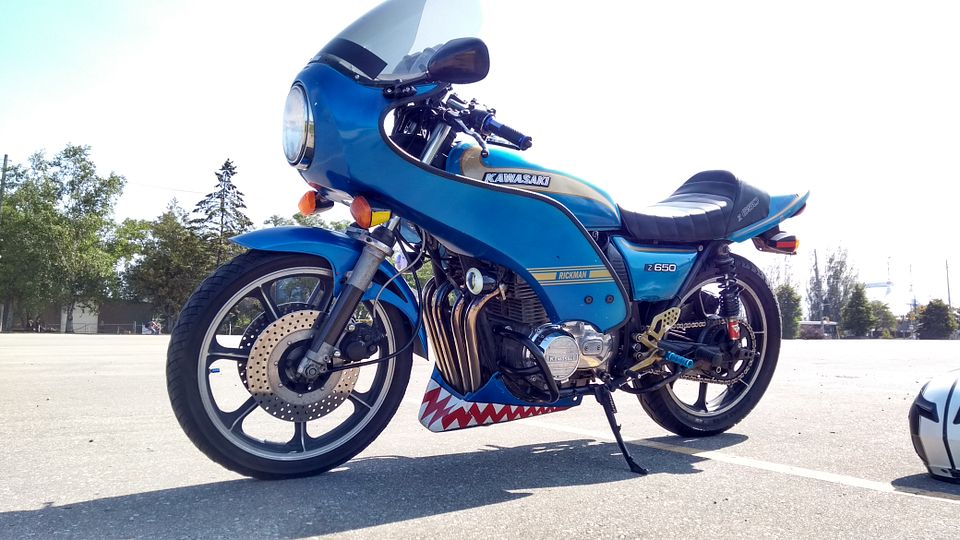

I've had a Rickman fairing on my 650 for a number of years.
Great wind protection.
Lower your head down behind the fairing and it's like your slipping through the air.
Do need lower handlebars, and cannot switch while the fairing is on to higher bars.

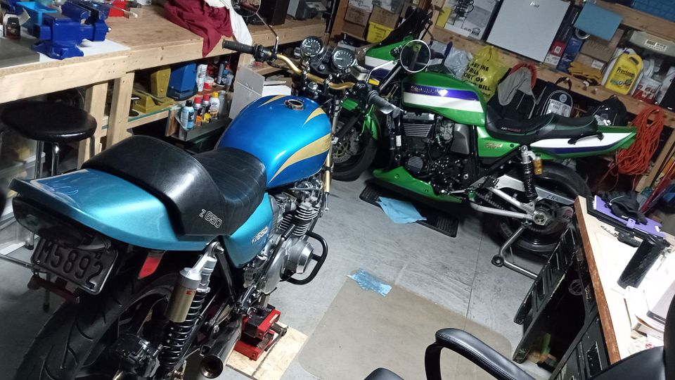

My fairing and a full set of bodywork has been at a painter buddies place for over a year.
Last season I rode without the fairing.
I found the low Clubman bars uncomfortable, so have put regular handle bars back on this Winter.
I'm having this gas tank painted to match the side covers and tail by another painter.
Headlight moved back to stock position, Renthal handlebars.
Have ordered a small 7" Cafe fairing as I'm thinking I'm going to like the higher bars.
