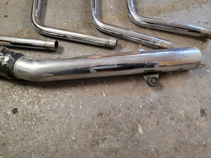

The exhaust:

Regarding the exhaust, does anyone know the make/model?

Hard to say... except is a left side exit, making it kind of unique. European??

I'm from Norway, so I guess it's european. Could be from all over the world though, the bike has had several owners before me.
Looks alot like that alfa/alpha exhaust, but doesn't have the same "bend" where the header pipes meet the muffler
The only thing I know for sure is that this exhaust doesnt use the standard exhaust "collars". The flange is built into where it mounts to the cylinder.

Looks like an Alpha exhaust system to me but I am not an expert on them. You do appear to have the longer rear fender that was stock in the EU. You also appear to have some nice shop tools as well.
