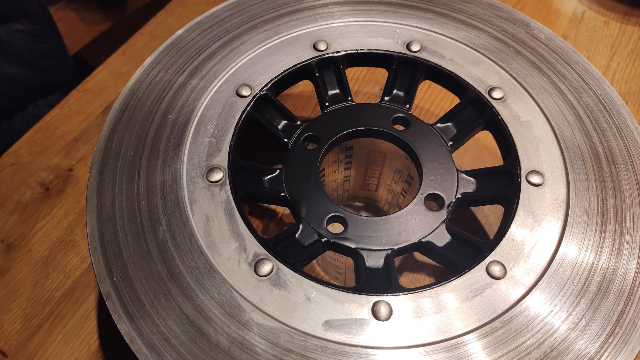

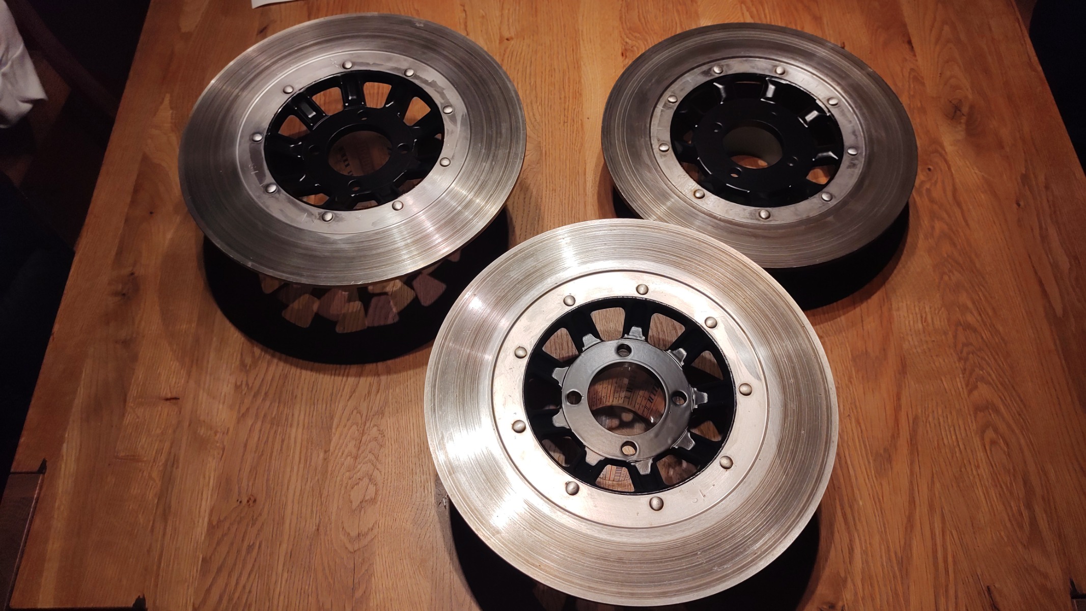

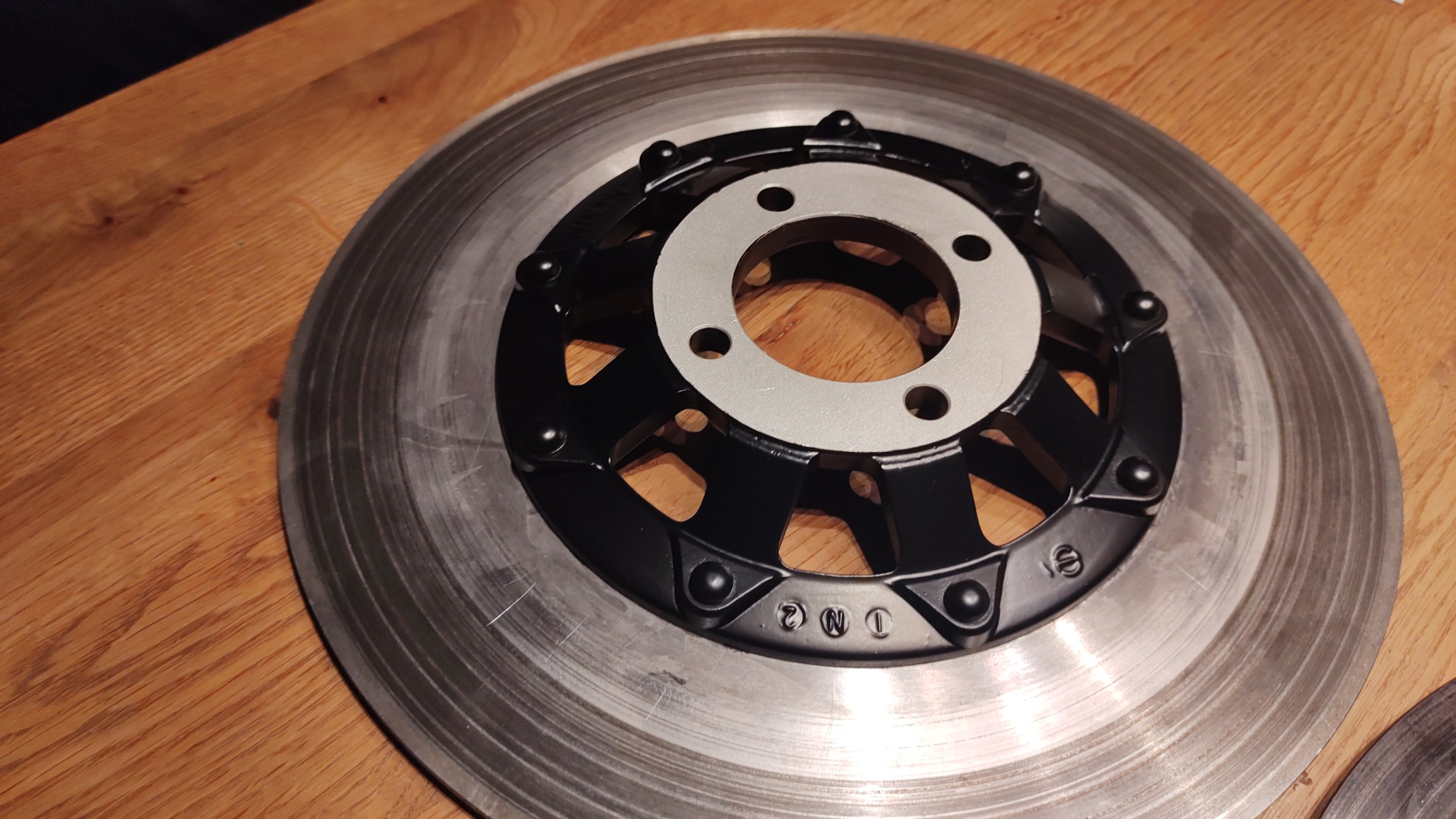

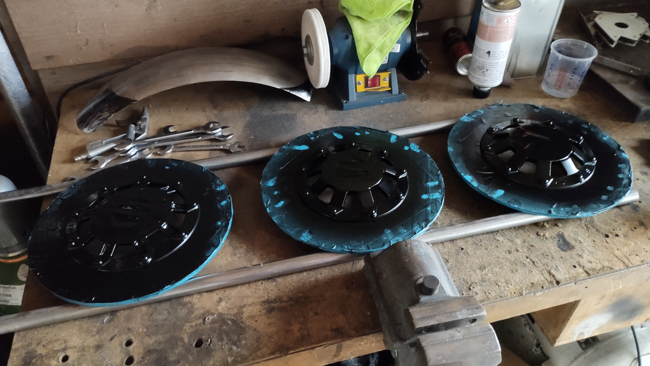

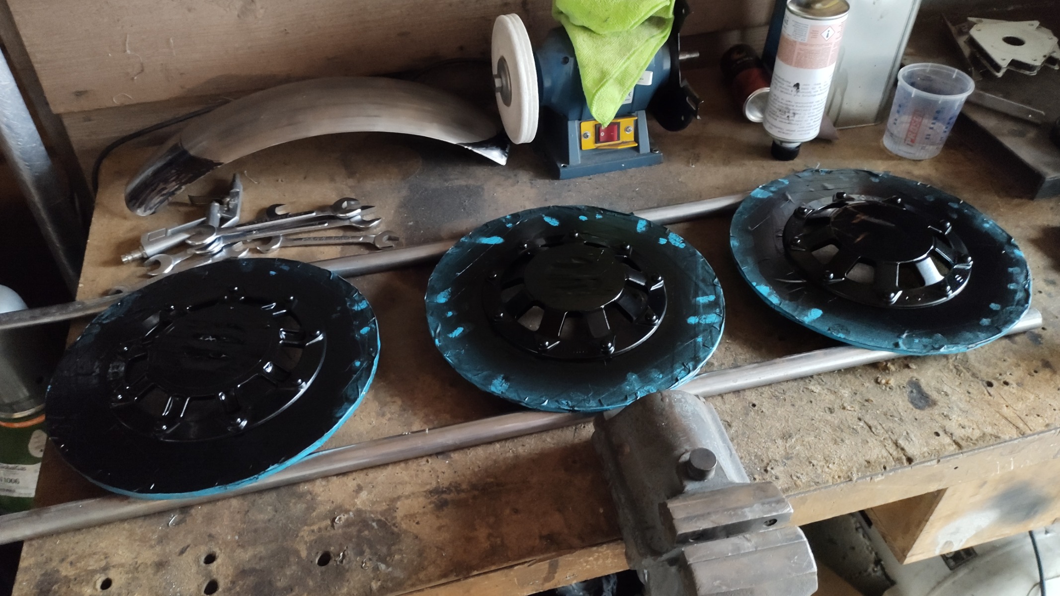

While I'm waiting for the carb dip I decided I should get around to painting the brake rotors. Then I can just put everything together when I get back from my trip home over Christmas. Still need to order the rebuild kits for the master cylinders and calipers, but they have been put aside for me so there will be a nice pile of stuff to assemble when I get back.
It's about 5°C out in the carport so it was slow going with the spray gun. I got through it without any major incidents - just a bit of pooling on the back of one of the discs. Pretty sure you'll need a torch to see it when the discs are back on the bike.
Still waiting for them to dry enough take the masking off:

- Posts: 6878
- Thanks: 4330
Re: KZ1000A1 Spare Parts Project
07 Dec 2022 11:13
- calum
- Posts: 1144
- Thanks: 415
07 Dec 2022 11:15
Mounting surfaces are all masked up. No worries there.

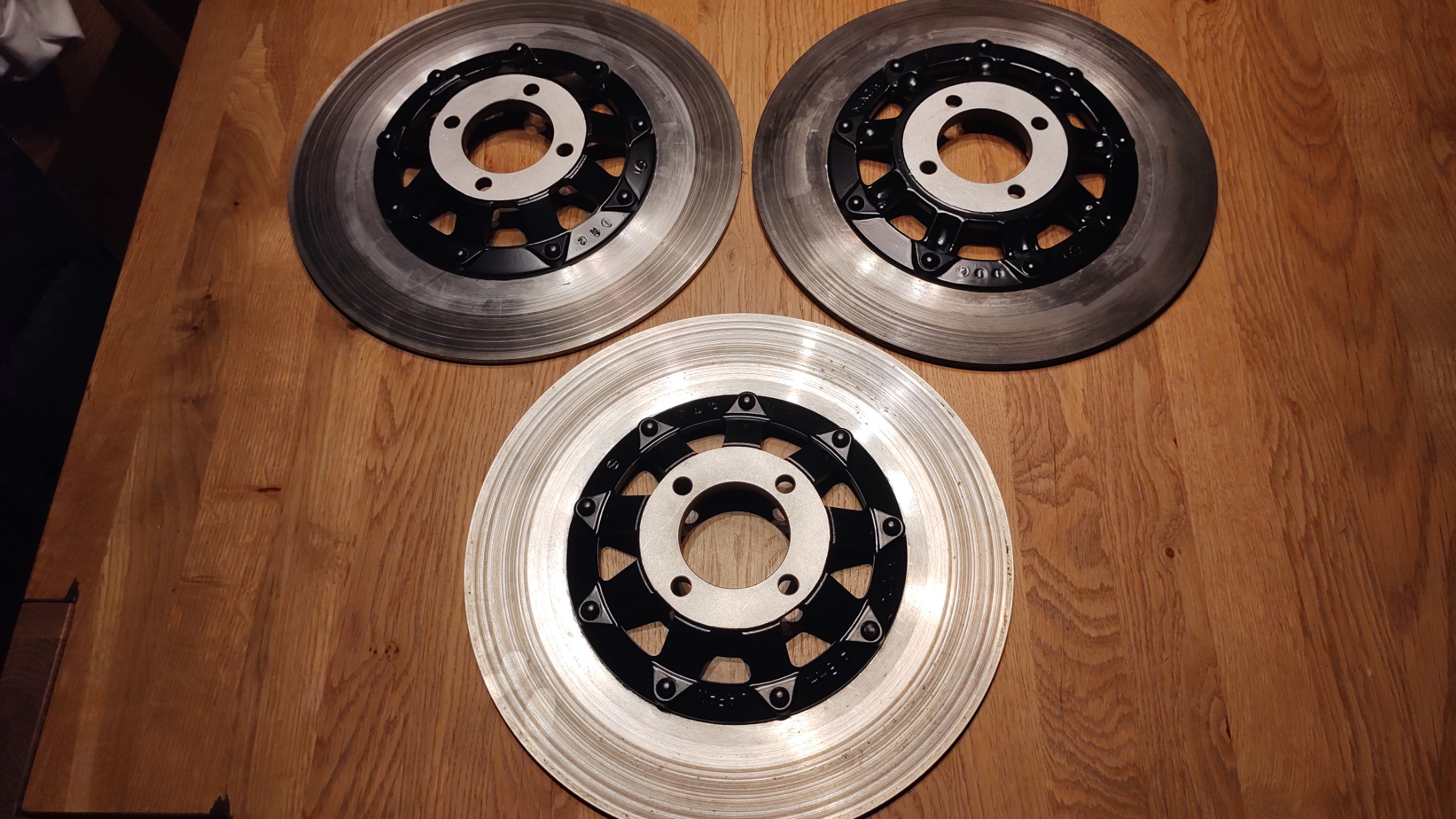

Bought them inside out of the cold - paint was never gonna dry outside. You can see some pooling on the mounting surfaces. They were facing down when I left them to dry and the paint stayed wet for too long. When it's this cold it's so hard to get enough paint on for a decent finish and not have it run. Thankfully none of it will be visible when I get them bolted to the wheels.

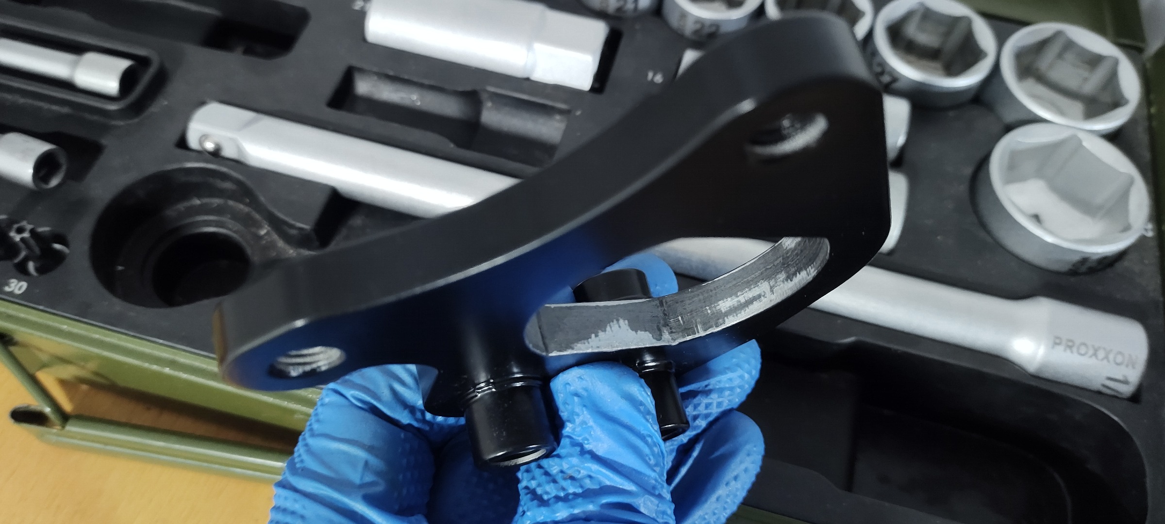

Have been working on the brakes - no pictures though as the light in the garage has been bad. I have pretty much sworn off powder coating after all of the sanding I have had to do to get things to fit. The last bit was on the brake caliper mounts. The pads didn't fit in the cutout so the coating had to go. I'm a bit worried it might rust now - although it should get coated in brake dust pretty quickly which might protect it. I guess I'll pull them apart next winter and see how they look after a season.
