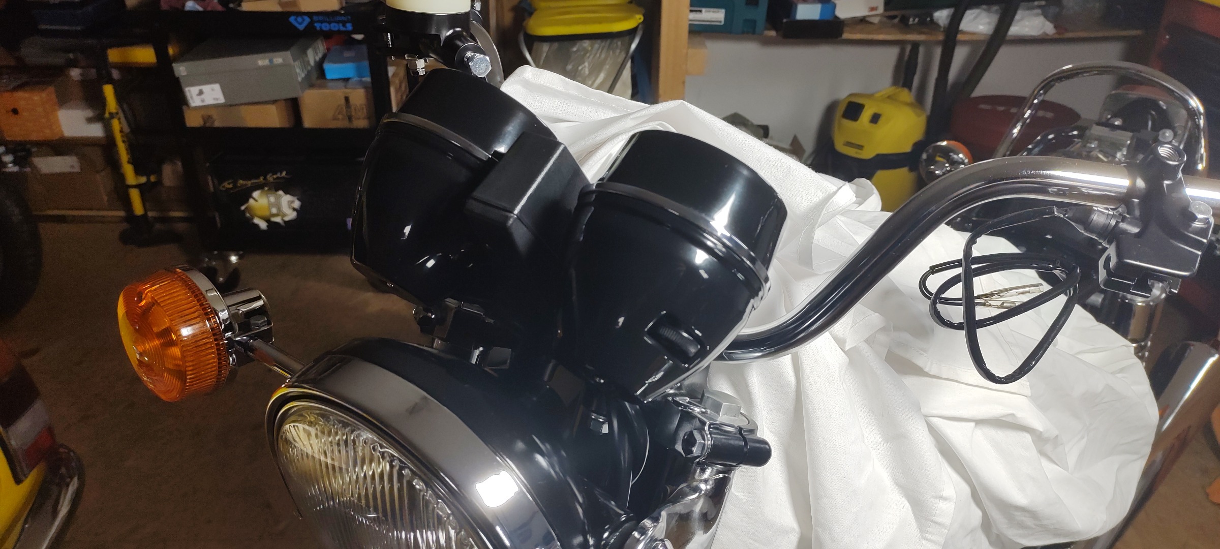

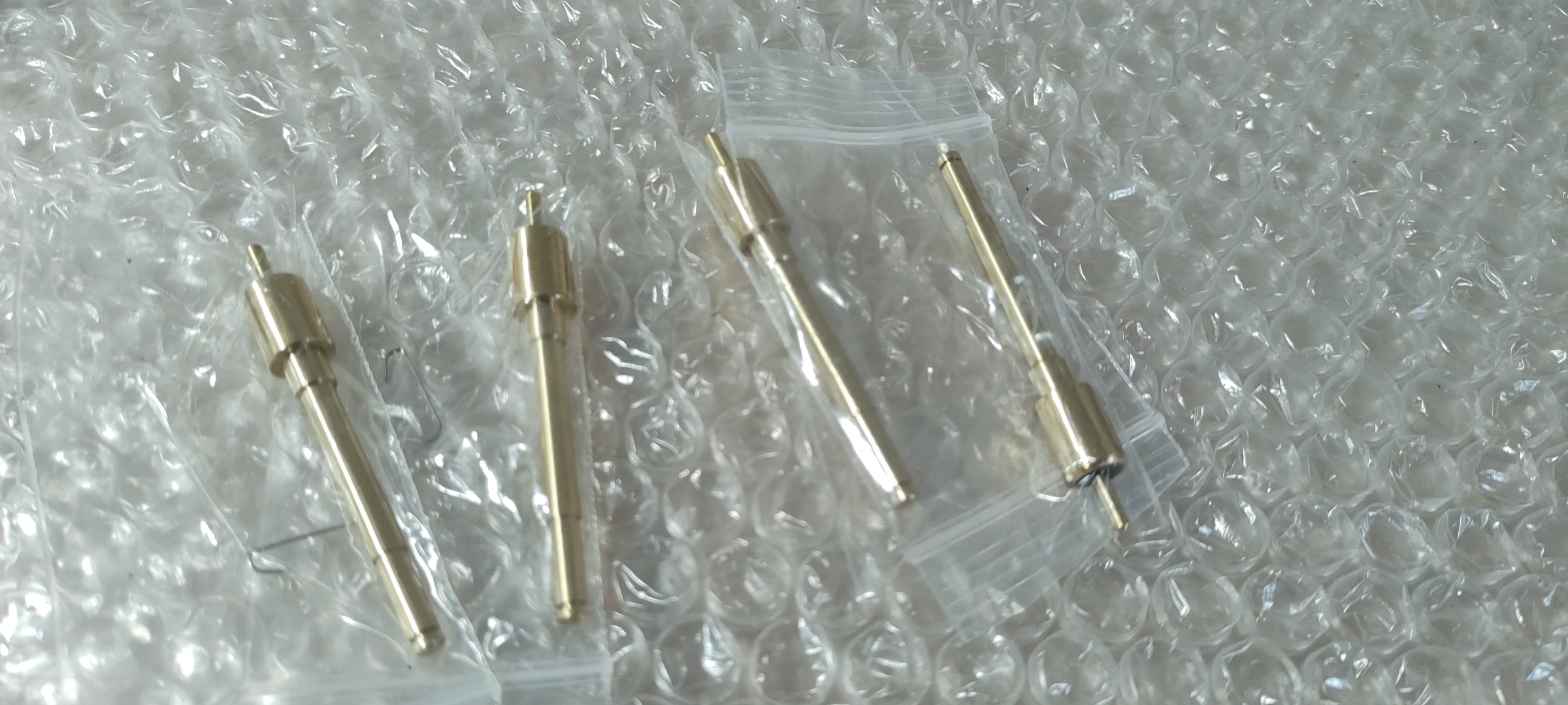

Got my choke plungers back from zed1015 this week. Looks like excellent work, but they're still in the bags until the rest of the parts are back from the platers. Got some rubber glued to the instrument bracket, so the clocks are properly installed now. At some stage I'll have to take the tach off and swap out the base plate - the threads on it must have been pretty far gone and all it took to ruin them was just a little bit too much pressure from my heavy hands. Unless somebody has a good fix for external threads I'll be sending it off to get replaced (will cost $25 for the ring and $25 for installation - not too bad but still...).
EDIT: I think I'll just shorten the threads and screw on some extensions that replace the spacers and have an M5 thread on the end. Will get onto the lathe and then post some photos.

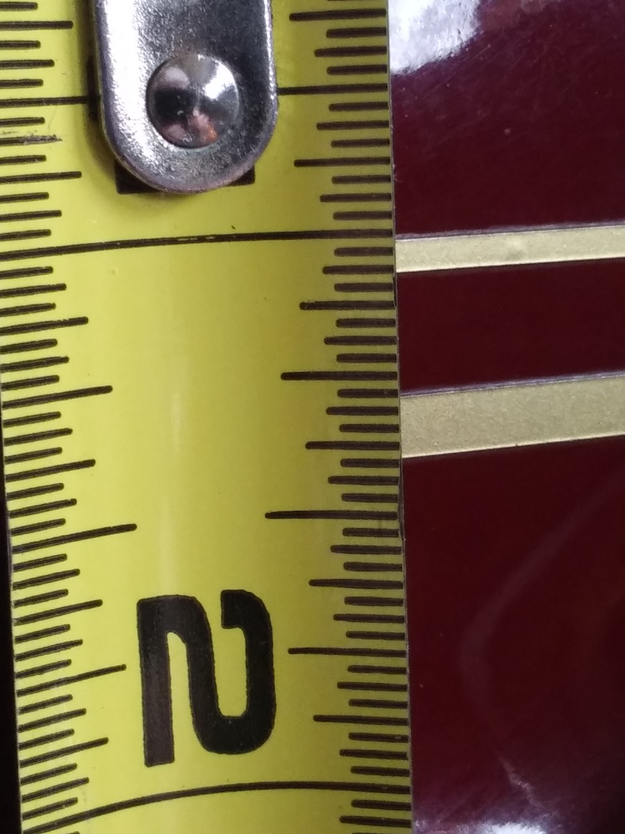

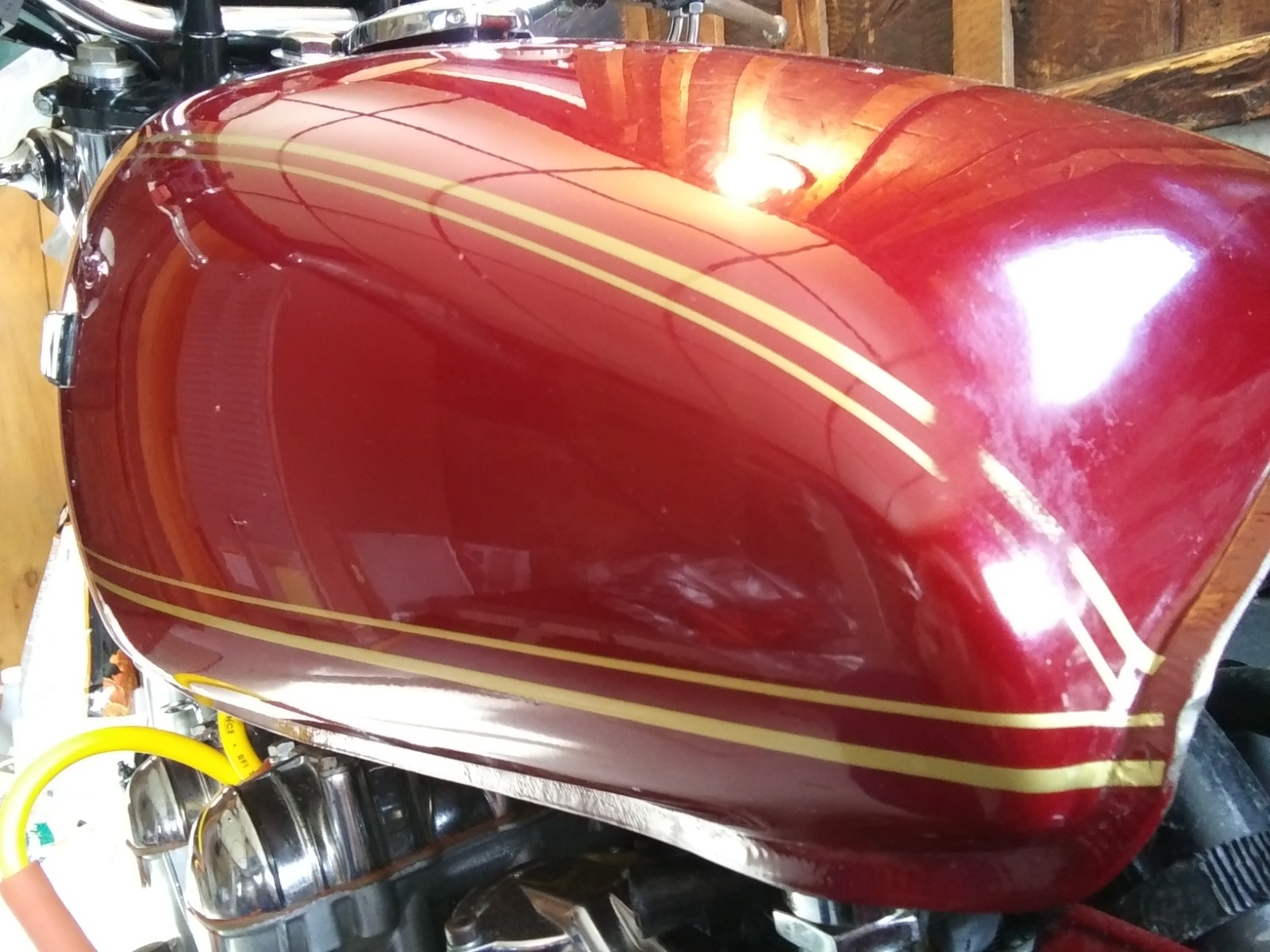

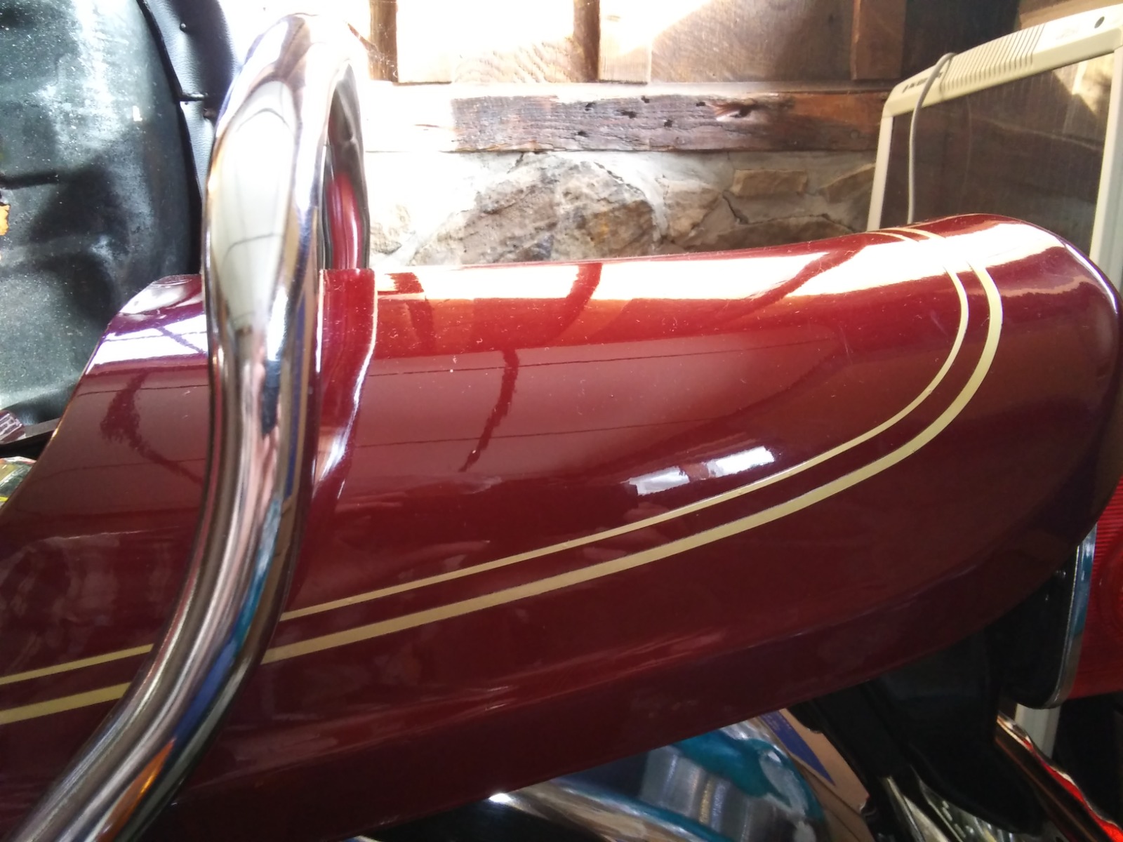

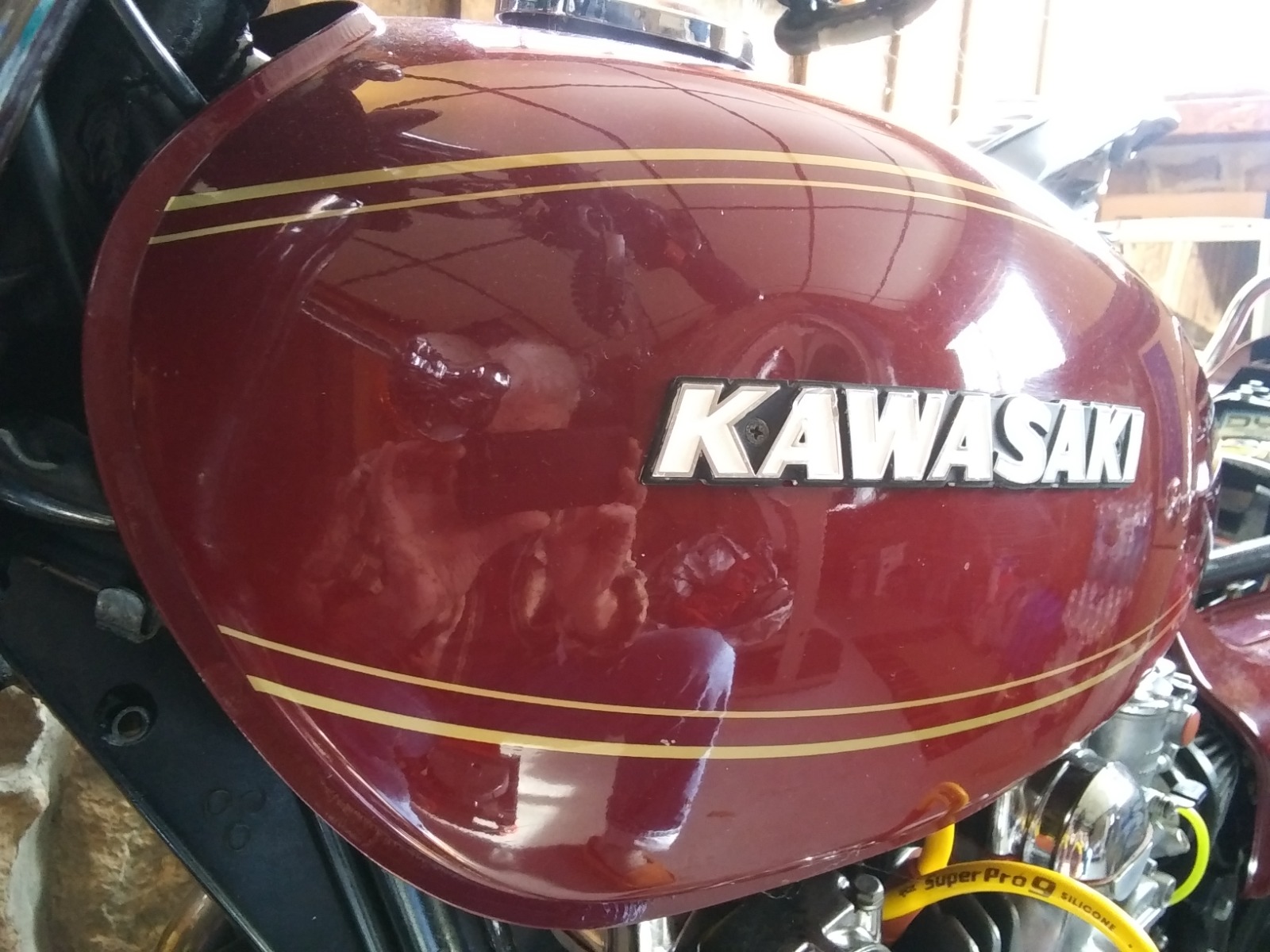

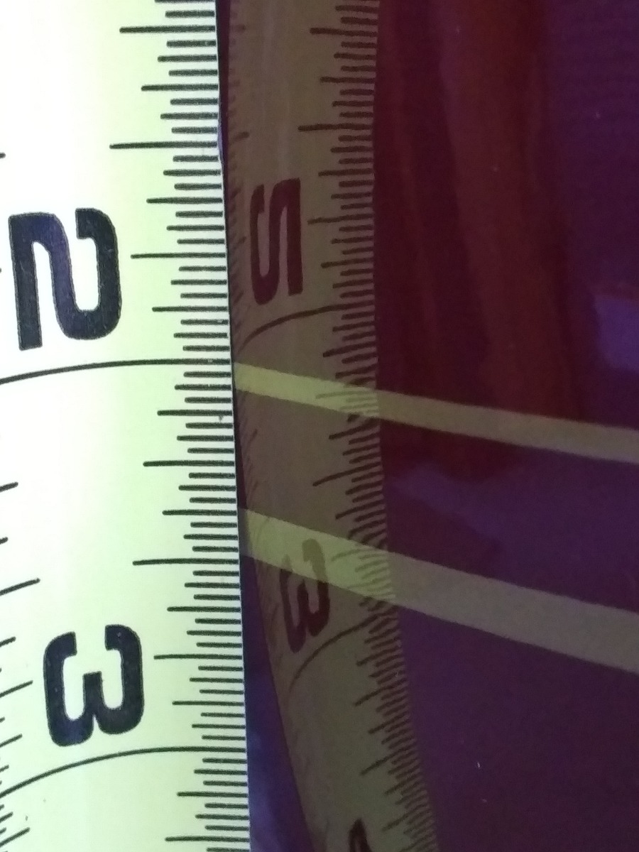

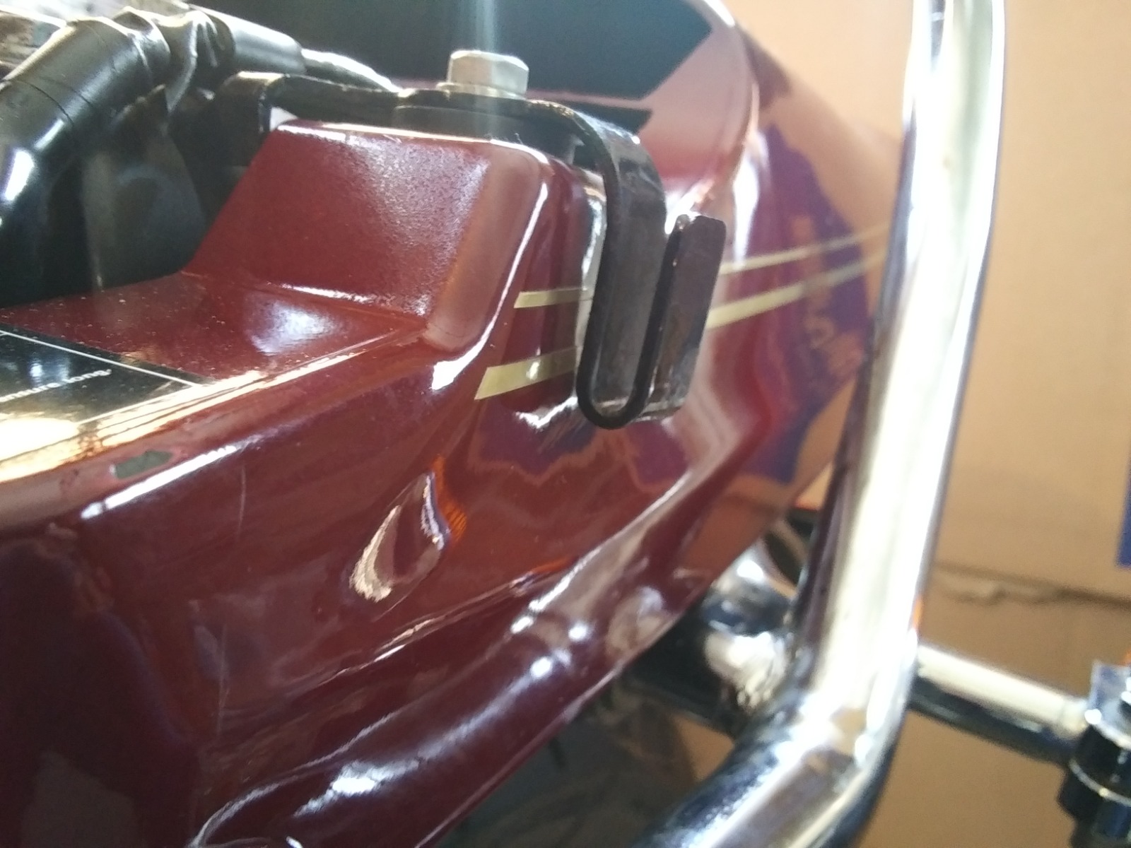

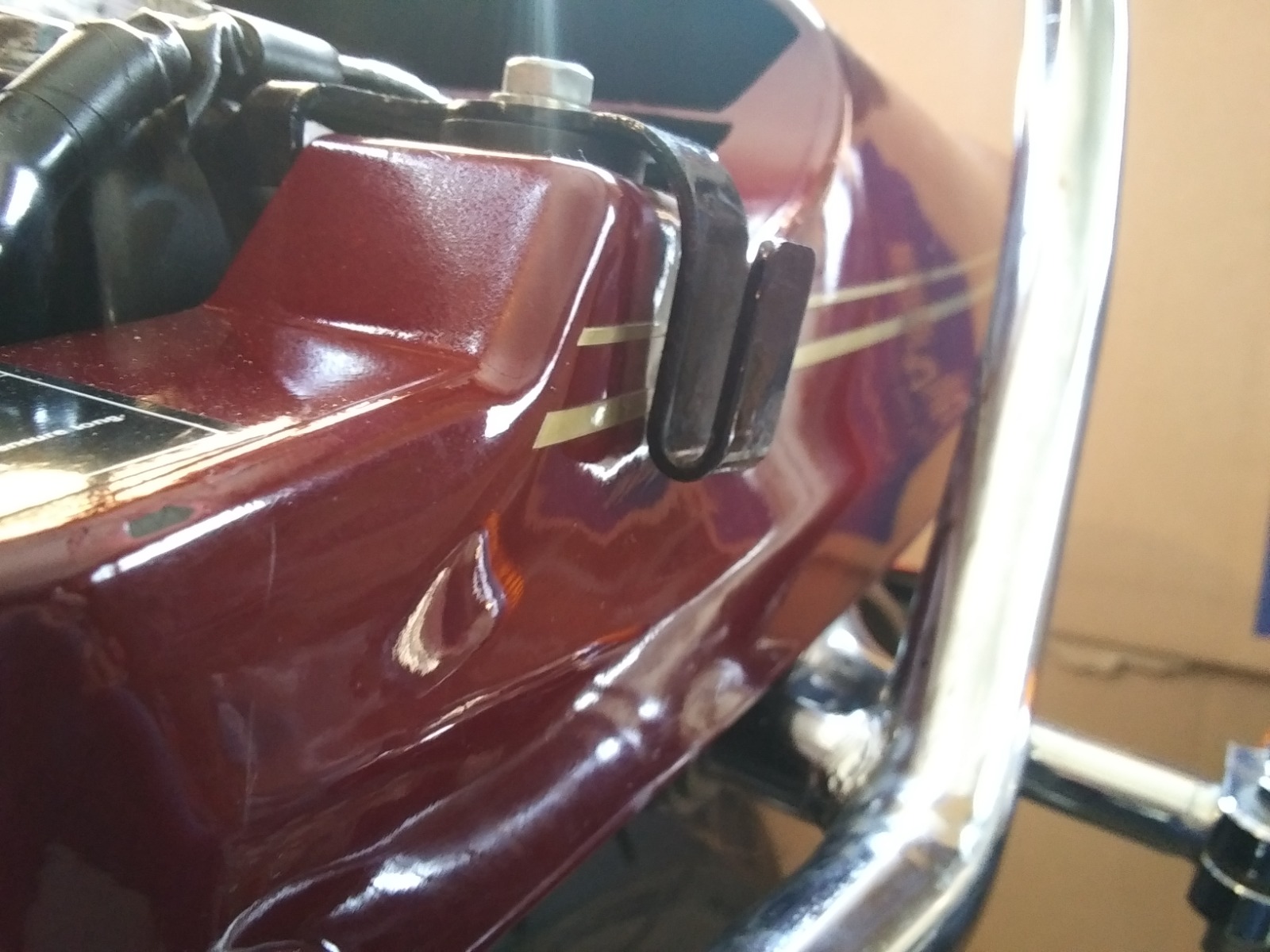

Installed the cams today - although it looks like I'll be moving them both one link forward on the cam chain tomorrow. I'll also need some larger shims - should all be in the 2.60-2.80mm range.
On another topic: can anyone with an original KZ1000A1 paint job measure the width of the stripes on the tank and tail? I've seen all sorts around and would like to get as close to stock as I can. Some photos/measurements for positioning the stripes would be great.

Re: KZ1000A1 Spare Parts Project
04 Feb 2023 14:34
@ Calum. My 77 KZ1000A1 has original body and paint. I will try to get a ruler app for my phone and take measurements and pics and post asap. If there is any other way to accurately take those measurements,(without an app), let me know.
05 Feb 2023 11:58 - 05 Feb 2023 13:03
The ruler app was a fail and all I had was a tape measure, so I don't know if these will help. #1 the tail stripe and piece.#2 the tank stripe and side view. I'll try to get spacing measurements later.
06 Feb 2023 11:42
Thanks for the photos! That should pretty much have me covered... now I just need the patience to take my time and make a good job of it.
