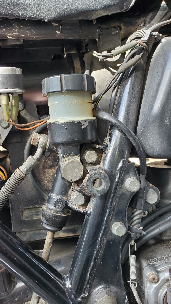

Finally getting the brake calipers ready to send off to the powder coaters. Does anyone know if the rear master cylinder on the A1 was painted or not? I've seen them in black and also just blank aluminium.

I thought they were painted black on the A model, since the bottom of the rear MC was visible below the side cover. The rear MC was natural on the Z1R as it was hidden behind the larger side cover. The FSM shows a black painted rear MC in the '77 A1 disassembly section.

Yep, black master cylinders matter!!!
