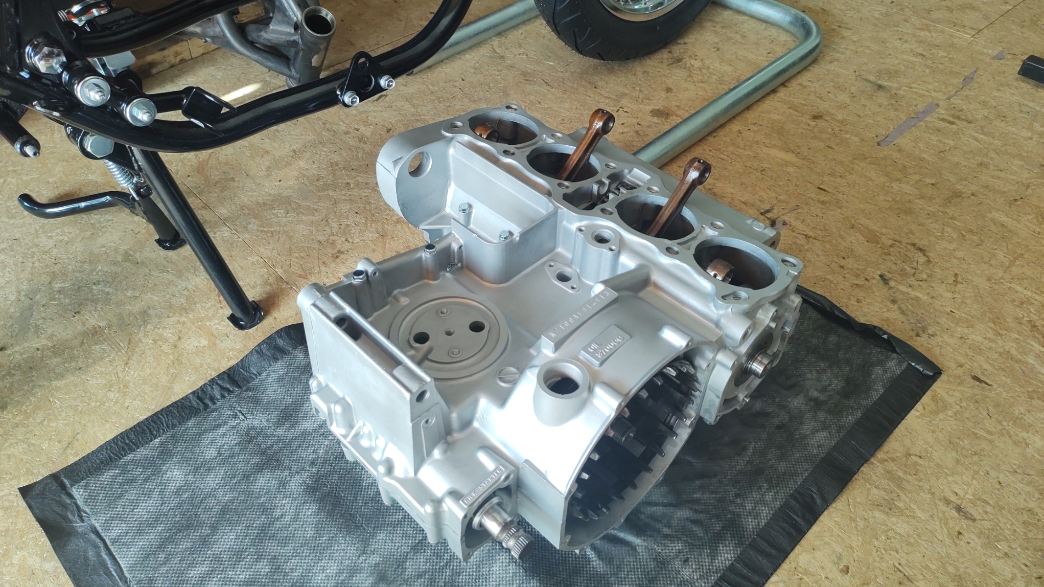

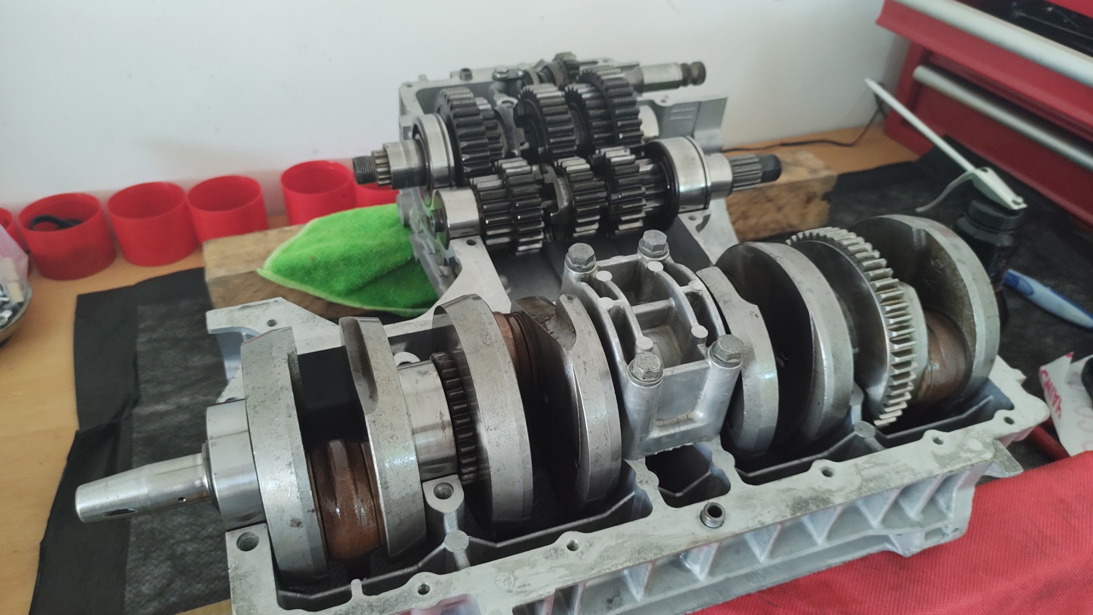

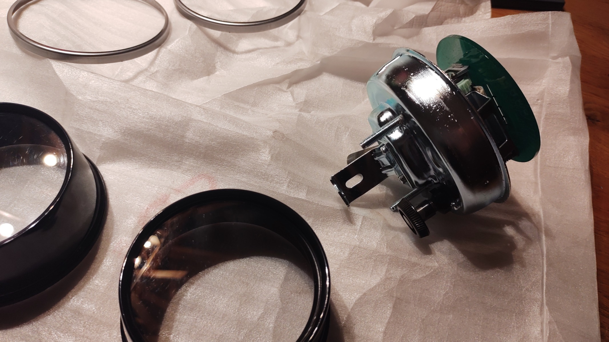

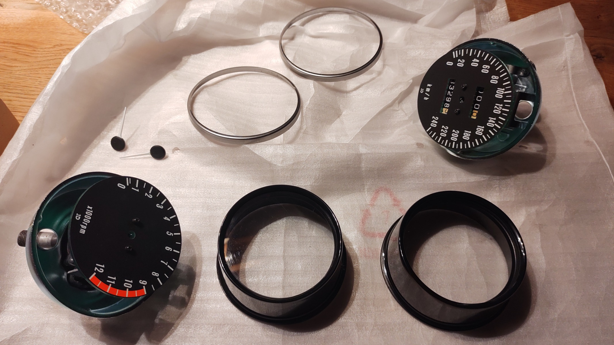

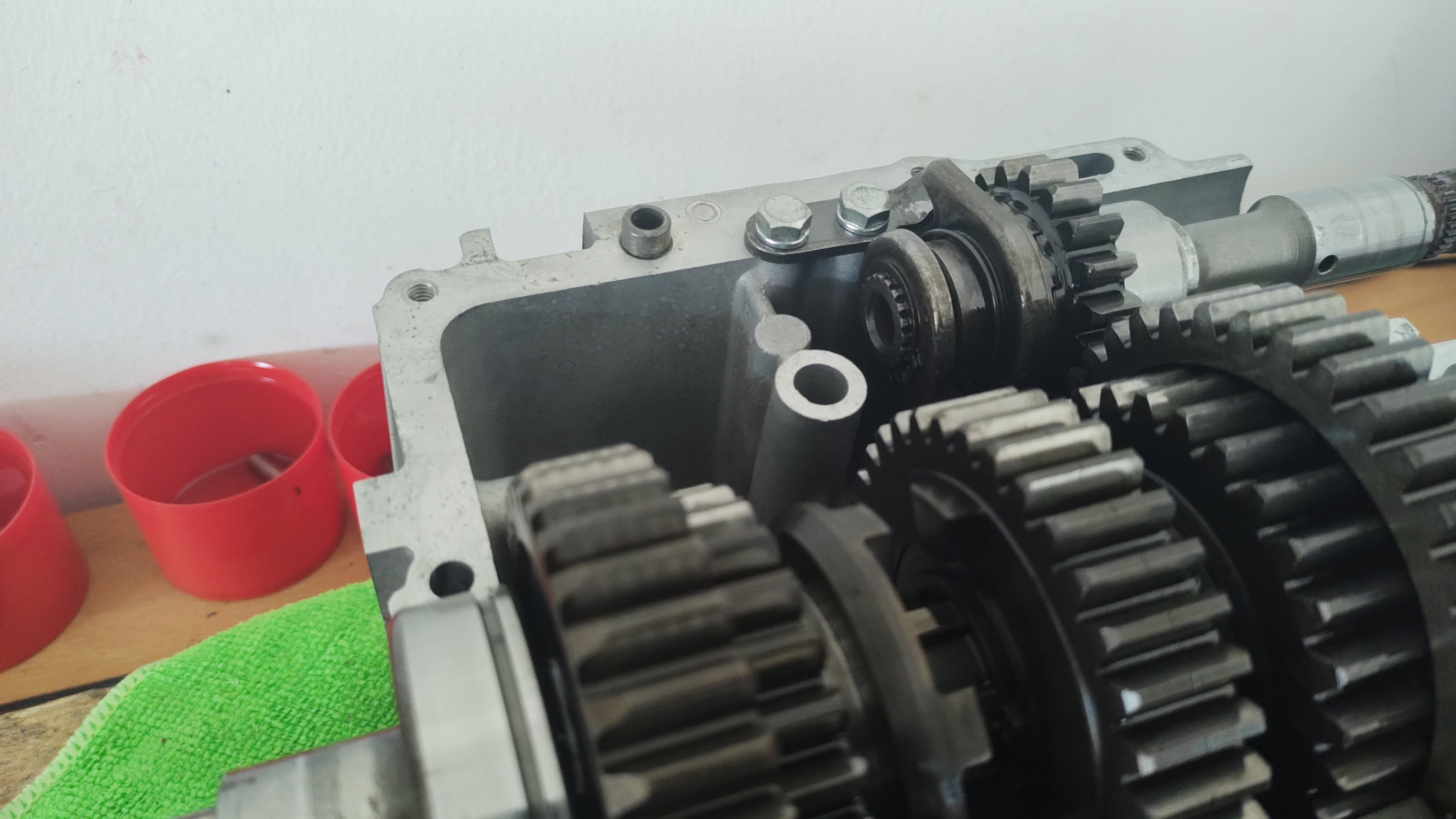

Been pretty busy and haven't updated this in a while. Got the clocks sent off to get calibrated and have the damping fluid renewed. Started work on the engine today. Cylinders and head are with a local guy getting sorted, but am starting to get the bottom end together.
Sorry for the bad lighting on the first couple of photos.

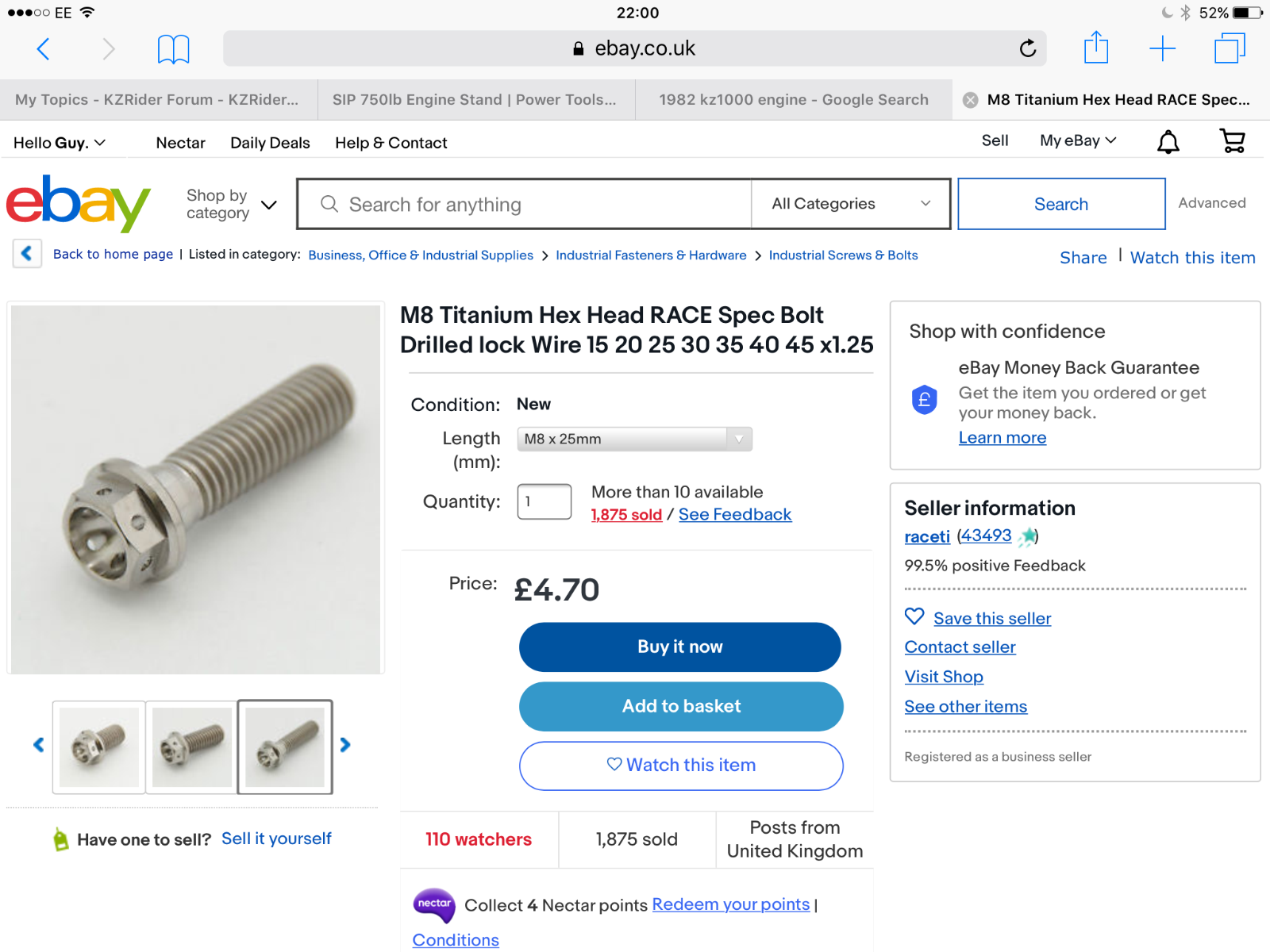

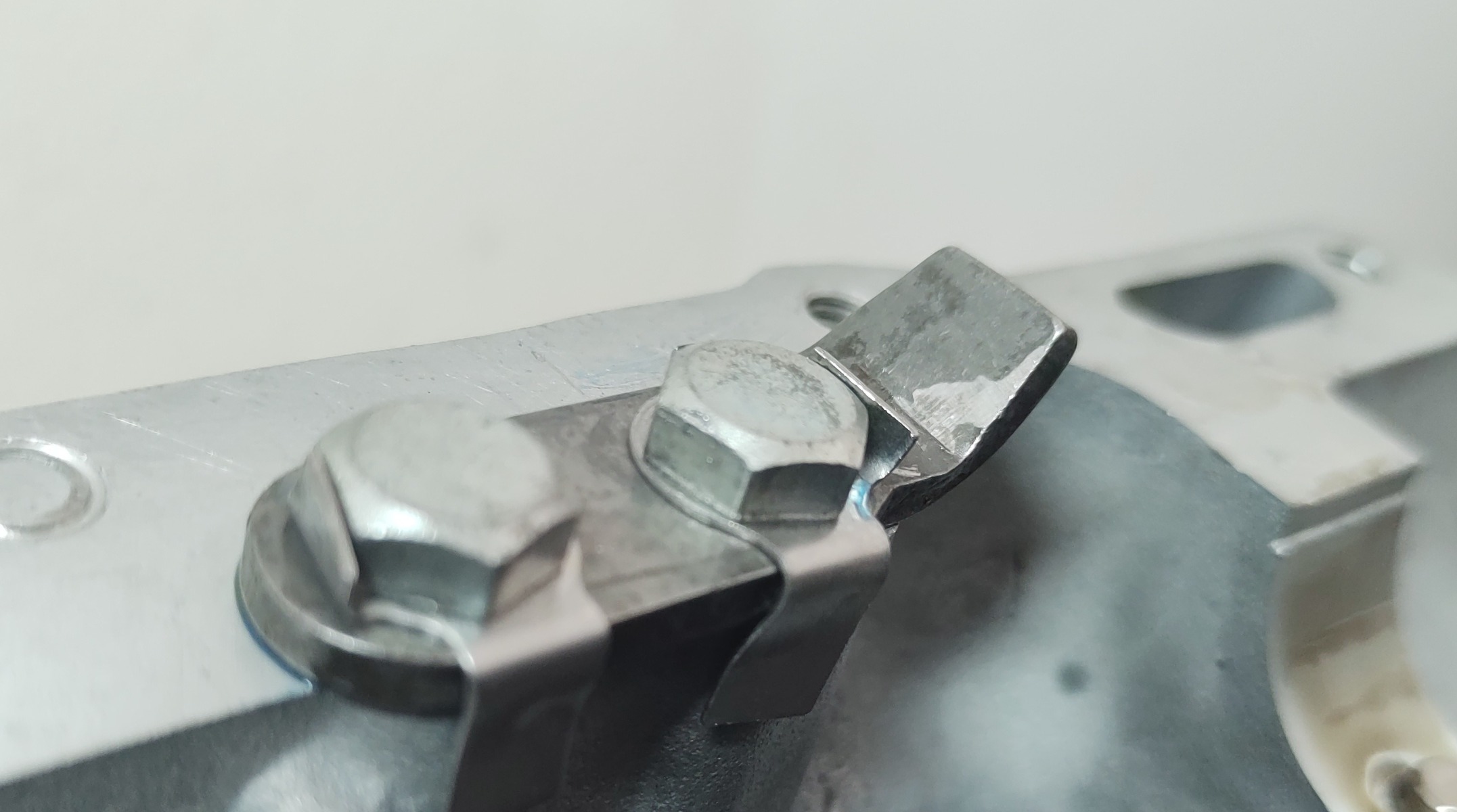

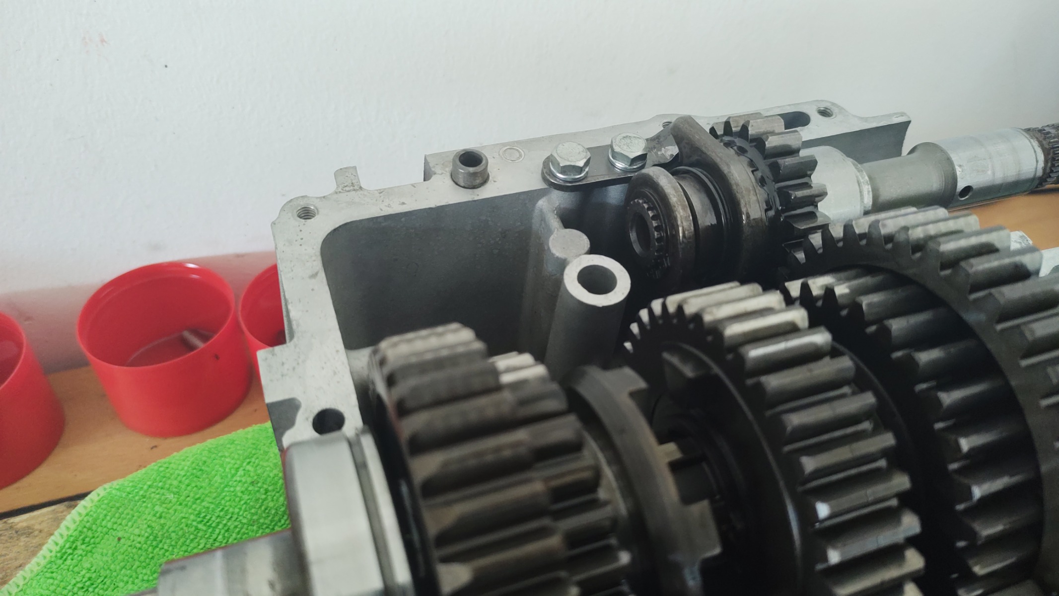

Haven't got a decent lock washer for the kickstarter stopper so used spring washers and loc-tite. Had to take them out again as the left screw in the picture sat up too high and touched the bottom case. Don't want to pay $30-40 getting a lock washer sent from the States (can't find any in Europe) so I'll get some standard DIN 463 ones and see how they fit.
Could you use lower profile bolts with out the spring washers but with the "loc-tite" then drill and lockwire them ?

Got the lock washers today and used them with some loctite - there's enough clearance for the kick-starter so I'll just stick with them. The 79 and on models just use loctite - so I guess they deemed the lock washer unnecessary.

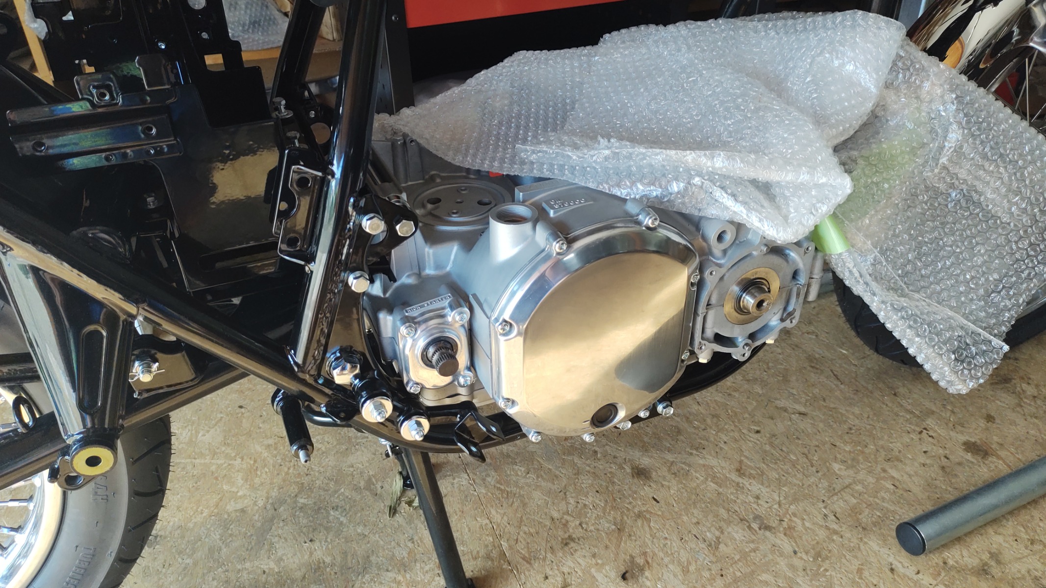

Bottom end is back in the frame. Clutch isn't reassembled but I wanted to see how my dodgy polishing job on the cover turned out - OK as long as it's not in the sun

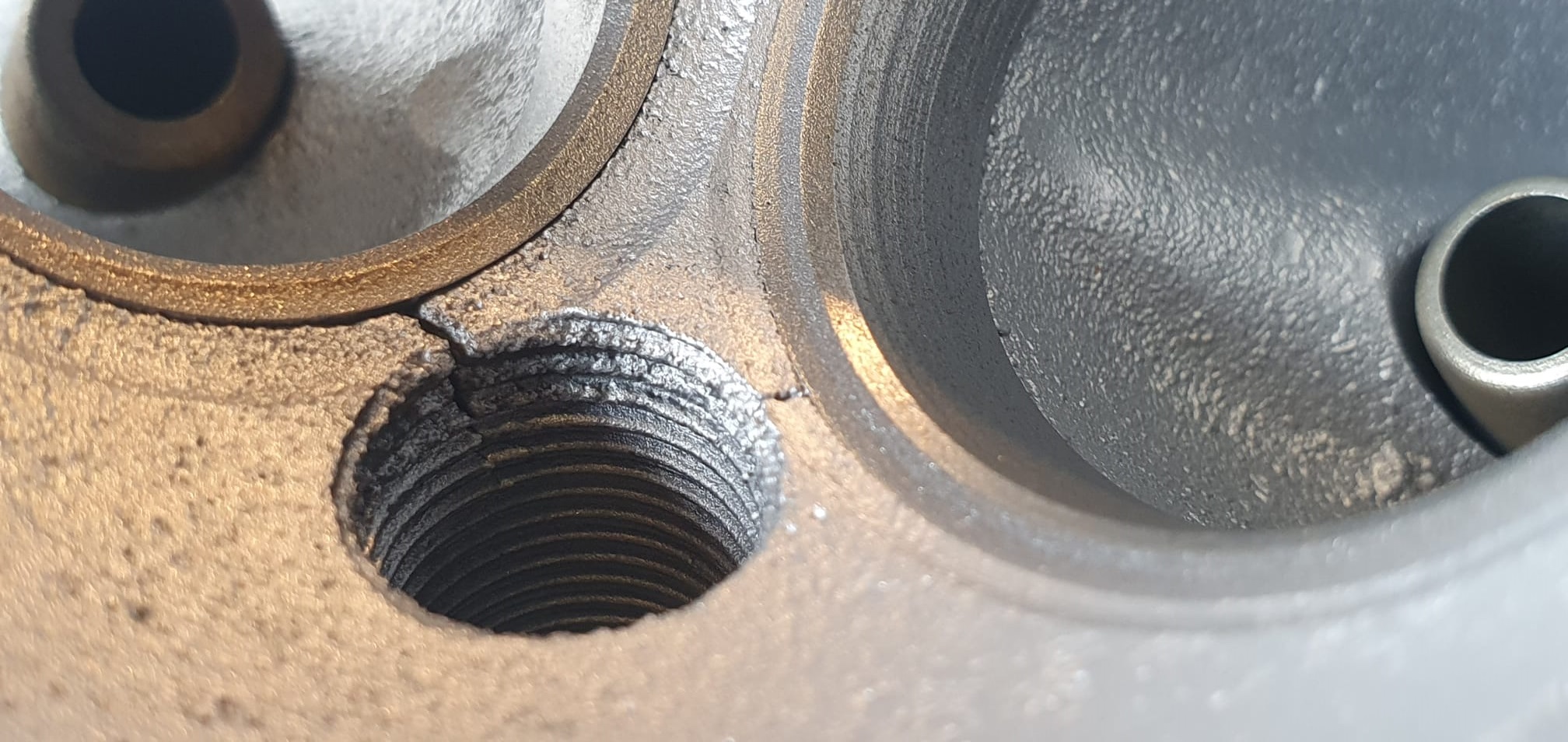

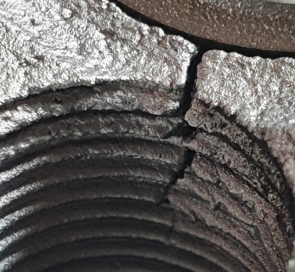

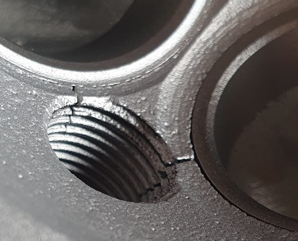

Got some pics back from the engine guy. Will only cost about €100-150 to get the cracks fixed so I'll get it done just for peace of mind. He grinds out the crack with a dremel, gets it laser welded and then uses the remainder of the threads to tap the weld.

Thats a decent price for the job and like you said "for the peace of mind" but also that camera he has.. wow i thought he was going to zoom into the molecules next.
