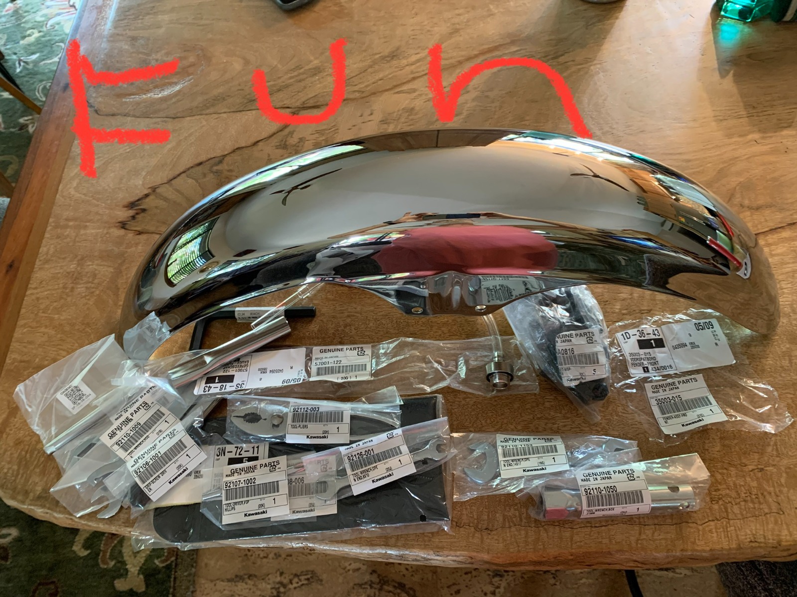

I'll bet those fenders were pretty pricey!

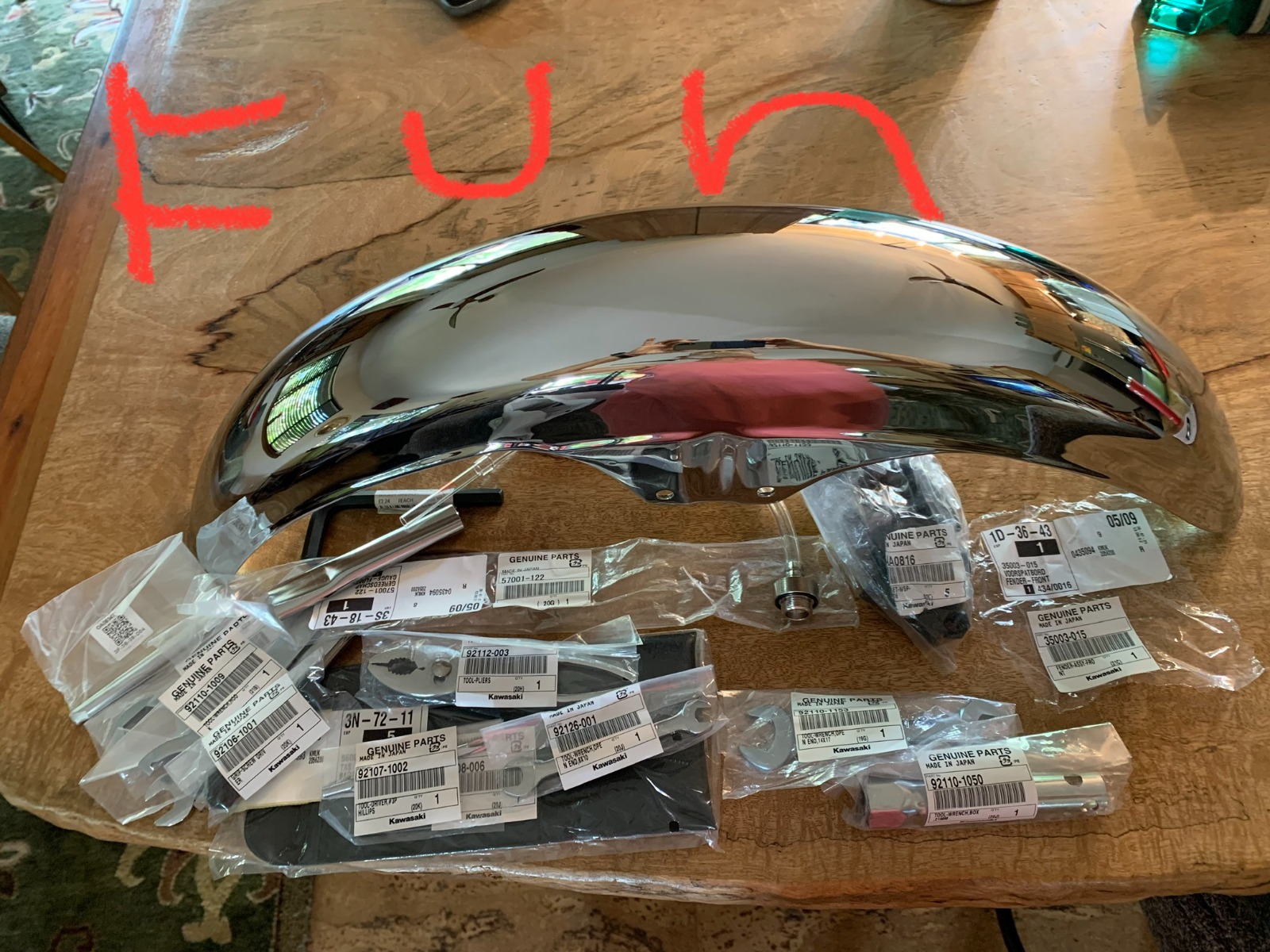

Yes, they aren't here yet, I'm anxious to see them. This Z1 is a pretty low number bike built October of 72, I feel I should do the best I can to make it pretty stock or NOS. I'm not sure if I'll sell it when it's straightened out but either way I want it to be a good example of an early Z1 in case I decide to sell. These bikes have gotten somewhat rare, they are worth saving as close to original form as practical. The Z1 and the CB 750 pretty much set the standard for others to follow. The Z1 was a real beast but the CB 750 was first. When I'm done I'll have an example of both, pretty cool.

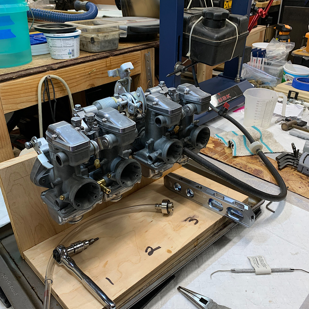

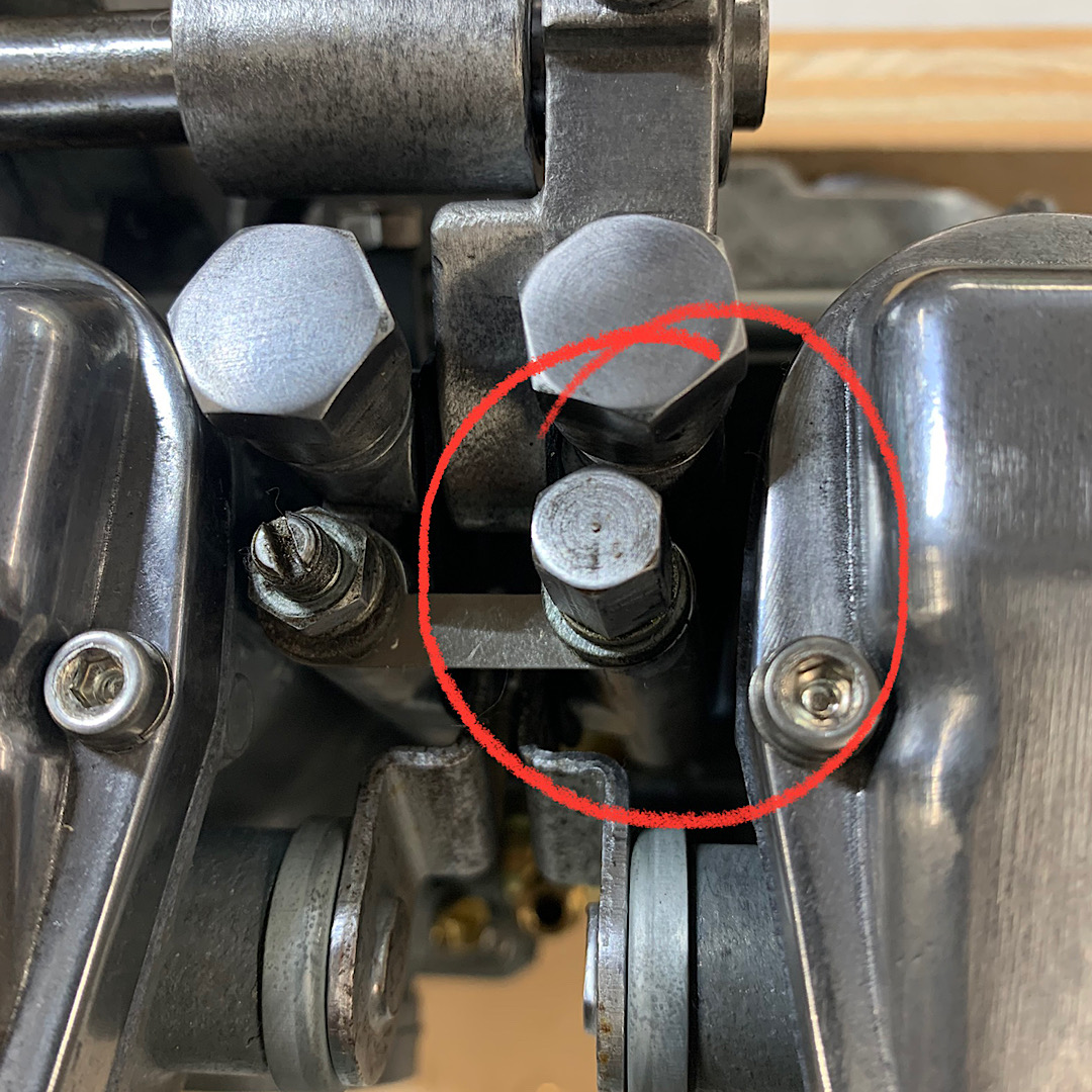

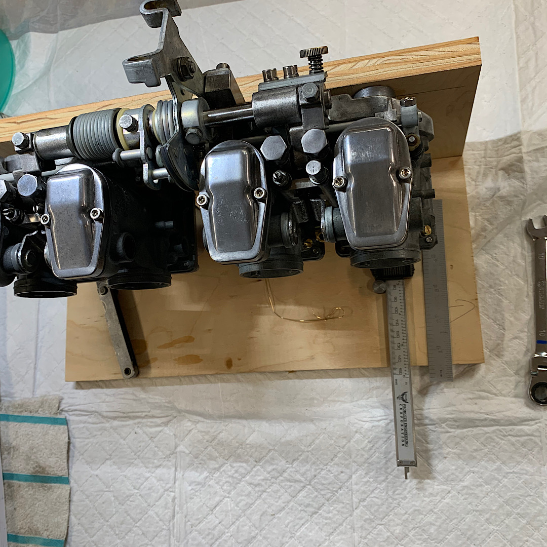

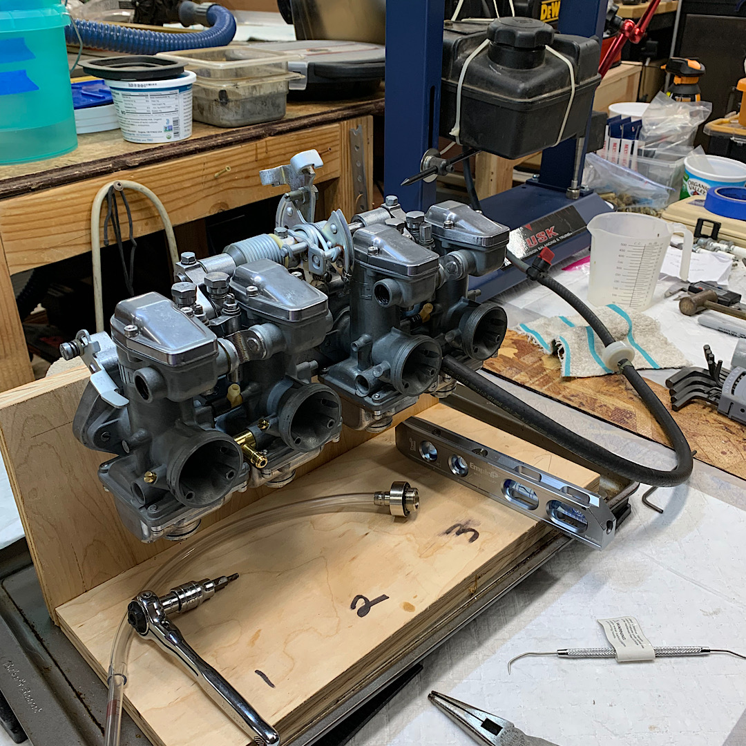

31 Jul 2021 06:58The carbs will come off again after I run it and then take it apart. Right now I am bench synchronizing them and my shop manual is not like my carbs. The initial setting of the slides requires a .6 to .7 mm space between the notch in the bottom of the slide and the throat. It implies I can adjust all 4 carbs this way. I seem to have a set where the number 4 carb is a fixed setting and the others are adjusted (initially) to match. I included a photo or two. You can see that number 4 has no adjustment screw. The gap under the slide is fixed and is about .5mm. I do not have a drill bit that small but I do have my wife’s silver and gold filled wire. I got a piece and carefully flattened it to make a go gauge. All 4 set now, next step is clear tube check for which I made a little stand.

Got some stuff!! The front fender looks very nice, as far as I can see the only thing that identifies it as NOS is how nice it looks and the label that was on the plastic bag that was around it, I'm saving the label. There are no build date stamps on it that I can see. My clear tube tool came too so I'll get after the carbs.

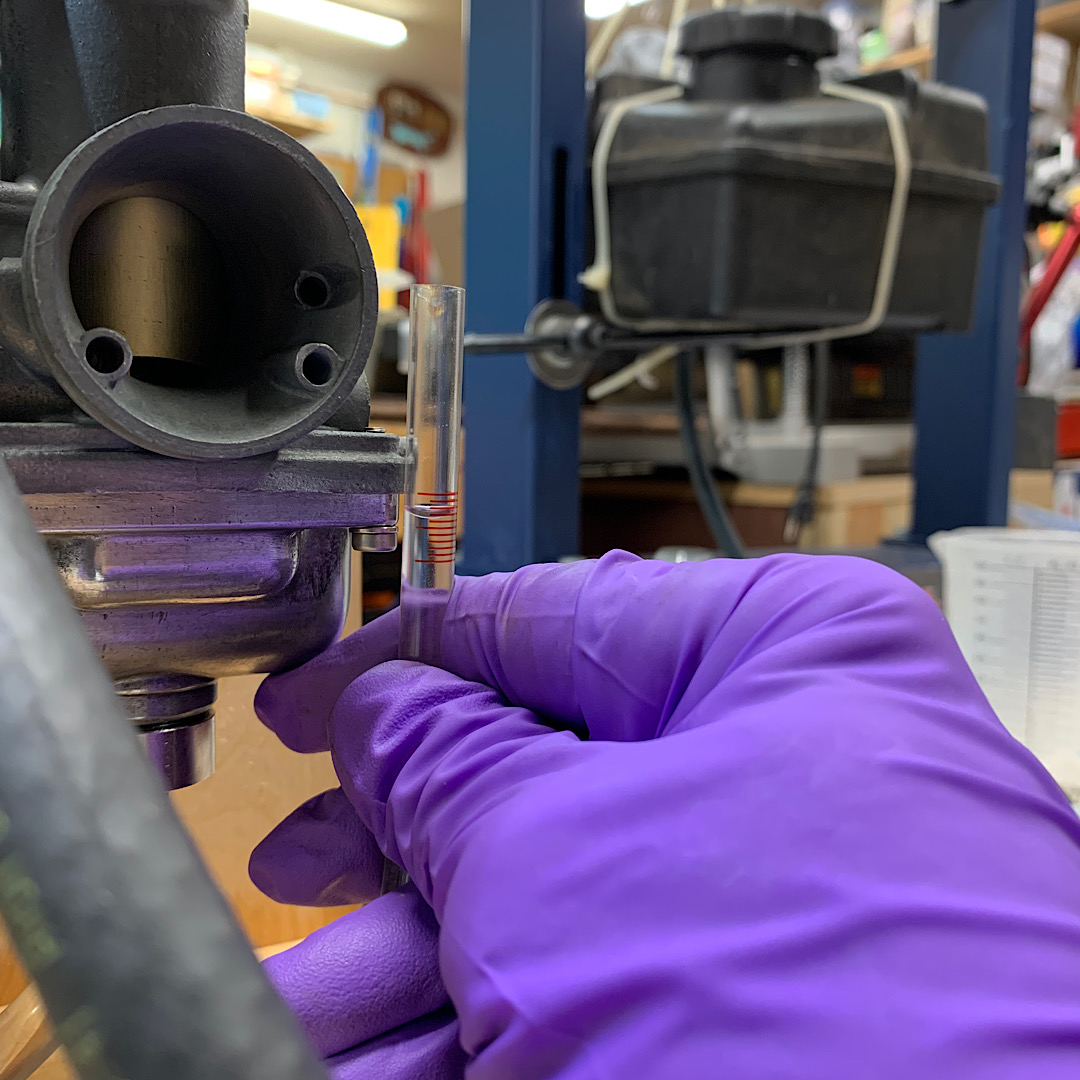

I did the clear tube check on floats today, #1 was a little low, took one try to fix it. It was easier than I expected. Maybe it runs tomorrow.
the meniscus in the tube is pretty big, have to look at the bottom of the curve.

I like your carb test setup. Can you show a photo of how they hang off the back wood piece please?
