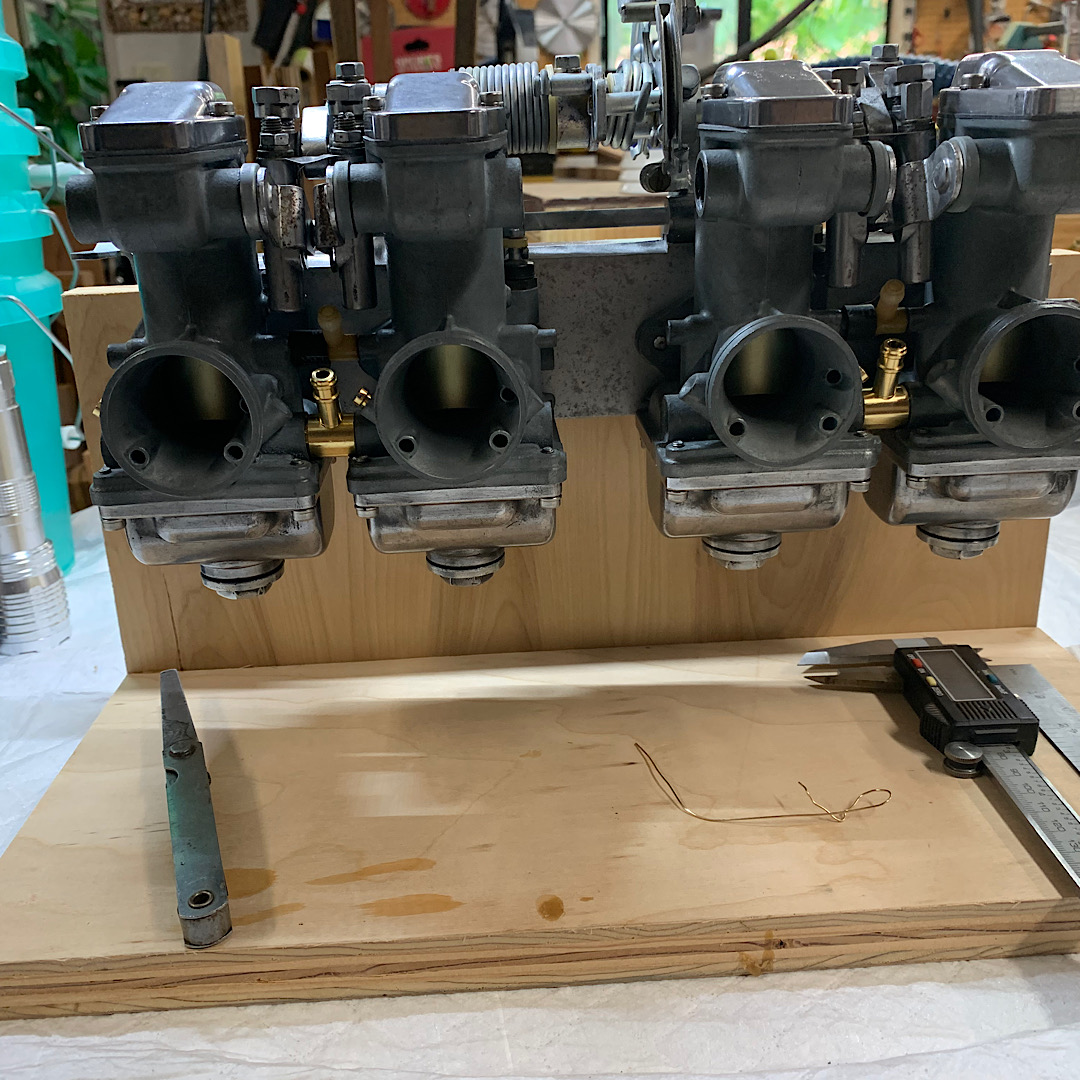

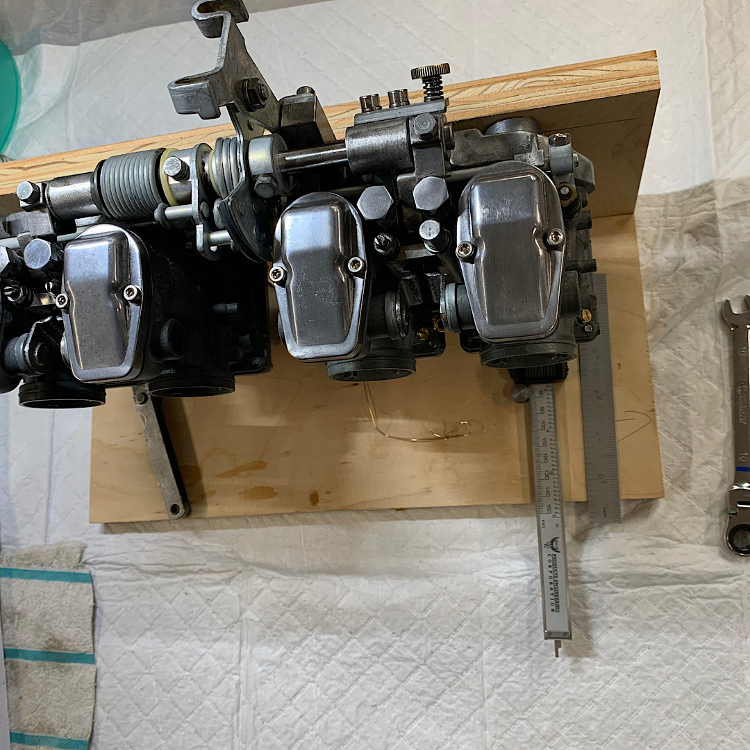

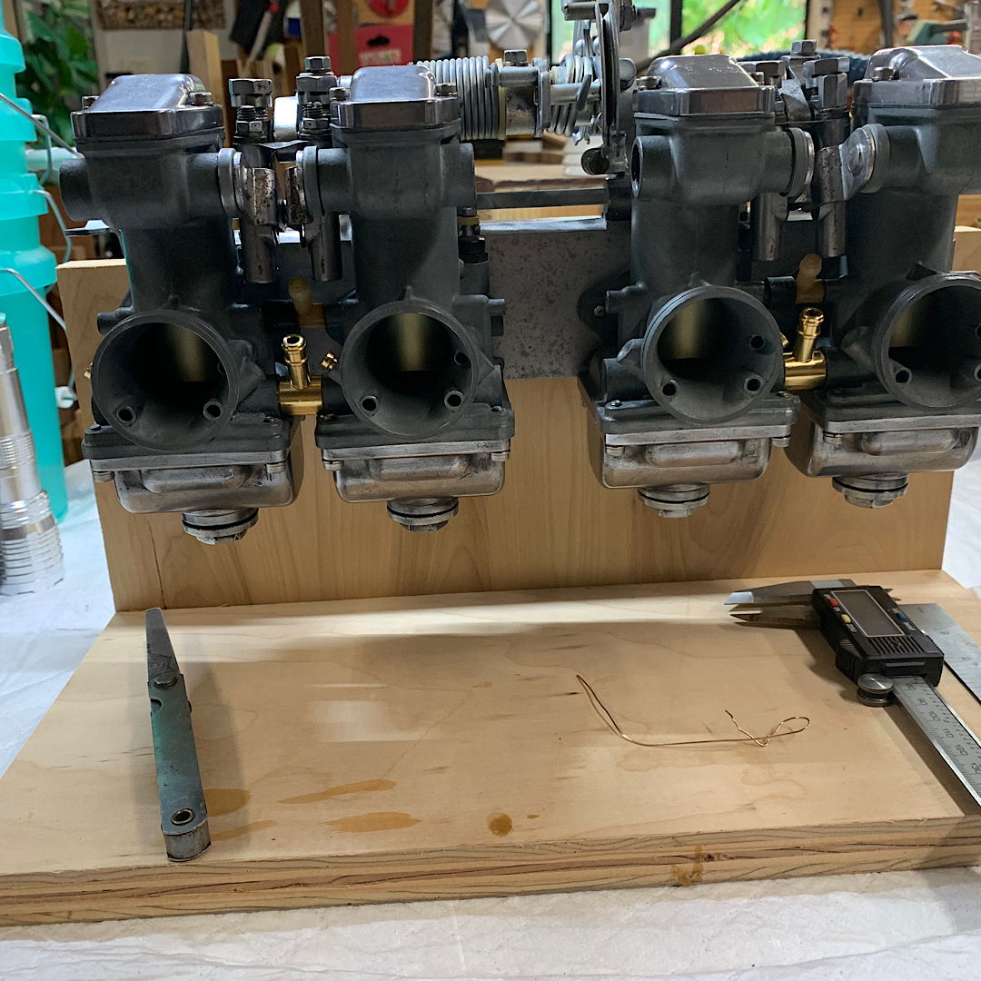

The carbs will come off again after I run it and then take it apart. Right now I am bench synchronizing them and my shop manual is not like my carbs. The initial setting of the slides requires a .6 to .7 mm space between the notch in the bottom of the slide and the throat. It implies I can adjust all 4 carbs this way. I seem to have a set where the number 4 carb is a fixed setting and the others are adjusted (initially) to match. I included a photo or two. You can see that number 4 has no adjustment screw. The gap under the slide is fixed and is about .5mm. I do not have a drill bit that small but I do have my wife’s silver and gold filled wire. I got a piece and carefully flattened it to make a go gauge. All 4 set now, next step is clear tube check for which I made a little stand.

Not sure if it’s correct but the fixed carb is commonly referred to as the lead carb. You could have adjusted the idle speed thumb screw to get the .6-.7mm spacing on the lead, then set the rest to the same. If I understand correctly you made a gauge wire the fit the lead (fixed) car slide, then adjusted the rest to said gauge, you effectively did the same thing. Now if you were to turn idle speed thumb screw to get the .6-.7mm gap the other 3 will match. You have completed the bench sync. Continue
