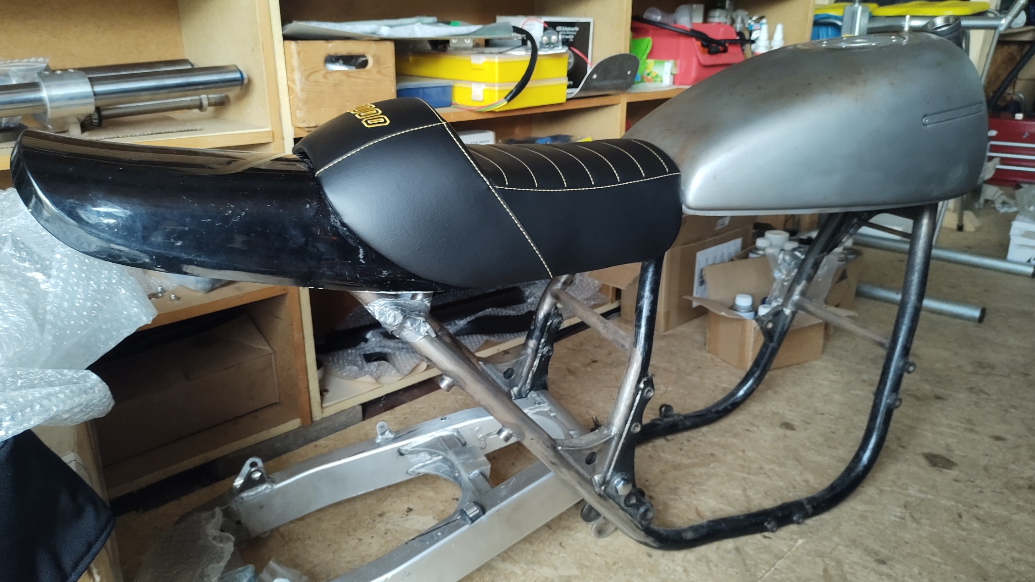

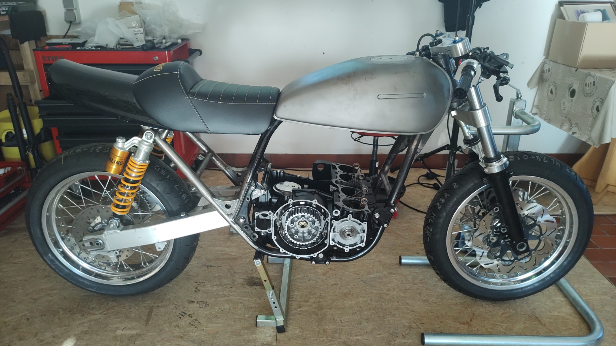

Back home and getting back into things. Got the Zephyr running so back to this project tomorrow. Picked up the bolts for the bottom end so I'll put that together and get it in the frame. Can hopefully get the head and cylinders painted on the weekend otherwise I'll just bolt them on as is so I can get the exhaust bracket done.

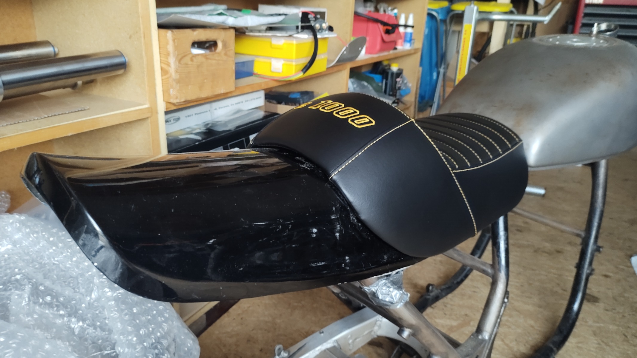

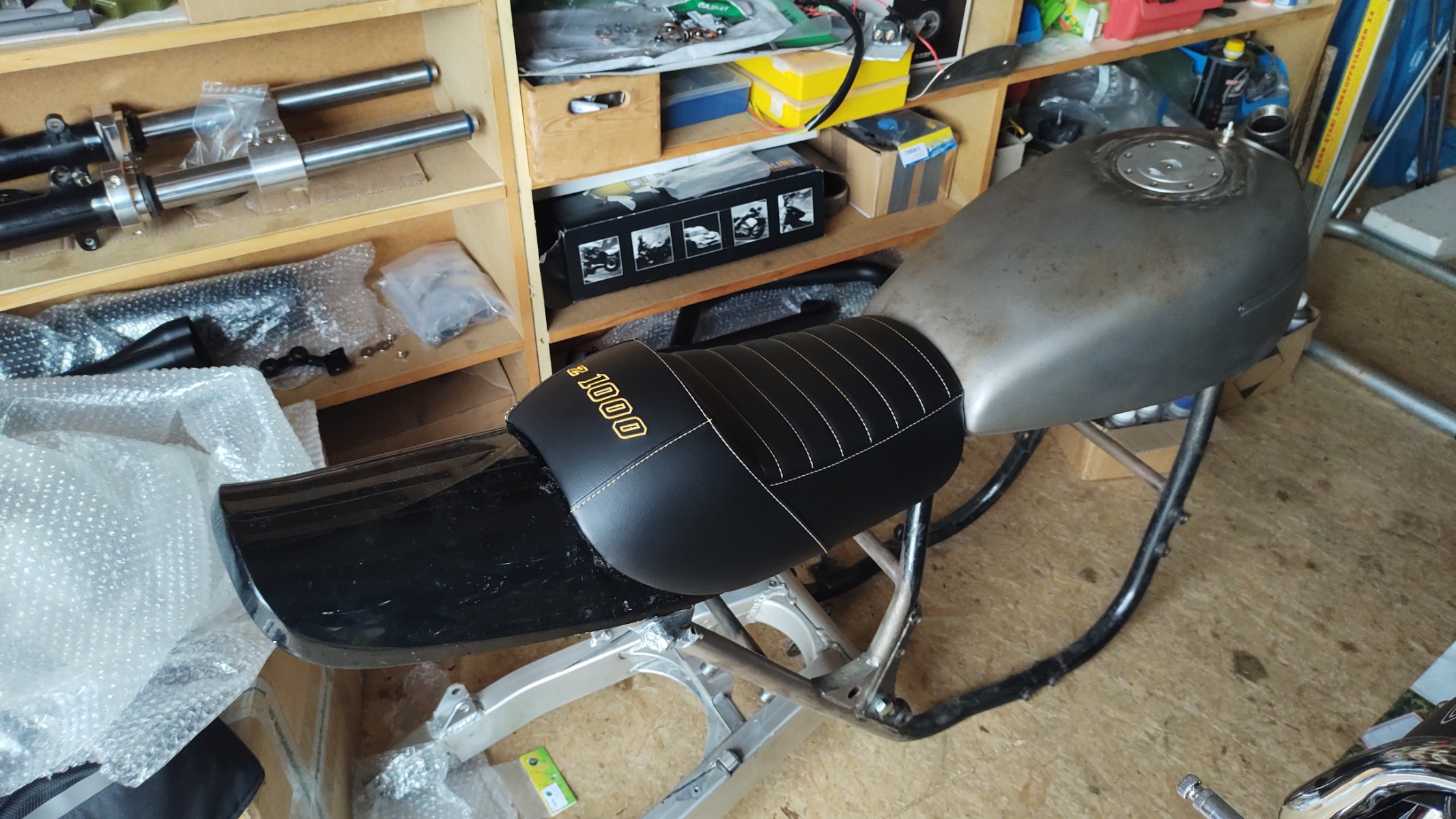

I unpacked the tank today and got the seat off the shelf just to see how it looks. The tail is a lttle bit steeper than I would have liked but I think I can learn to live with it

- Posts: 6211
- Thanks: 3925
Re: 1977 KZ1000 Restomod
31 Aug 2022 12:37
Coming together pal, looks good

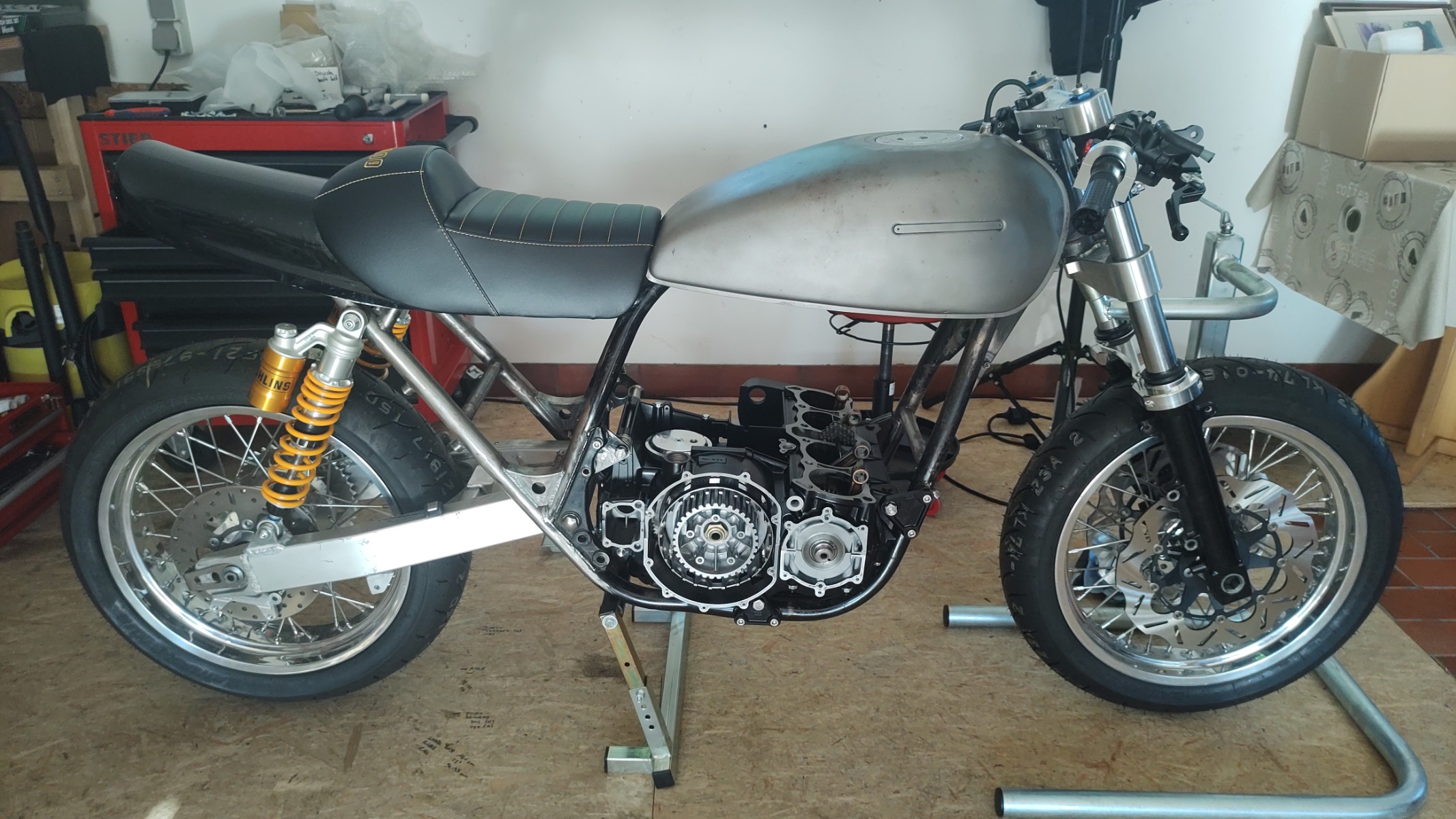

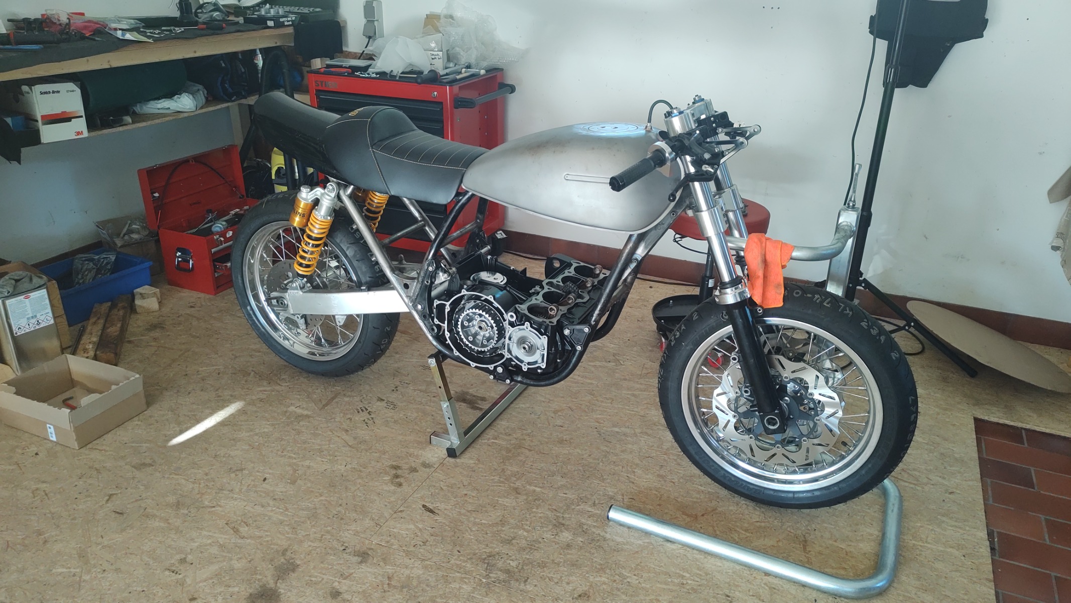

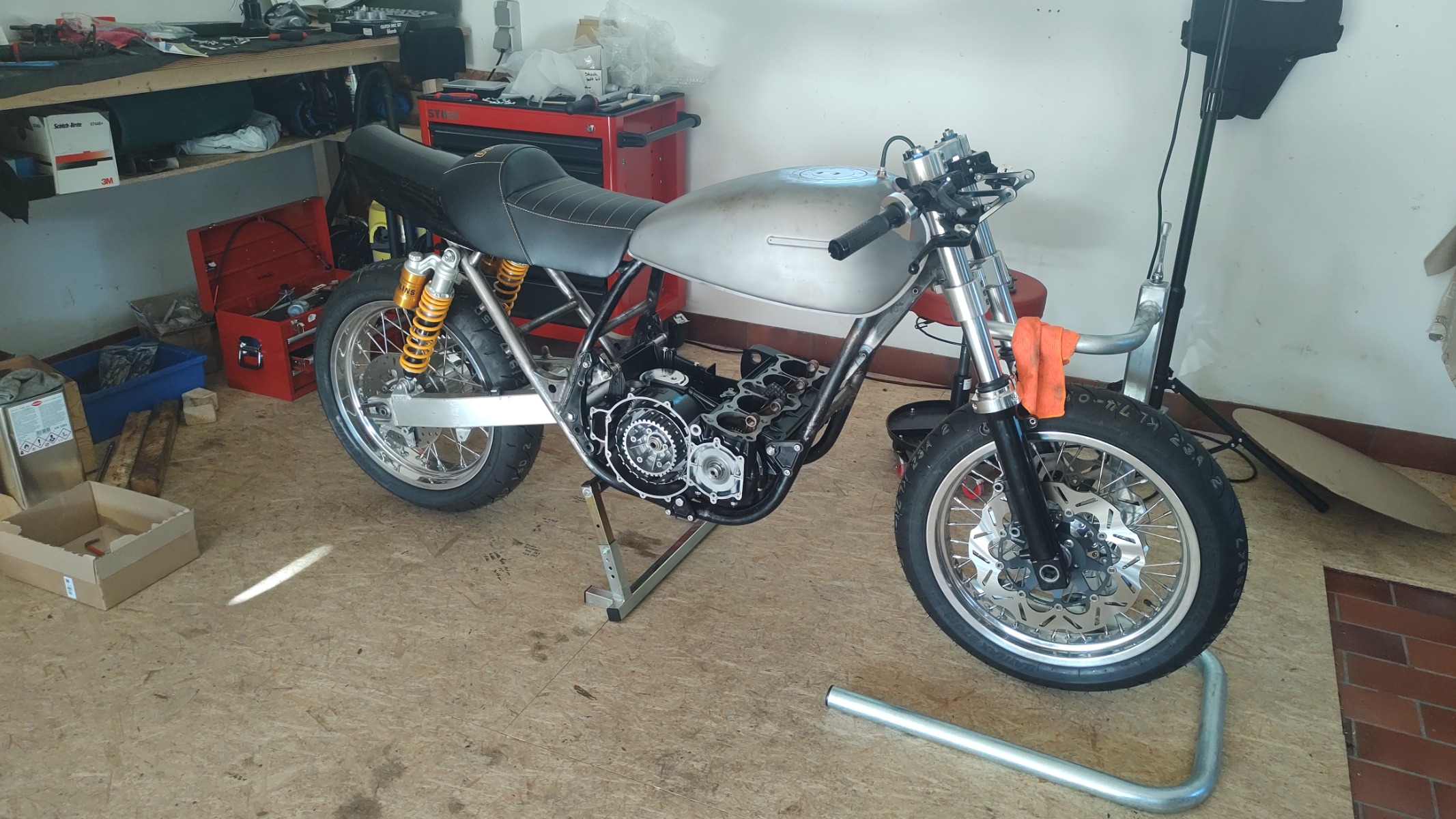

I got the bottom end pretty much together (still a bit to do, but the cases are back together so I could get it in the frame). Will put the cylinders and head on loosely tomorrow so I can see where the exhuast bracket needs to be. Then I'll get to work on the cockpit.
All the engine mounts lined up (with a bit of encouragement) except the right rear upper bracket. It's quite a bit off so I'm wondering if all the 900/1000 brackets are the same or whether I've ended up with the wrong bracket as I don't think the frame is that bad. The bracket on my other build has a hole in the middle and this one doesn't.
