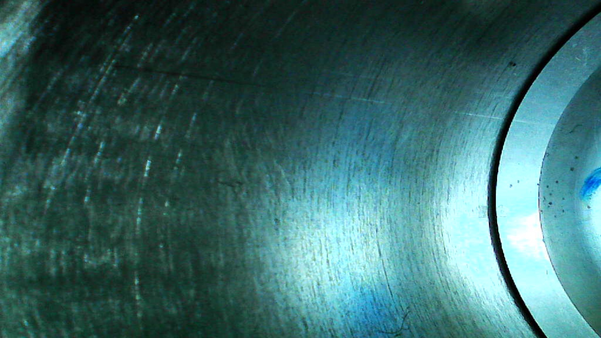

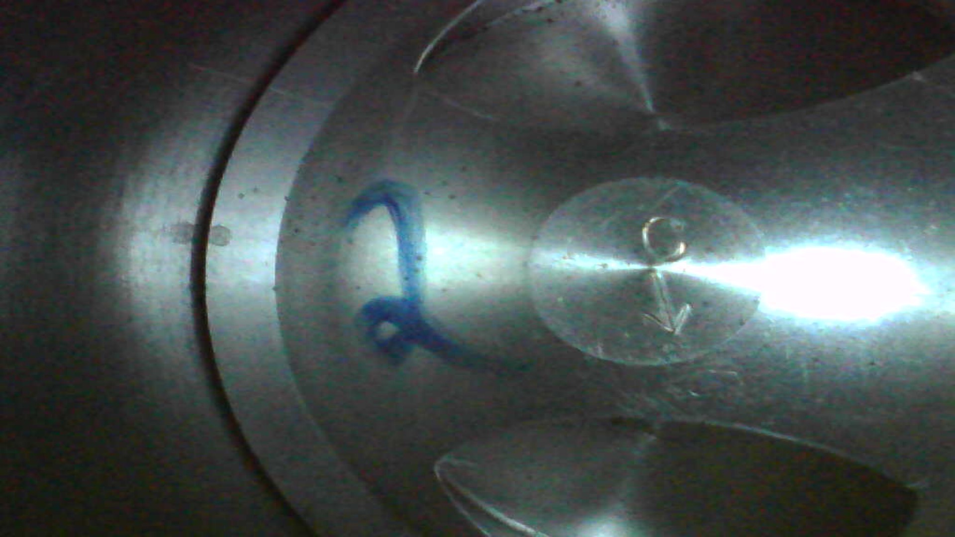

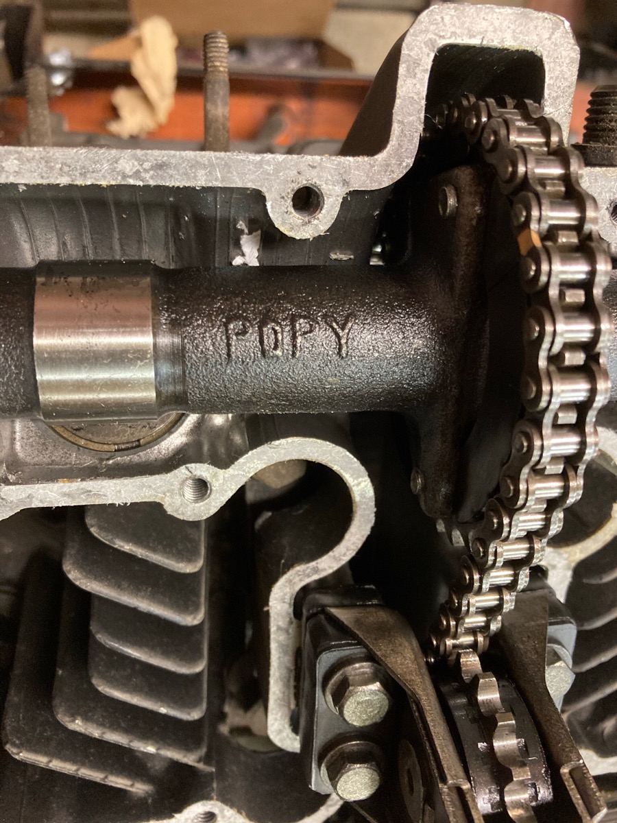

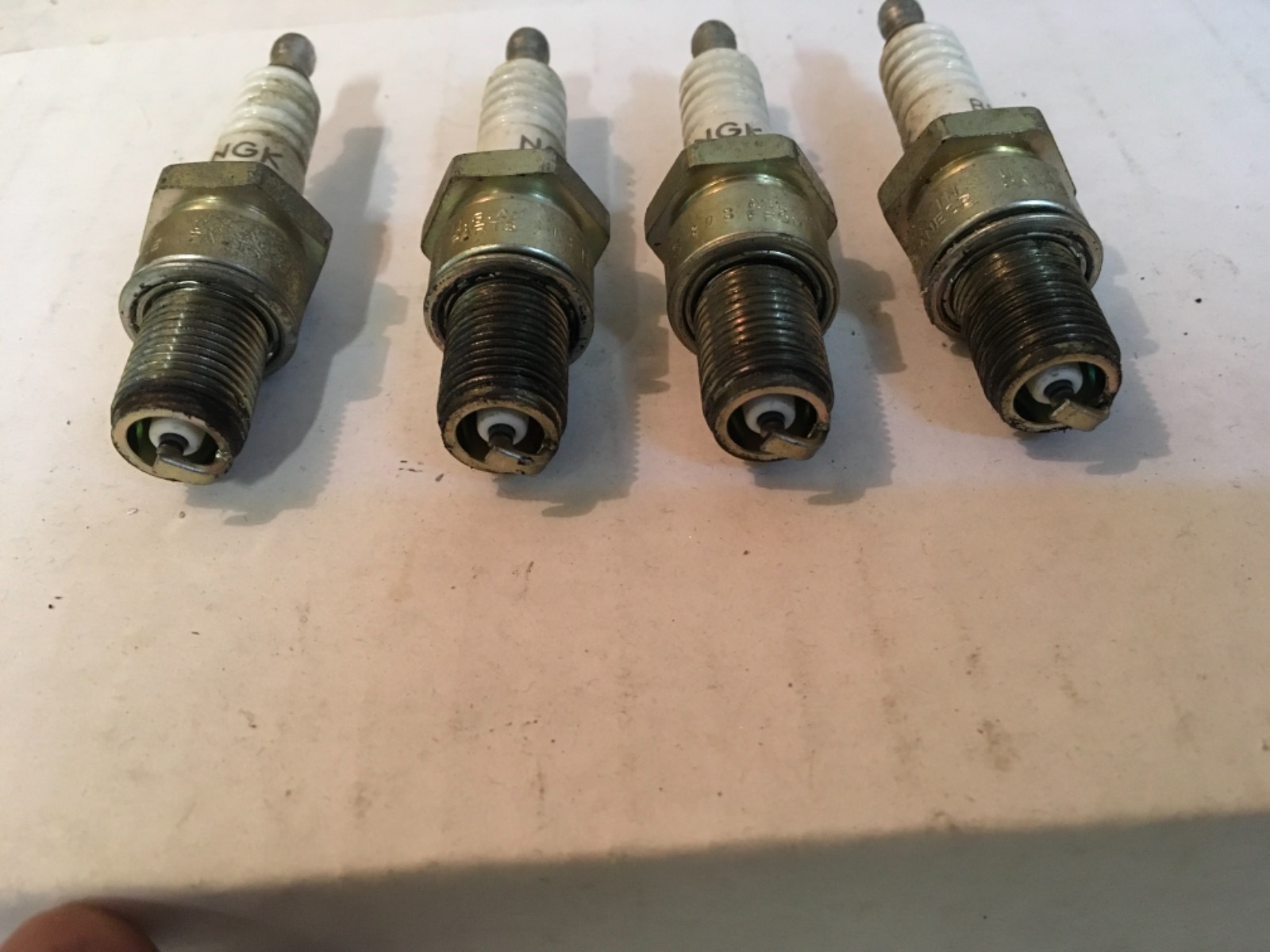

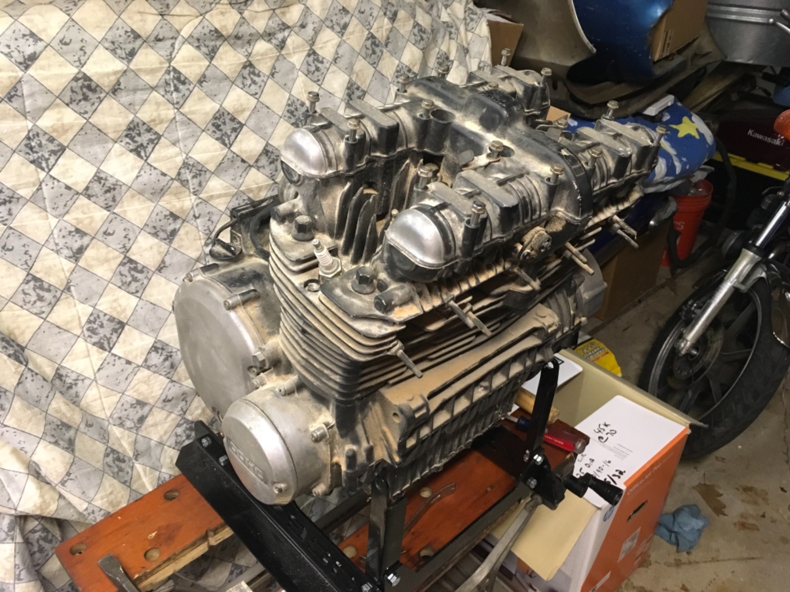

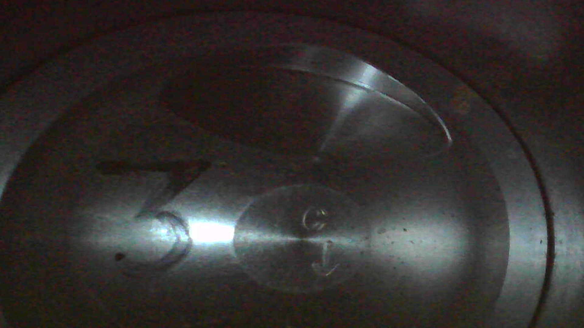

Perusing Facebook marketplace just really paid off KINDA. A 4 hour round trip and $130.00 YES $130.00, just scored me a Z1B 900 engine. Plan was to buy it regardless of condition hoping I’d get at least a good crankshaft out of it. I have to say if this possible I’m disappointed. Turns out the engine is a fresh (unknown years ago) build never fired. Can you be disappointed finding such a deal. Maybe I’m pleasantly disappointed. The goal was to get a crankshaft for this project. So now I wait till the generous member returns home and I can get my crank.
Engine is higher compression pistons. In the photos you can see sharpie numbers 2&3 on the pistons, the fresh cross hatch, ported heads, band new B8eS plugs, and Yoshimura “poppy” cams. I faintly see a B stamped on the cam ends. No clearance ground into either the lifter bucket nor cam cover areas.

It'd probably be a couple hundred in gaskets to put it back together if you take out the crank, but at the same time, it's good to finish a project instead of starting another. I pretty easily get four or five things on my hands if I don't stay on top of things.
Another option might be selling the engine - maybe someone would trade you for a good crank?

Speaking of CC’s is there any way to find out the bore on this new to me engine. I don’t plan to pull it apart. I’m am going to pull the pan to visually inspect the lower half. Can you access the bottom of the block with the pan off?
