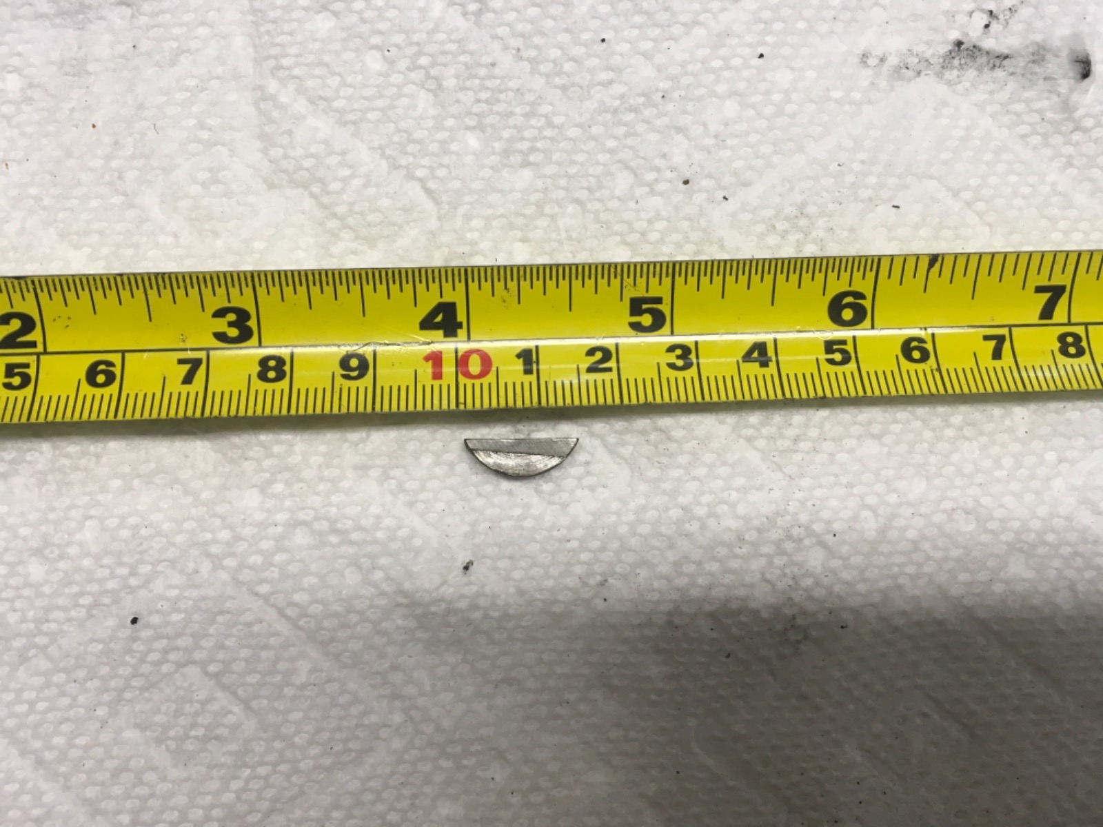

I pulled the rotor off the crank before shipping. I stacked all parts in order on top of the upturned rotor and put a zip tie loosely to hold orientation. Wrapped it in a trash bag and into the tote next to the trans for safe storage. Today I realize I had forgot about the woodruff key. Started looking around the bench area and found this, see picture. Is this the Kz key. I have also recently replace an engine on my neighbors riding tractor and the flywheel has a similar woodruff key and don’t know if I found the Koehler or Kz key. Mine could be still in the crank and I’m not cutting open the package to see. This thing is tiny. About 15mm long.

Looks like it but worn. I made my own from one I got at the hardware store. Been 4 years and still tight as a gnat's ass.
